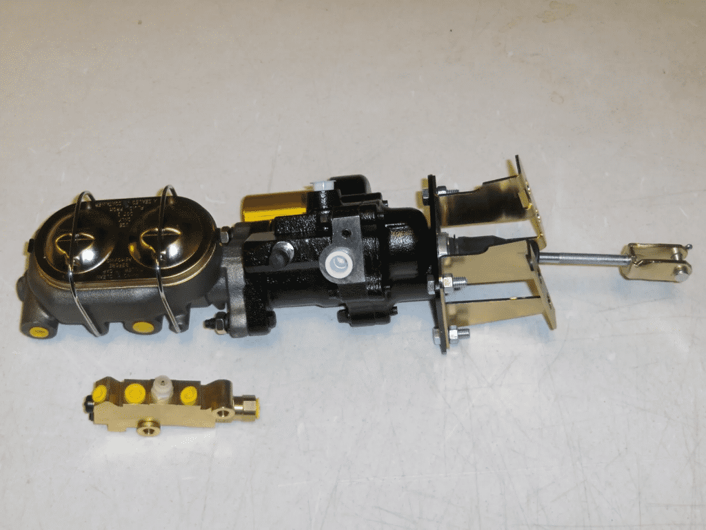

Sorry @Welder guy but I'm too lazy to do an entire thread on it, but the gist of it is I originally converted my front to disc brakes (scarebird kit - and yes, there are some who like it, some who don't...such is life) to go along with the stock 383 and stock power brake booster, which worked perfectly fine. As I mentioned before though, once I dropped in that 505 with no vacuum, I had to find a braking solution. So I started with the Leeds Vacuum Pump and a vaccum cannister, which worked intermittently. I ditched that, and purchased a hydroboost kit from evilbay:

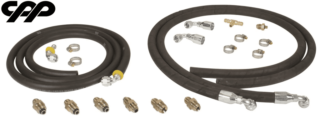

I had to play with the pushrod to get it to mate with my stock power brake pedal, but after a lot of cursing at my stubby sausage fingers, lower back pain, and several whiskeys, I got it in there. I then purchased this kit from CCP:
And the hook up to my TRW stock power steering pump was simple. I also bought a small filter for my power steering pump just in case, but overall this is the best braking I've had since I've owned the car. From stock drum power brakes, to disc/drum power brakes, to vacuum pump with a vacuum cannister, to hydroboost. There is another route that I've heard others discuss by swapping out late 70's Cordoba spindles and parts, but the 63/64 Chryslers were...unique...but hey that's why I love 'em.
