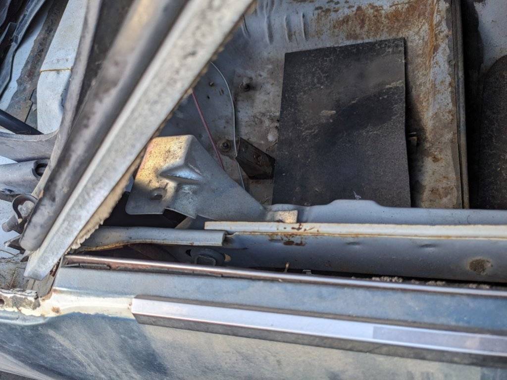

'70 Chrysler 300 convertible, Google picture search has turned up nothing, but I think these might be part of the interior?

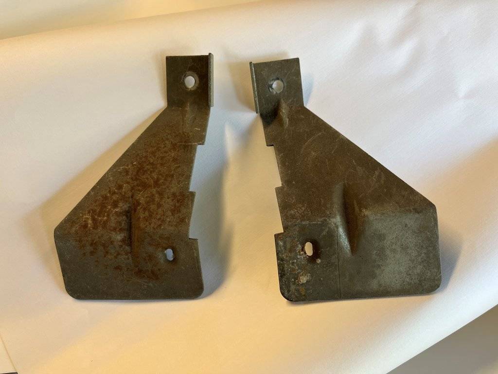

I think it's the bracket that mounts under the rear door panel back by the hole for the top and top frame. Black arrow pointing to the screw.
Wider portion on top.
OK hate to be a nit picker but a convertible as pictured above does not have a rear door.
The panel with the rear armrest and the handle is a rear quarter interior panel.
I see this nomenclature all the time on various sites.... anyway, do not be offended.
That is the support bracket that goes under the rear interior panels for 1969 and 1970 300 convertibles. The snap as shown in post #2 screws down through that bracket. Care should be taken check for enlarged holes in the brackets from oversized screws, a common problem. A simple fix is to hammer bracket hole flat and renforce the area w/ a small amount of brazing rod. I may seem like overkill, it will help w/ helping w/ screw retention and prevent screw pull out.
