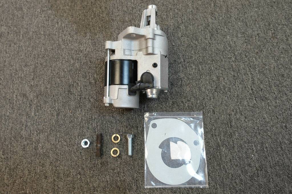

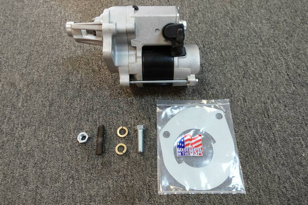

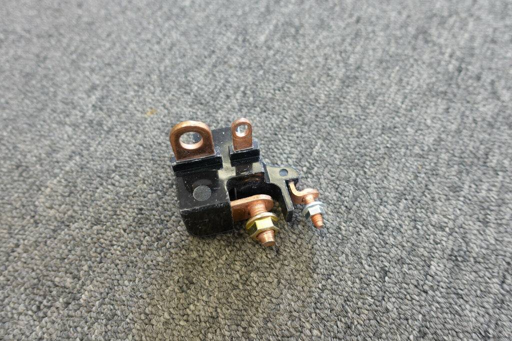

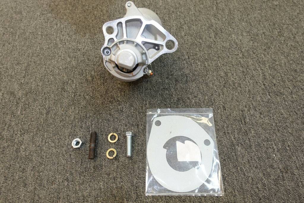

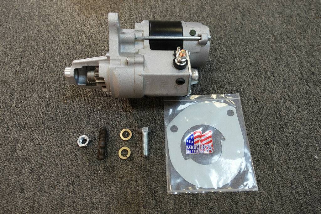

Thank you all for the suggestion. I have purchased the mini-starter (eBay link above) for Medina. Here are pics from the listing for records: the battery cable terminal adapter to which Wyatt and Steve refer is shown in the last photo (it can also be bought separately).

Having just finished installing one of these mini starters on my 71 Newport recently, I appreciate the efforts of this seller to come up with something way better than the as received set up where you need to install the harness terminals on the starter before placing it in position and then hassle getting adequate clearance along with proper routing of the harness wiring away from the exhaust pipe and block and avoiding tight angles.
Thanks for the lead as it looks like a smart solution. Let us know how it goes.
