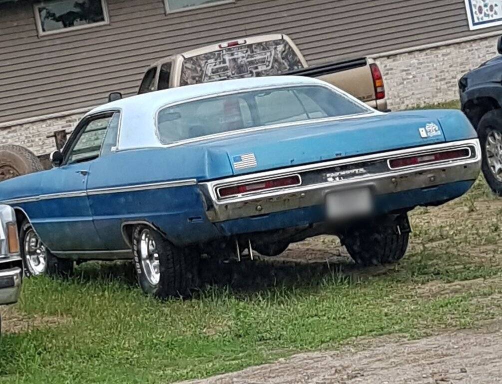

You got 275s mounted under yours? Damn, I'm envious! What kind of rims and backspacing are you running? Post some pics please! That's a lot of traction, add a spool and see your gas mileage dip into the low single digit range as your 383 fights to push it around a corner. Seriously, limited slip please, before you buy some Arabian prince another Bentley or a fleet of Tesla's for some oil executive team. Your wallet and the ecosystem will thank you in the long run. Spend a little extra coin now and save it back in the long run.
