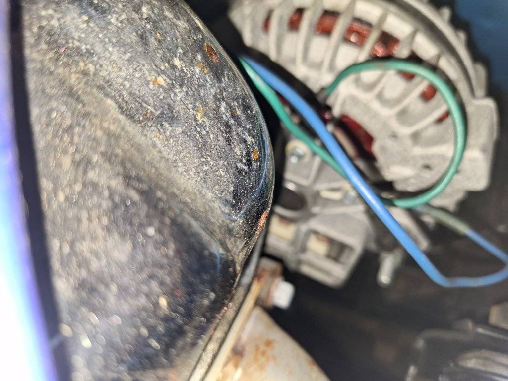

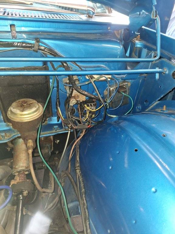

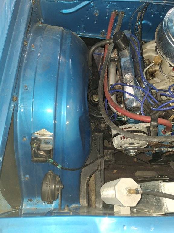

I've attached pics of the bulkhead fitting on the firewall and the associated wiring, along with a pic of my alternator.

dirty connections are not going to cause a voltage spike...thats an alternator/ voltage regulator issue...looks like you have a later model squareback alternator in there and assume the later electronic regulator that goes with it?(never mind see it in the pics) maybe you got the wires crossed up? i'd temporarily run 2 new wires from the field terminals to the regulator, try another regulator etc...you dont still have one of the field terminals on the squareback grounded do you?...thats how the squareback would have to be hooked up with the original points style regulator

The wires are connected to the bus bar in the engine compartment with screws, which were loose.
Dirty connections might not cause a voltage spike, but loose ones can, causing the regulator to see spikes in system voltage, and telling the alternator to supply max voltage in response.

How was the driverside motormount done? Looks like the bracket that is bolted into holes that were drilled/tapped into the oil pump? IIRC that's a Schumacher item? How easy was that to install?

3. Your beautiful work on the bulkhead connector duly appreciated, I would advise you to re-route the power lead from the starter relay through a grommeted hole in the firewall, avoiding the bulkhead connector. Cop cars were wired thus, to avoid trouble. You can put the fusible link at the battery, or the starter relay, using ring terminals.
4. All your lovely PAINT may be blocking good ground current to that solid state voltage regulator. Use a star washer behind the regulator and in front, after you abrade all that lovely paint and primer around the mounting studs down to shiny, conductive steel. Run a grounding bond jumper from the battery to one of the studs, using ring terminals and make sure this bond is included. Vibration can make for intermittent grounding of that voltage regulator, resulting in it pulsing the alternator field.
