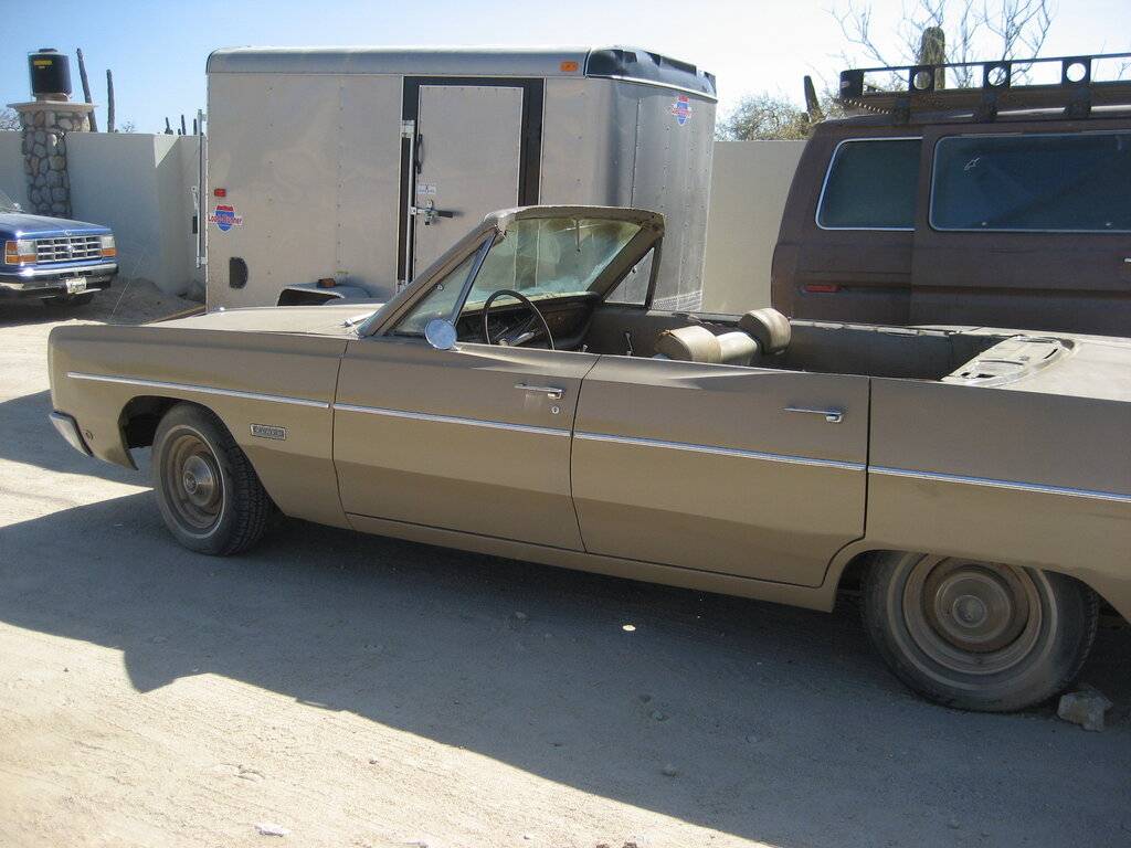

Door gaps are not even. Your Dad was right.
It’s just not folding in the direction you probably imagined.
Don’t get me wrong, I love this car.
Too, Dad is right about a lot of things but man you have a better eye than me- in that photo I posted I'd say the door gaps are looking pretty good...
