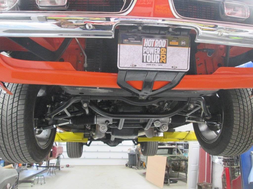

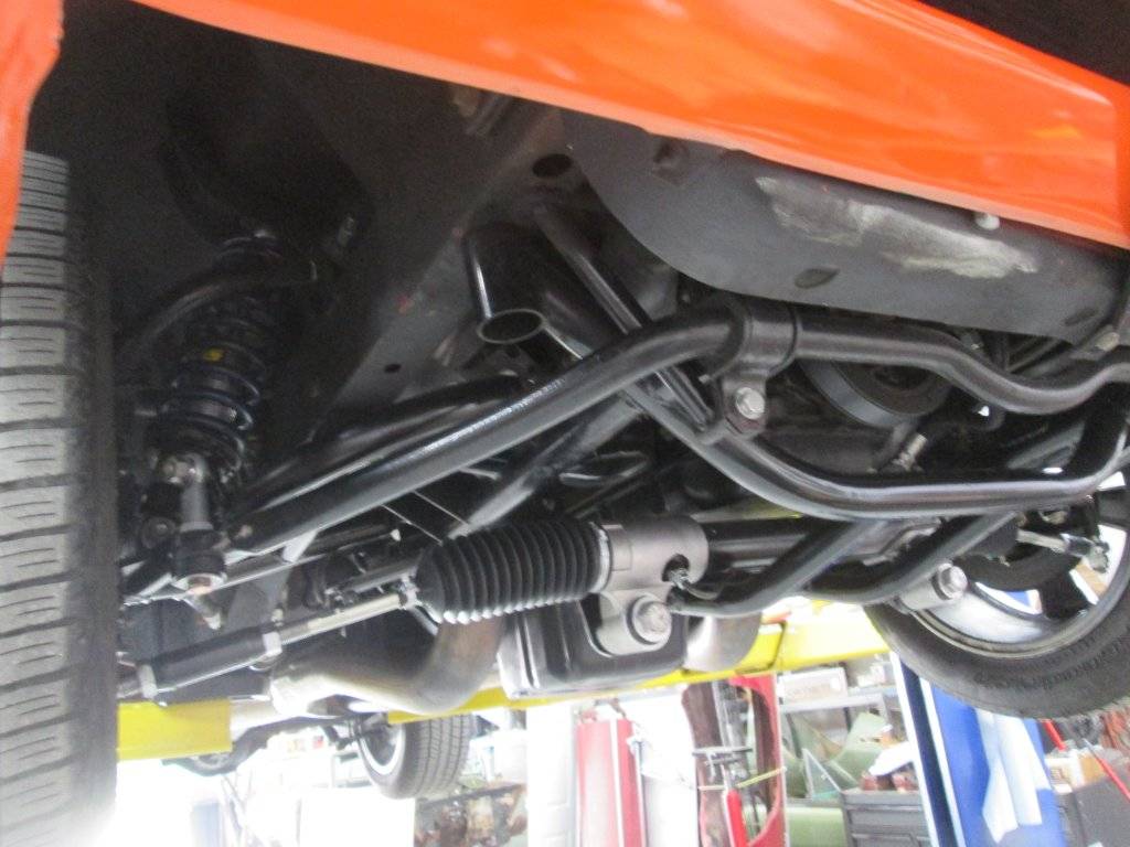

Loosing the torsion bars and replacing the shocks with coil overs?
Good stuff. Thank you guys for the opinions. One thing that I did not consider is power rack and pinion steering. I will have a look at that this weekend and give you guys my opinion on doing that. That would be cool.

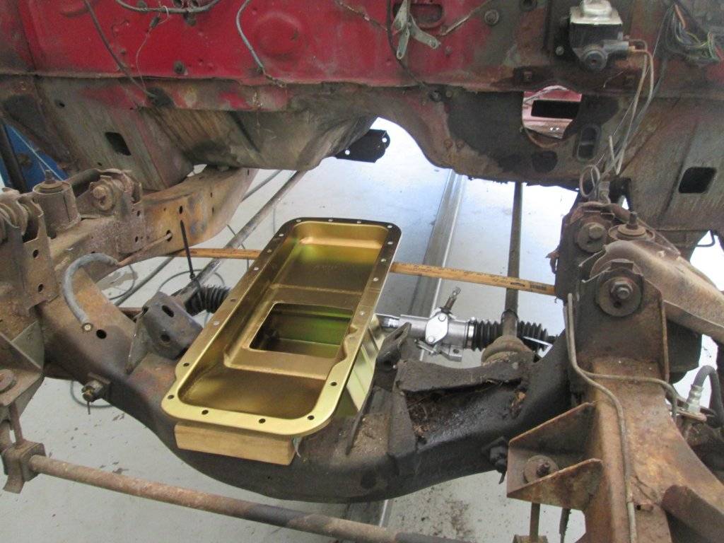

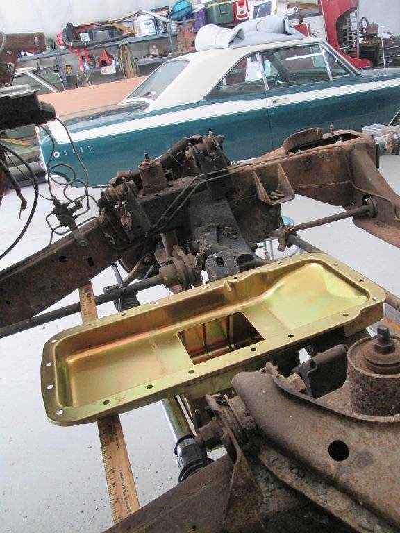

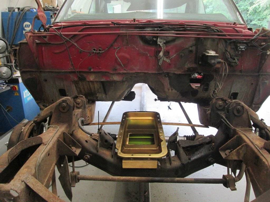

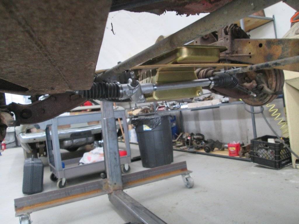

Okay, I did not sleep a wink last night thinking about the power rack and pinion on the Fury. So, first thing this morning I went down to the shop and removed the drag link and power steering gear box off the Fury. I have an old manual rack and pinion that I had used on the Cuda in years past before going to the power unit. So, I dug it out and mocked it up. I think this is a winner idea. The power unit is a tad bigger than the manual unit, but is much easier to fab mounts for. You can keep the torsion bars for those who want to, but getting rid of that huge steering box has to be a win - win.
Your thoughts please.

There's a company called QA-1 that make a pre-fabricated front suspension for A, B & E-bodies that are tubular and use coil overs. Maybe give them a call?

This can be a good upgrade! If it is a non-power unit, you might also consider an under-dash addition of electric power steering, IF there is enough space for such under there. Might not affect bump steer that much, BUT the stiffer components have to account for greater steering accuracy, I suspect. Not sure if the charging system might need some upgrades for that?

Gonna be really extreme shaft angles to get from the steering column to a rear-steer rack.
Going to eat up that header clearance you're after.
That will likely be an issue with any rear-steer R&P setup?
And - steering 'gearboxes' have a designed weight capacity, and that data likely won't be readily findable.
Best to find an R&P from a front-heavy car.
Thanks for the feedback. I am just brainstorming on this car at the moment and wanted to reach out to all of for your opinion. The weight of the car and the rack and pinion chosen is a good point and well taken. I am going to pitch out a few more of my ideas for this car to you guys for your thoughts. Here is the first one. Now that we have discussed the front steering, suspension ideas, what about the rear suspension? The car came with an 8 3/4 rear with 323 gears. Not positive traction. I have a center that is if I choose to use this rear end. But, what about grafting a late model Challenger independent rear suspension to this car. I just happen to have one from a 2016 Challenger. Rough measurements are very close and workable for sure. Your thoughts please?

If you can find a rear-steer R&P that mounts with a minimum of fab work (meaning only some mtg brackets and no oilpan mods) I will proclaim you a Hero of FCBO.

Thanks for the info. I was just wondering if that car had been finished and how the rear end worked out. I have no interest in purchasing that car, LOL. My plate is full. I am going to look into that myself as I have both, A Fury and a Challenger rear end. As far as the R&P goes, I have some pretty good resources being here in NASCAR country, so I will see what I can turn up. But, I definitely think that it is doable with minimal fab work.
I am going to pursue the rack and pinion idea. Now I have another question for you guys concerning the Fury. All of the trim is on the car, but some of it is pitted especially the pot metal parts like the trim around the tail lights and places like that. In leu of re-chroming, has anyone tried to chrome powder coat these parts? I would think that could be done and clear added over it and that would make a decent looking part for way less money and time. Your thoughts please.
