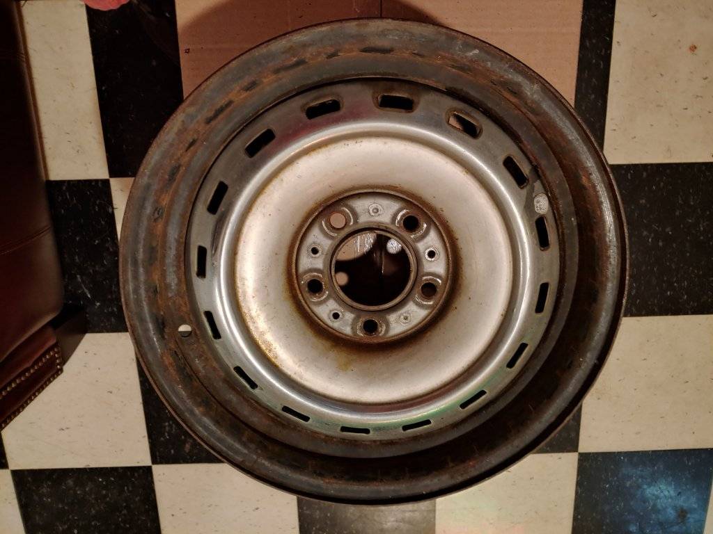

Need to clean them up some more. Unfortunately only 1 good center cap and 4-5 rings. Rims are nice though.
"Hoarder", as some of my Mopar associates might say. LOL
The challenge with these wheels is removing the rust from the rim whilst not damaging the chrome center section....
On mine, I think I am thinking about making a special container for soaking them in Evapo-rust, with wheels oriented vertically, so that the chemical only covers the rim. If the Chrome comes into contact with the chemical, it will fall out into solution and eventually deposit copper onto the bare steel areas (from experience). This despite Evapo-rust not being an acid...

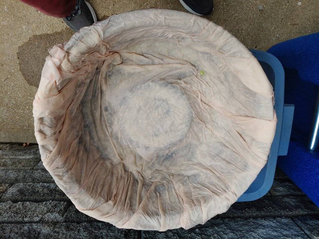

I used cleaning vinegar to remove the rust from the road wheels i am putting on my wagon. I soaked absorbable puppy pads then wrapped the wheel with them and let them sit for about a week then was able to use a wire brush green scotch pads to remove all the residue.

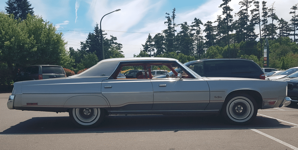

I believe they are the later style 74-78 as the wheels came from a 77 New Yorker. The center cap part # is 3699011

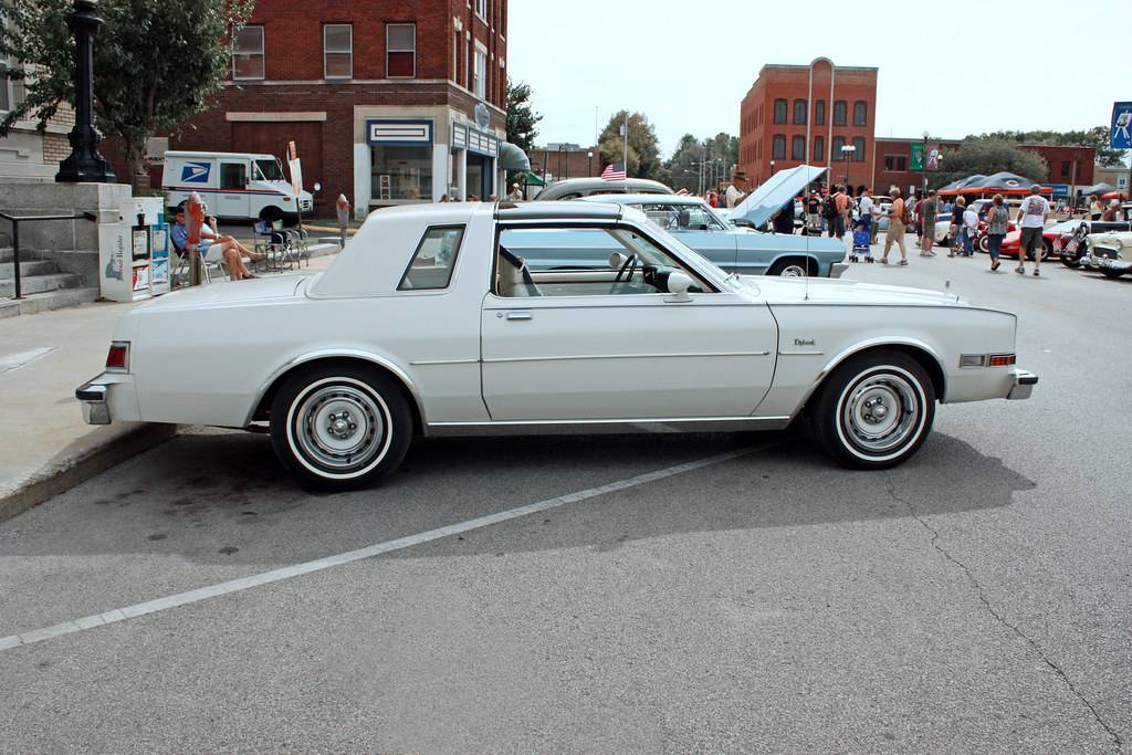

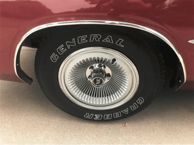

78 NYB Salons had as standard had black painted 15x7 road wheels under the "aluminum fascia basket" and trim rings.
these wheels were also available as an option on 78 Dodge Magnum XEs, Monacos and Plymouth Furys but not available on other Chryslers

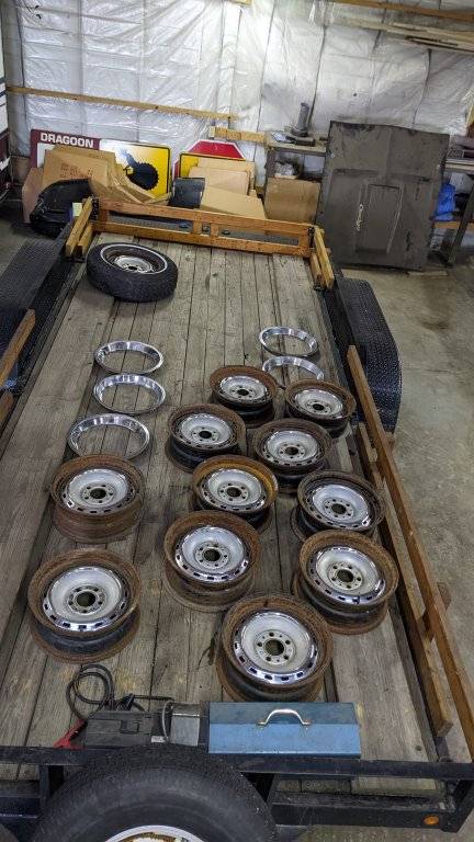

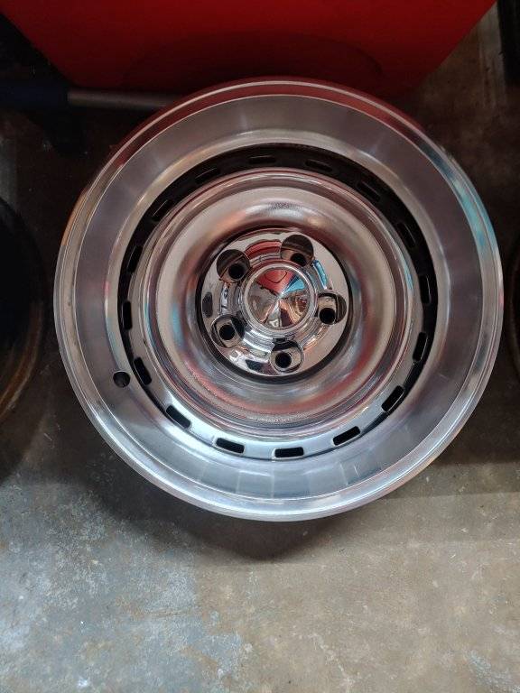

There are a few ok center bodies, only 2 of the splined top cap.
I may sell singles to those who have asked, but it's an even 12 right now.
I'm planning on light restoring the best 4 for resale as a set. Probably sell some others undone for those who like to restore themselves.
What's the right gray/argent paint for the center?

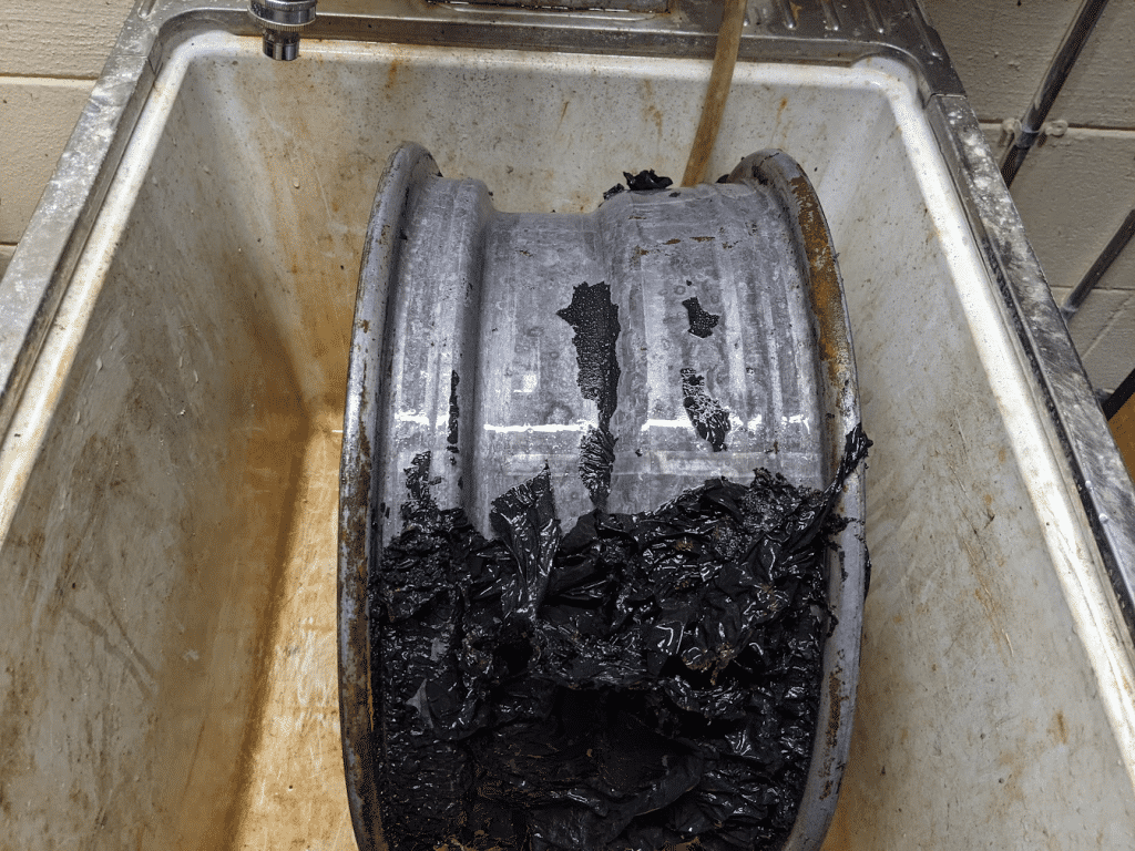

I've had good luck soaking wheels in vinegar, I used a cut-down plastic barrel (got from work) and then a 1500w $40 heater from Amazon.
Depending on barrel height you can do multiple wheels at once.
Heat really accelerates vinegar's work. I let them soak for 1-2 days, keeping the heater on only in the evenings when I was home.
It did not seem to affect the chrome, but it did weaken the existing silver paint.
And totally removes other paint.
