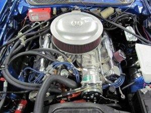

I built this 440 earlier this year for a friend... About 500 HP, should run in the high 12s with the 3.55s and soft compound tires.
Diamond pistons with .012" deck clearance/ .051" quench, 10.5 - 1 with aluminum heads.
Edelbrock RPM intake
800 AVS
Steel 3.75" crank, stock rods, balanced
Comp Cams Xtreme energy 230/236 duration @.050", .488"/.491" (.521"/.524") lift with 1.6 ratio Hughes roller rockers.
Hedman ceramic headers with full 3" exhaust.
The aggressive ramps on these cams do make a good share of valve train noise, but they do have good low end, and a broad power range. I think I would prefer less valve train noise, have more lope and sacrifice a little low end torque.

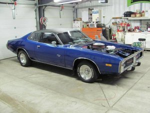

Nice. Do you have enough clearance to close the hood?
Actually... no he didn't... with the stock flat hood.
The same intake cleared under the '67 New Yorker and also a '72 Road Runner that I sold several years back, but the Charger has a lower hood and fenders.
That's a great looking Charger except for the rims. I was young when that style hit the streets and I didn't like them then! No offense, just my opinion.
Pretty much the same setup on my 78 NY'er and had plenty of hood clearance.
It sure would be nice to move the A/C compressor out of sight. Does somebody make a kit for that?
I can't be offended, it's not my car...
These wheels have been on this car almost as long as I have known the owner... Early 90's.
I recall a kit that mounts the compressor at the bottom, out of sight. Not sure if for BB or SB. I think it was from Bouchillon (check spelling). I recall they also sell power steering pump brackets, so maybe search for that too. It is probably just for an after-market Sanden compressor which most hot rodders use.
