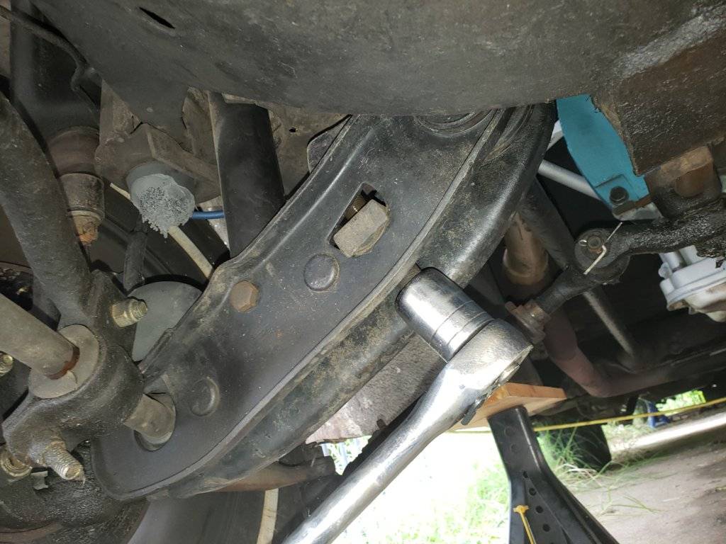

i was setting my torsion bars back and looked up into the chassis and this . ..
it is a bumper / bump stop and it fell off like it has leprosy. the other side is split also, but hanging on by a tendon. @p-s-t
looking at my notes, I bought it in 02/14.
I remember looking at the new piece, looking at mine, and setting the new piece back on the bench. Everything else is doing it's job still, and I installed around the same timeframe.
That's a poorly made part, look at all the air bubbles in that rubber, no wonder it fell apart. Those guys suck if you sent them a picture and they chose not to warranty them.
