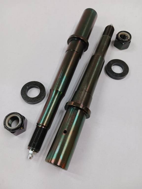

The LCA pin is fixed into the subframe and tightened down - it does not pivot. Smear some type of lube for future disassembly purposes and rust prevention.

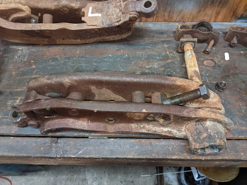

The LCA bushing is vulcanized to the inner and outer shells, which is then pressed into the LCA.
As the LCA is ~16" long (or whatever) the amount of suspension travel at the wheel requires only a few degrees of rotation at the bushing. So the outer bushing shell rotates with the LCA, the inner shell is stationary with the pivot pin, and the bushing gets squirmed to make it all happen. The overall design is such that the holding force of the rubber to the shells is sufficient that the rubber gets pulled but does not slip. OR it is all such a press-fit of rubber in the shells, with further pressfit when installed in the LCA, there there is no vulcanization, and the friction of the rubber on the shells performs the function.
So it would seem that a poly bushing is a totally different mechanism. From all the notes I saw years ago, the bushings stated that inner and outer shells needed to be re-used. So I suspect the bushing now functions as a bearing surface, and there is slip between bushings and shells. Certainly DIY people would not be able to assemble these bushings with the consistent pressfit (across all hobbyists) that OEM factory machinery would do in a production run, but slip-fit would certainly be a practical approach for DIY. And as it still has few degrees of rotation, the required lube is more for squeak prevention.
