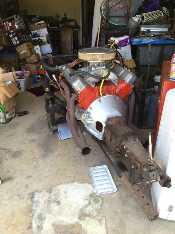

i am going to put a 68 440 into my 62 dodge 880 and want to use a later model trans but still be push button
I have the original motor and trans

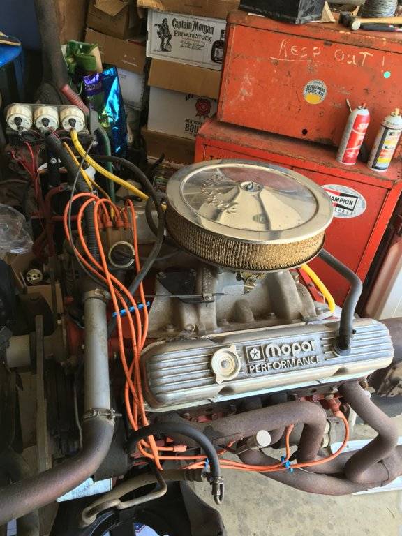

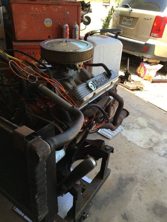

Here's the motor
That 4 sod sold with a challenger I had
Purchased it for motor sold everything else
Have to run auto due to foot amputation coule yrs back or I would have gone that route for sure

I do no know of any good way to convert a solid linkage transmission to push button to run in your '62. What you would probably want to do then is to find an aluminum push button Transmission out of a '63-65 Mopar RB block car and have it rebuilt with the late style torque convertor and front pump assembly. If your are going to upgrade the camshaft to be compatible with your dual quad set up, then a higher stall speed convertor and valve body upgrade is also in the picture, as are race ready clutch packs. You did not mention if the '62 transmission was for an RB series engine.
