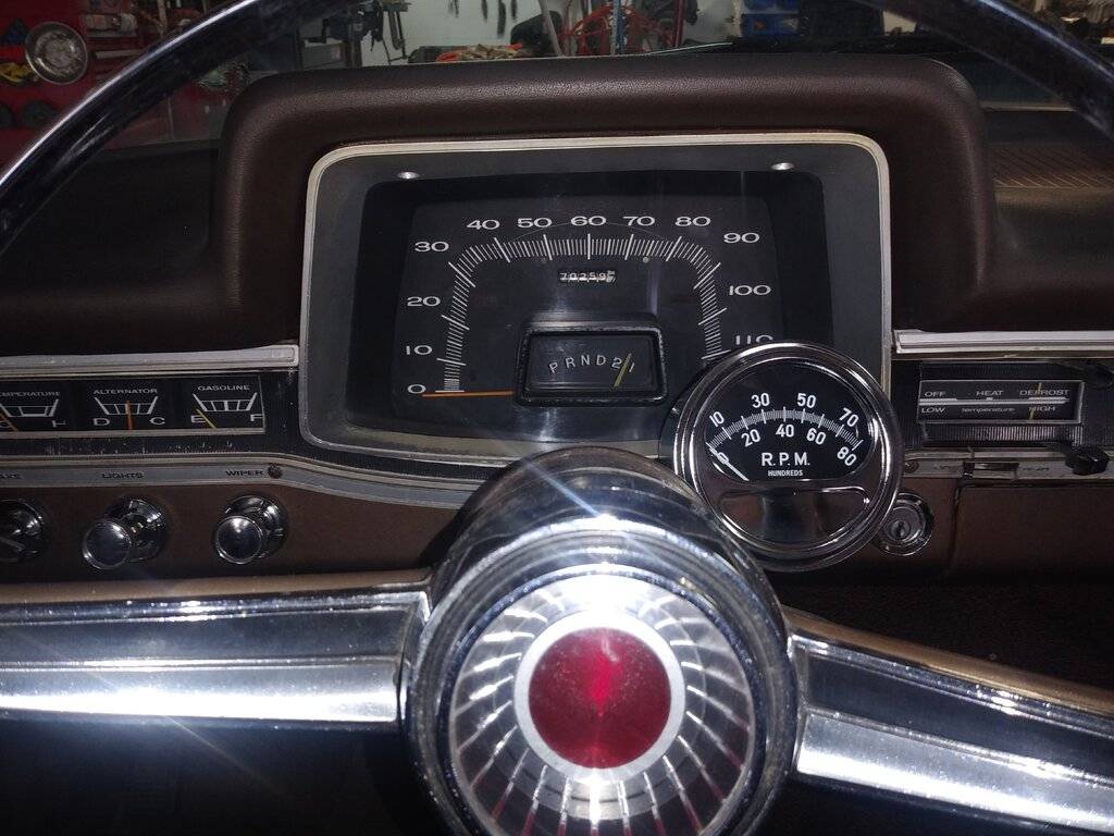

Here's how I spent my afternoon. I couldn't be happier with how it looks. It's one of the Bosch retro tachometers. I'm surprised of it's overall quality. I guess time will tell how well this unit stands up.

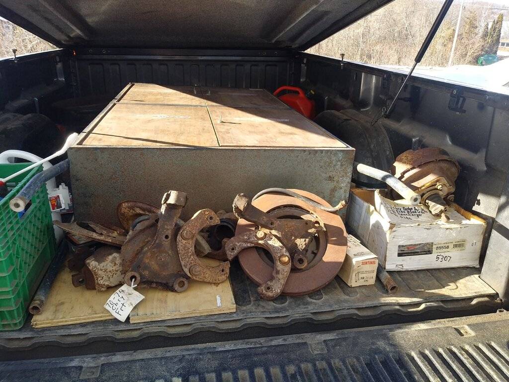

So a while back I picked up a bunch of disc brake components for a good price. I got pretty much everything needed, minus the proper booster.
I was able to snag spindles, calipers, brackets, 2 brand new rotors, 2 sets of new NOS pads (which I won't be using unfortunately due to them containing asbestos) and I took a chance on a power booster that was there as well.

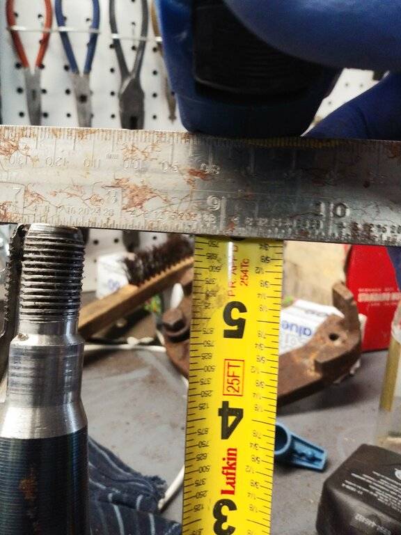

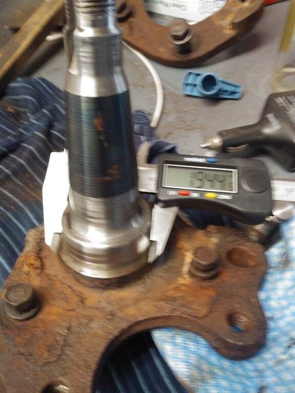

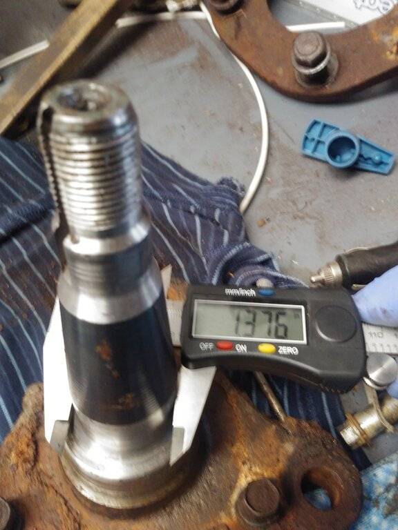

As it turns out, I got skunked on the booster (drum booster), but it looks like I may have lucked out on the spindles.
It appears as though I may have scored 73 spindles. Measurements seem to line up with data found on this forum, although I couldn't find '69-'72 spindle dimensions. Thoughts?
