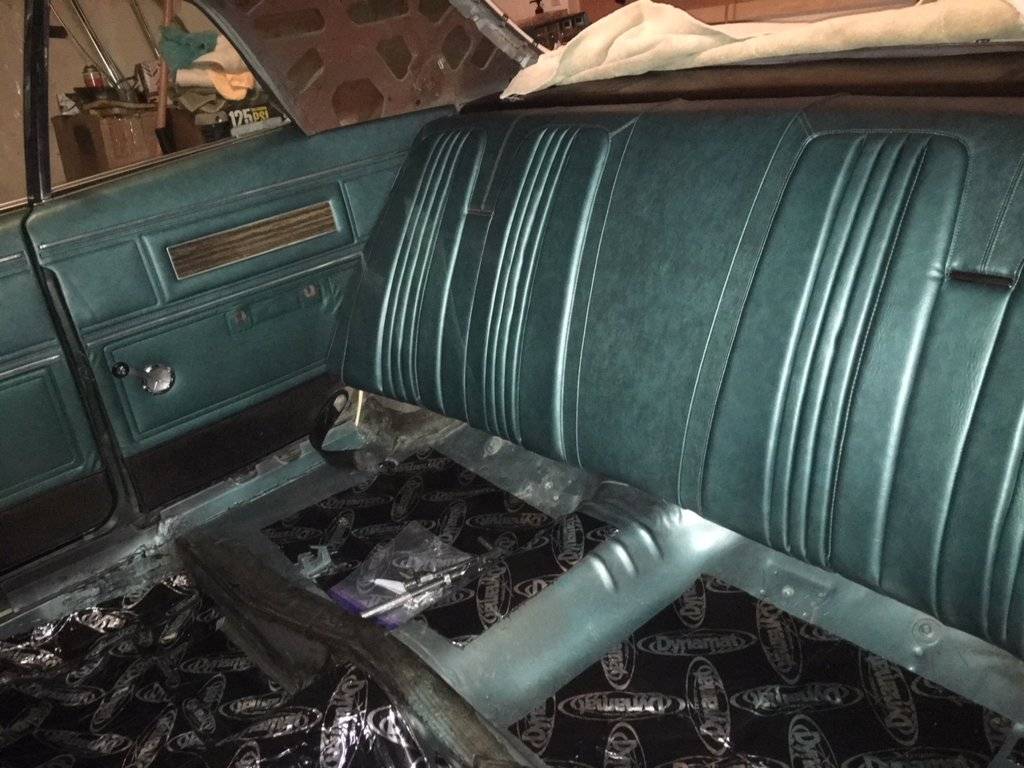

On the upside, my seats are finished and turned out fantastic. $7000 job. Luckily Chris at VIP European Auto Interiors in Tempe, AZ stuck to his initial quote/word and "only" charged me $3K. Each one of those "pleats" is an individual piece of foam and then stitched. The pleated parts are done separately as inserts and then sewn into the exterior sections of vinyl. Just like the factory.
Your upholstery shop did a really nice job on the seats. Did you have to get the vinyl from SMS? You have a pretty uncommon interior color, which is great for the "cool" factor, but makes things more challenging for restoration.

Hey Jeff. Yes, I sourced original material (1 roll) and remade material for the other style from SMS. If you see my pic, despite it being the same color, there are 2 vinyl patterns.
I also got my headliner in OEM style material and my vinyl top pre-made from SMS as well. Everything is perfect.

I can't tell. They look perfect to me in the picture.
