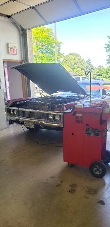

Now the only thing left to do for the car to be fully Ready for long distance trips is the A/C — the specialist who was going to put the R12 found that the compressor has a leak, and he guesses that it’s probably due to worn bearings. That’ll be fixed in time for the 4th Midwest show in August

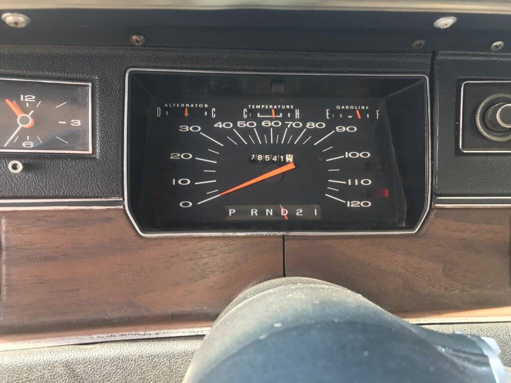

There is one more thing they puzzled me. At higher highway speeds (keeping up with on the outside lane in Illinois), the engine runs warmer than I remember from last fall. Not too hot, but substantially warmer (see the photo below). The only change to the cooling system since then since then has been the replacement of the fan clutch by a Hayden 2747. It might be time to have the radiator cleaned? Thoughts? If relevant, the outside temperature was about 88F.

Did you keep the original 180F temperature thermostat and not a 195F one?
Same highway speeds or faster? Has the timing changed ?
Is the coolant where it is supposed to be? ( obvious questions but need to be asked)
Was that one of the cars that got a high efficiency core for the radiator?
I agree with you, first a though cleaning and recheck.
Have Wyatt confirm the radiator fan clutch is the heavy duty version. With having the a/c option I would just replace the radiator w/ the HD version for optimum performance under all conditions
fan isn't relevant at highway speeds. air moving through the radiator at speed is far greater than the fan could ever move. alt/wp belt broke in my non a/c '69. air moving through the radiator at speed cooled the system and turned the mechanical fan/water pump enough to circulate to the coolant. made it home fine.

for clarification, the radiator and wall in my '69 are from an a/c car. it did run hot when first installed. i had it rodded professionally as @saforwardlook described and it made a huge difference.Since your radiator is the original one, there well could be sediment that has lodged in the bottom of it and it would need to be rodded out by a radiator shop (with the top and bottom tanks removed, they would put a slim rod down each tube to get the crud out - there really is no other way to get it clean without doing that step (flushing will not do it, nor will non-destructive cleaner solutions).
