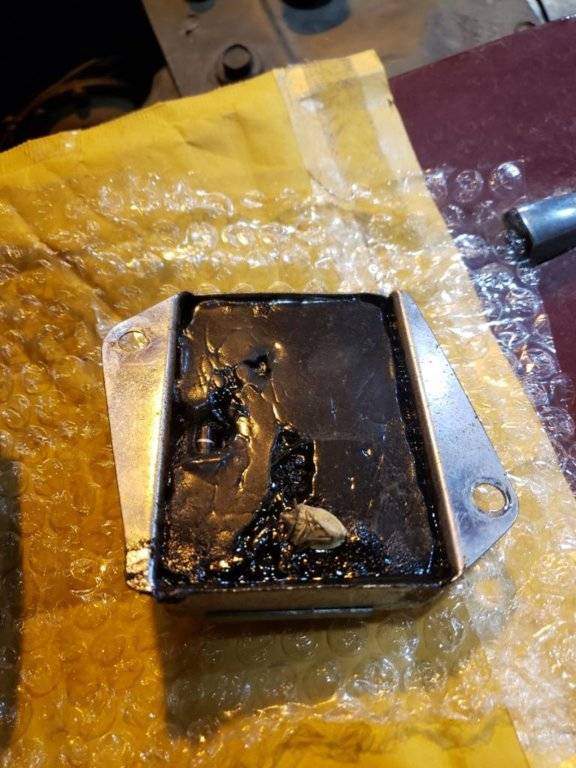

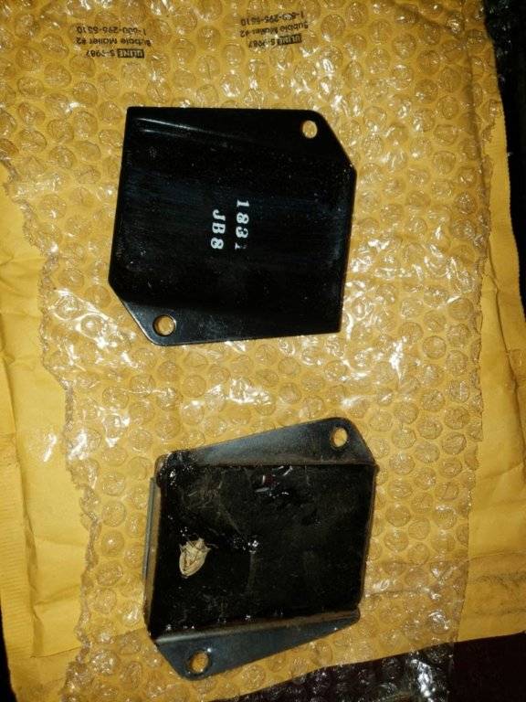

While I was hard at work exercising the convertible, @71Polara383 was having fun with Medina. The weather in Illinois was not cooperating till this weekend, to say the least, but he still managed to replace the HCV (see my posts and pics in another thread), the air filter (Wix 42044) and the voltage regulator (last week) and to change the oil & oil filter (today -- WIX 51068 filter, PennGrade 15W40 oil). Oh, and he tracked down the air valve for the shocks and let them down as they were bumped up.
Here are some before/after photos of the VR. The one that was on when I bought Medina not only did not look correct, but it was in poor shape (leaking some goopy slime).
So, I bought this one from eBay -- it does not have the correct dimple as present on the original one in my 1970 Polara, but otherwise it is correct for the year. The part was listed at a reasonable $39.95 due to "cosmetic blemishes" that I could care less about (in fact, neither Wyatt nor I could see any -- kudos to the seller) vs. $49.95 for the "unblemished" part and a whopping $149.95 for one with the dimple. I have better uses of $100, especially given that the eBay unit's part date is consistent with my car's build date.
Now, thanks to Wyatt, the car once again looks right and works fine.
PS: here are the backs, good one at the top, shot one at the bottom.
FYI the VR is still available from the Dealer under a Mopar Performance part number P4529794
But I believe those are orange instead of the original black. Michel probably wants the original black if I have him pegged correctly on his 71 Monaco.

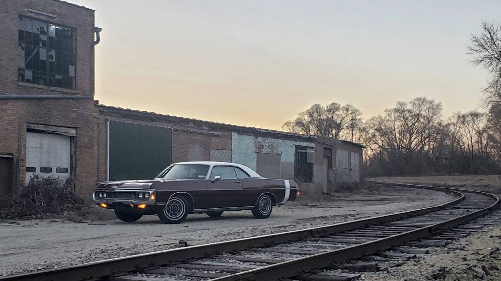

@71Polara383 continues to take really great pictures of Medina as he tests out the car's various systems. He just posted (in the Fuselage pic thread) several that he took earlier today. Here is my favorite of the bunch that he shared with me. The warmth of the parking lights offsets the cool landscape colors of Northern Illinois in March and the general bleakness of the abandoned railway buildings. The picture is perfectly framed to boot, with the train tracks taking the viewer's eye around the frame. Thank you!
If the car could talk "What happened to my world?". Great photography.

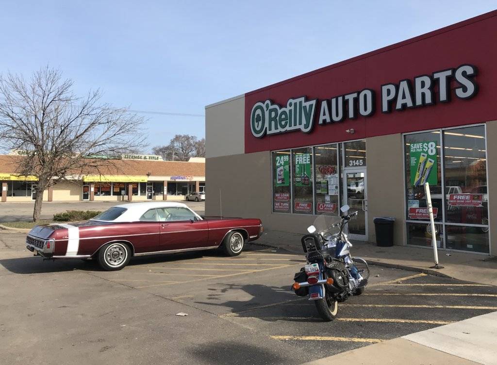

Visited @71Polara383 yesterday and drove Medina all around Rockford. Here she is, parked in from of O'Reilly (got some cleaning rags and a couple of Gates V-belts) with some mighty fine (as @Ripinator would say) two-wheeled American iron next to it.
