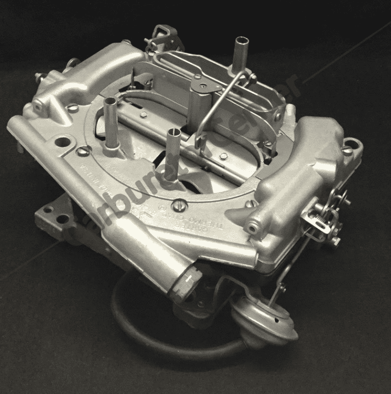

Looks like the fuel inlet to teh Street Demon is located roughly like a Thermoquad, so maybe a 72-74 bigblock musclecar fuel line might be close enough to tweak?

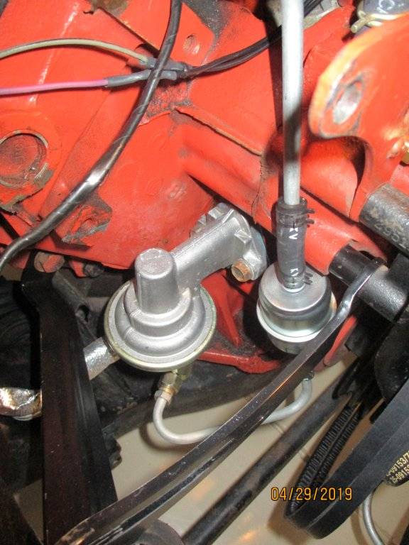

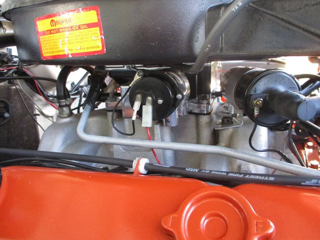

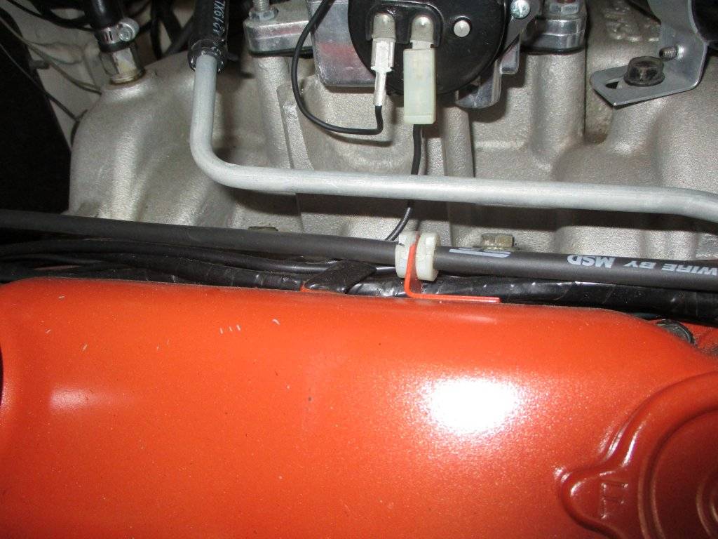

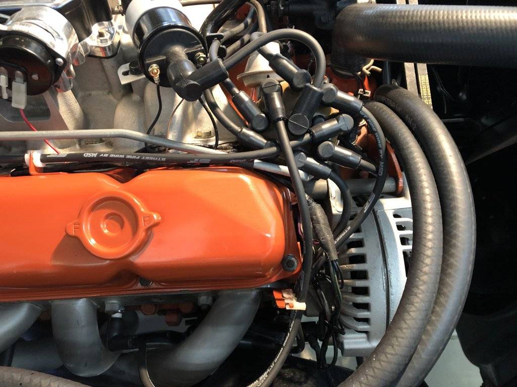

Street Demon on my 440 using the Inline Tube steel line (thank you Big_John) from the pump, through a METAL filter, back to steel as per OEM, then cut a bit off the end of the upper tube as shown and finish with a short length of hose. When you cut the line, you must slightly flare the cut end so that there is no chance of the hose sliding off when clamped. A slight flare can be made by hammering an appropriate-sized center punch into the cut end, or buy a cheap flaring tool at any auto parts store. You don't need the fancy nipple shape like is on the fuel filter ends of the tube(s).
Where the tube passes between the alternator/distributor/front of the valve cover is a bit of a fiddle, but it'll work out just fine with patience and maybe some very minor bending, if required.
You'll buy a brass 5/16 fitting to screw into the carb inlet and you're good to go.
