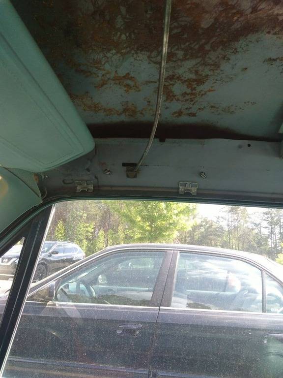

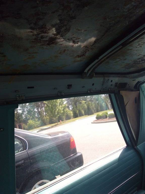

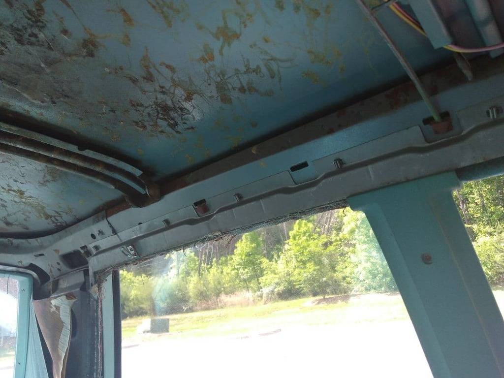

Felt good today so I went out and got some pictures about a question I had about the side of the roof, where the doors are: you have these slots where something was obviously supposed to snap in, I don't know if this was for the actual headliner itself or a metallic trim piece that would go over it. I lean towards headliner because every Newport I see online that's a C-Body just has trim with no chrome trim over the doors. Just wanted clarification as I haven't fished for a build sheet yet.
The passenger side:
Driver side:
As far as I know, the only thing you are missing is some of the headliner bows. I don't have any sedans, so I can't tell you how many bows it should have.
Jeff
I have the other 2 (or another one I think) - I just have it elsewhere.

Your car would have metal trim over the windows if it was a hardtop and not a sedan.
It wouldn't be chrome though, as Chrysler went to painted interior trim in '68 for safety, to reduce glare.
