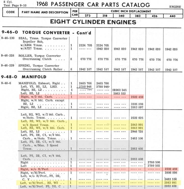

Ran across this video recently, where @tallzag mentions the 72 C-body U-codes have an HP manifold on the passenger side and a std log on the driver side. (IIRC that's what he said, and what I saw in hte video).
So that's opposite of the cars noted above.Maybe that's why the 'musclecars' had to have a log on the passenger side, all the E86 C-body copcars used them up.
