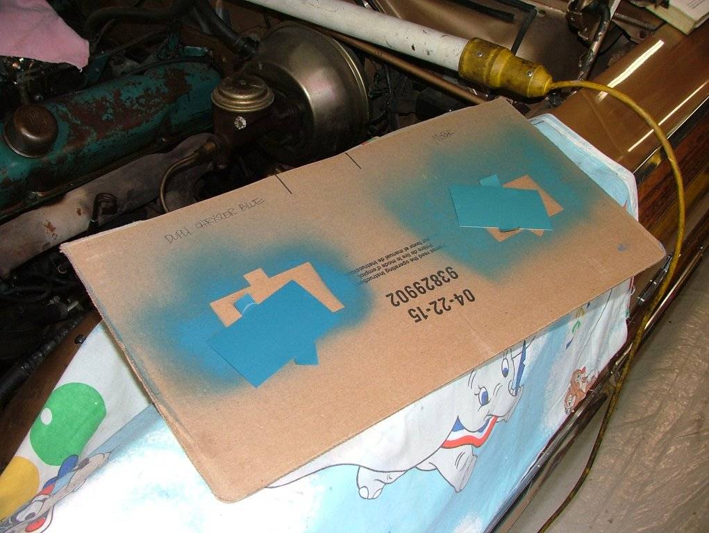

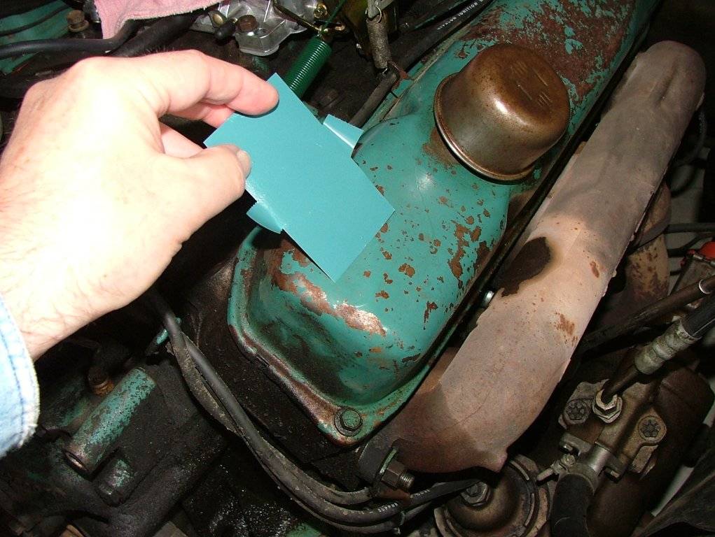

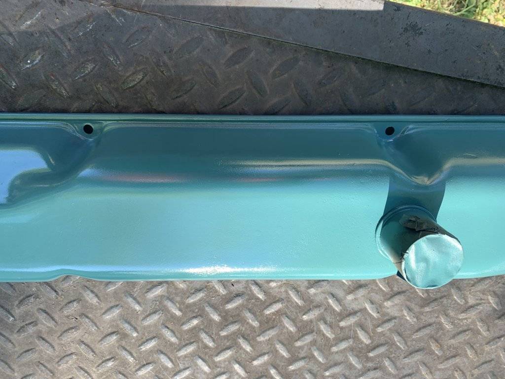

VHT SP126 Early Chrysler Blue: 3 coats
You'll love it!
VHT SP126-2 PACK EARLY CHRYSLER BLUE Engine Enamel High Heat Paint - 11 oz | eBay

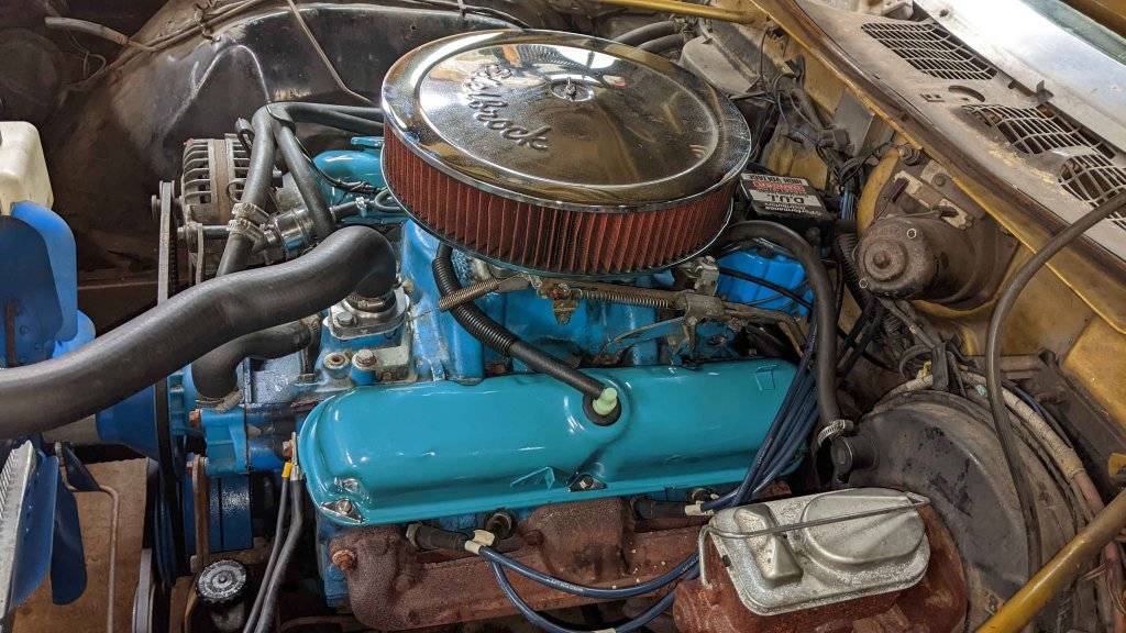

See valve cover. It has a little more greenish tint that my phone cam captured. Beautiful paint. Much cheaper than Hirsch and better quality, plus much quicker dry time.
This photo looks more like the blue I purchased from Hirsch. Is it the greenish blue turquoise that was on the 1962 Mopar engines? In 1970 they used the blue that is on your engine.

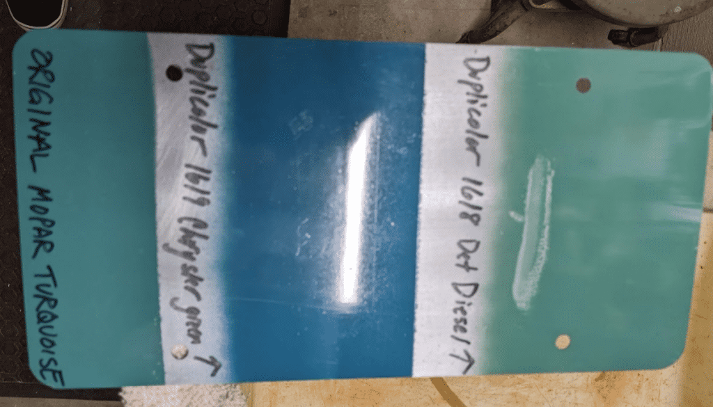

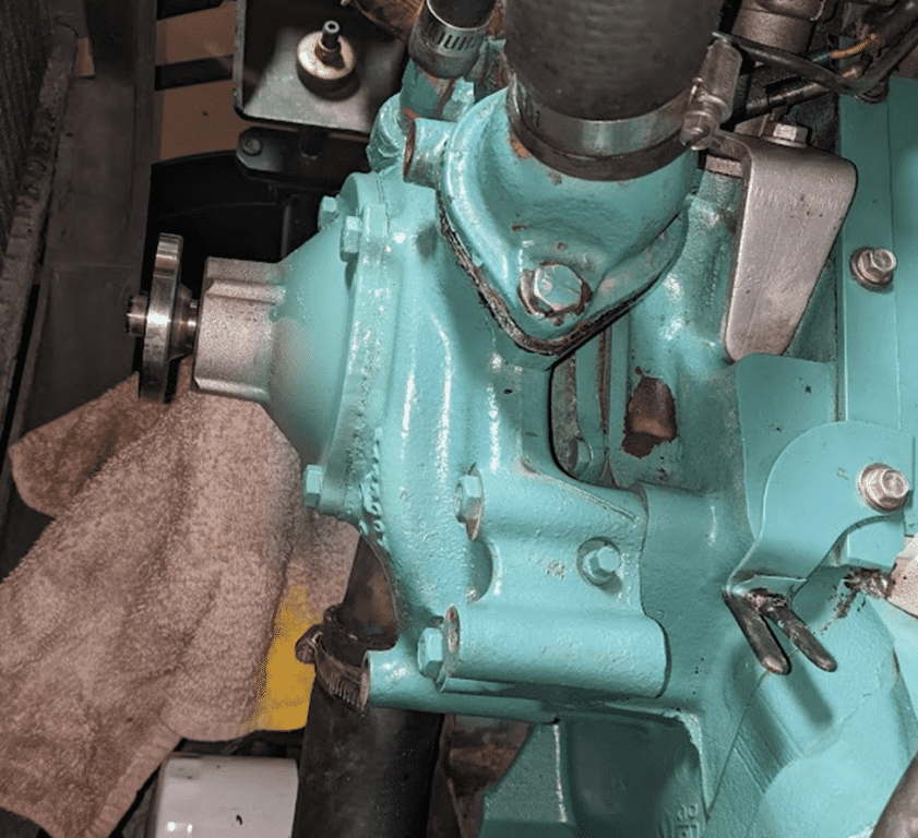

Here's a sample I did when I had a little left in the P4120752 can vs 2 other colors I tried.
Teh Duplicolor 1618 is Detroit Diesel Alpine Green.
Here's a comparison of the P4120752 vs the Duplicolor 1618 Detroit Diesel Alpine Green. The waterpump and 1/2" of the front cover are the Alpine Green. You can tell the difference a little bit more in real life.

I got the Alpine Green thru a local parts store for about $11/can (within the last 6 months).
As I generally do a whole engine at once (or at least a major topside paintjob), I'll probably stay with the Alpine Green for the future.
It is a little lighter but is closer to OEM than others I researched. Too many of them have too much blue (or green?) in them for me.

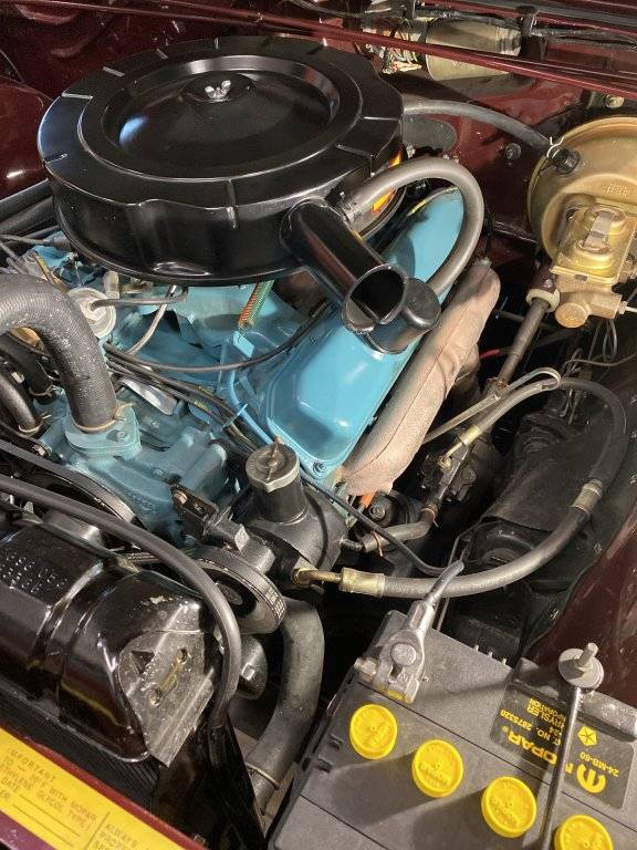

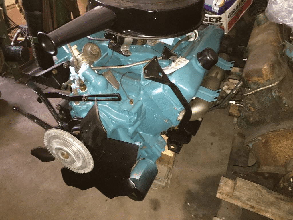

I used the Mopar engine paint from the dealer. I bought it about 3 years ago now. Cap color is not accurate.
And the end result. ‘68 383

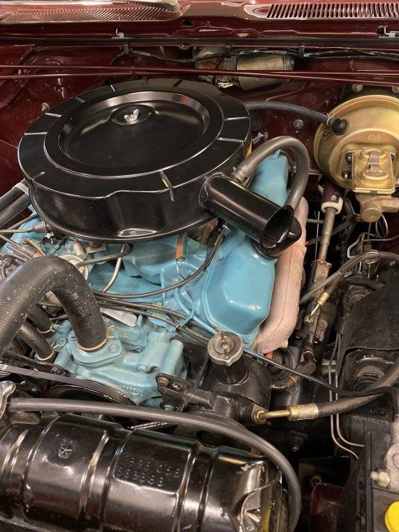

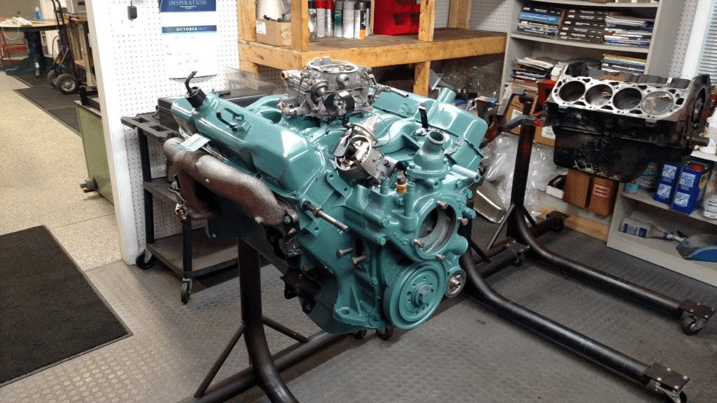

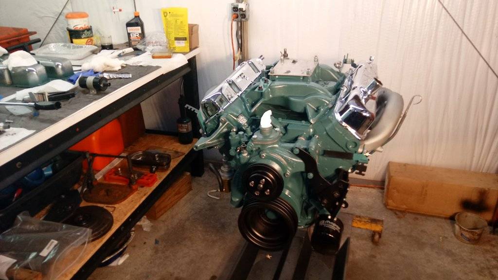

@moper Says VHT is spot on for mid-60's BB Engine Paint: Chrysler Blue
His pic. @RKC what do you think?
I think your engine looks too blue.

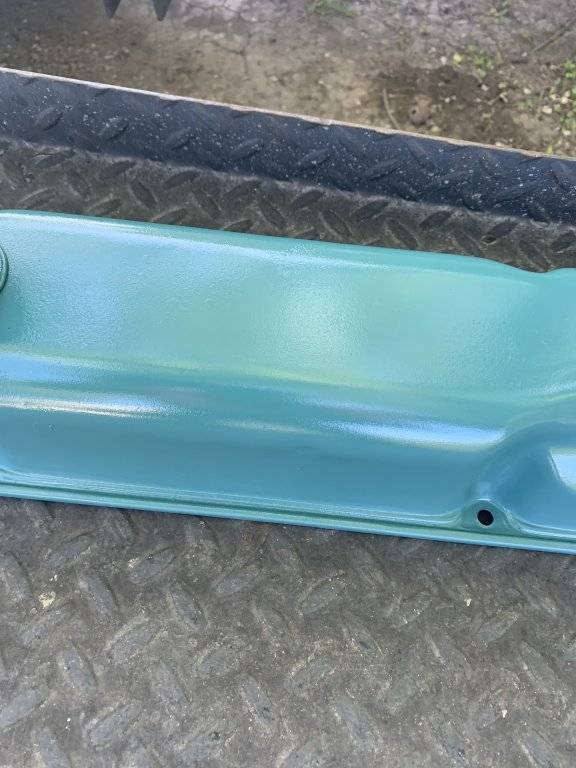

I painted this valve cover two weeks ago with Mopar paint that said Turquoise on the can. The color of the cap is Turquoise. I purchased the paint from Year One about 20 years ago. It does not match the original Turquoise of my other engines. I have a 1967 engine that is Turquoise. I have a 1968 engine that is blue. I think Chrysler changed the paint color in 1968, but still called it Turquoise.

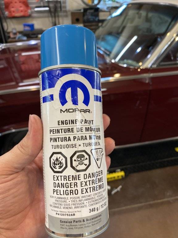

I also used the Mopar turquoise PN P4120752AB. I sprayed test samples of that versus an aftermarket color (Duplicolor?) and compared to the original paint, the Mopar was the closest match.

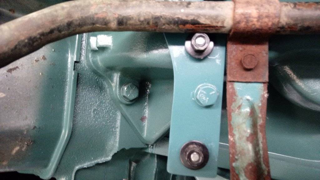

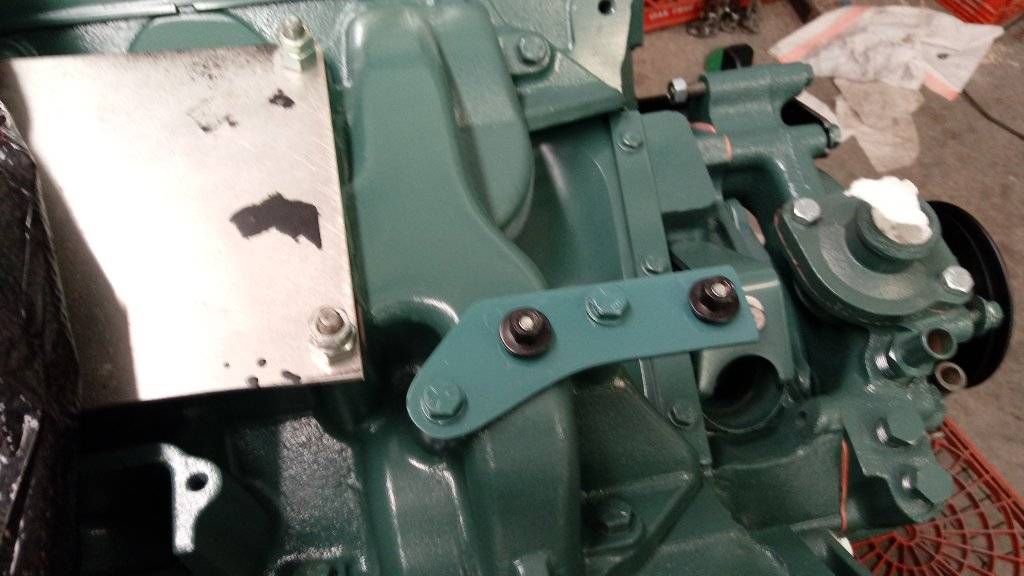

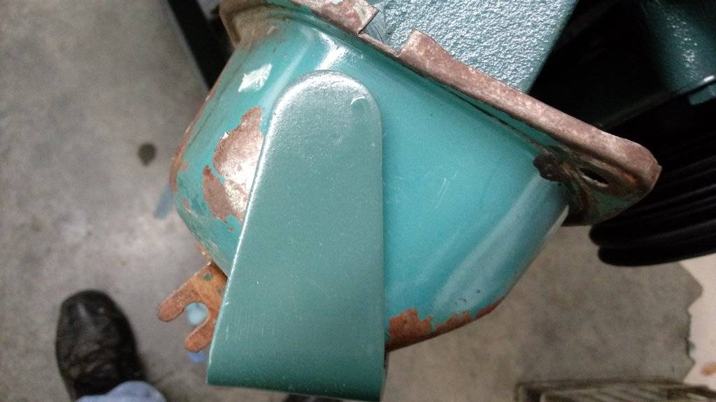

ok, my turn to add to the confusion...here's mine painted about 10 months ago with Bill Hirsch turquoise spray cans...or should i say green...the second pic is of my coil bracket painted with a 20 year old can of mopar performance paint...number 3 compares a tiny patch of original color on a a/c hose bracket...it basically matches the MP paint, NOT the Hirsch...last pic is Hirsch painted distributor holddown sitting on the end of a factory painted valve cover...this Hirsh stuff is MUCH greener than original...it actually looks better in these pics than it does in person...its a really dark ugly green...and its also been out of stock since the winter....i really dont want to pull the exhaust, brackets, pump and motor mounts so i've been trying to convince myself to live with it and a really dont have a source of something the right color but its really starting to annoy me...i just bought some bahama blue dashboard paint from 8774paint1 and if that works out i may try to get them to make me some engine enamel
oh and just some stupid questions for RKC....what exactly is wrong with the old MP performance paint that makes you say it doesnt match? too green? too blue? light ? dark?...are all your engines big blocks cause small blocks were blue the same years big blocks were turquoise...I'm not trying to argue i'm just curious myself as i've never heard of big blocks changing color in 68...lots of stuff can happen in 50 years and an engine that may have been repainted 40 years ago could certainly appear to be original at this point...you say your Hirsch paint is too blue, i think mine is too green and doesnt look anything like ripinators Hirsch paint...maybe what Hirsch sold me is what you're looking for but of course its out of stock...
just to follow up my story...I texted the pics of my engine to Hirsh to show them how green it is...their reply was that it looked great and is the correct color....they sent me a link to a video (which i'm too stupid to show here) where some guy did a color comparison between the Mopar Performance turquoise, some VHT he got from Eastwood (without mentioning name or part #) and Plasticote 210 Chrysler green (which is no longer available)...he states in the video that his club had concluded that the 210 Plasticote was the correct color for 62-65 and that the Hirsh paint was the best match to it...so that was their proof that it was right....to me the 210 and Hirsh look like the Alpine green...not anything i would call turquoise...at this point i wonder if Mopar changed the color around 67 (till they switched to corporate blue) and if the Mopar Performance paint is this later formula and they just claimed it was correct back to 62 when in fact the earlier blocks were greener...gotta hit my local paint guy and see if i can see a desert turquoise chip in person

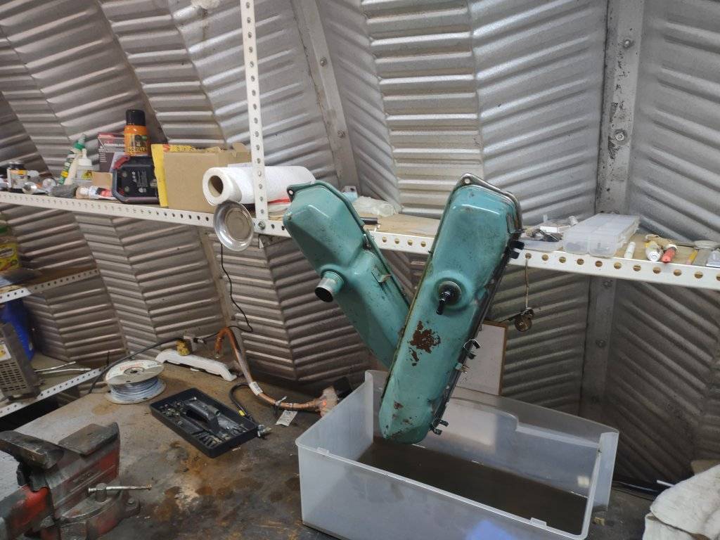

I just ordered some mopar green that looks like my 69 440. We will see when it gets here. I dont want that dark green stuff. Heres what my valve covers look like i just pulled.
