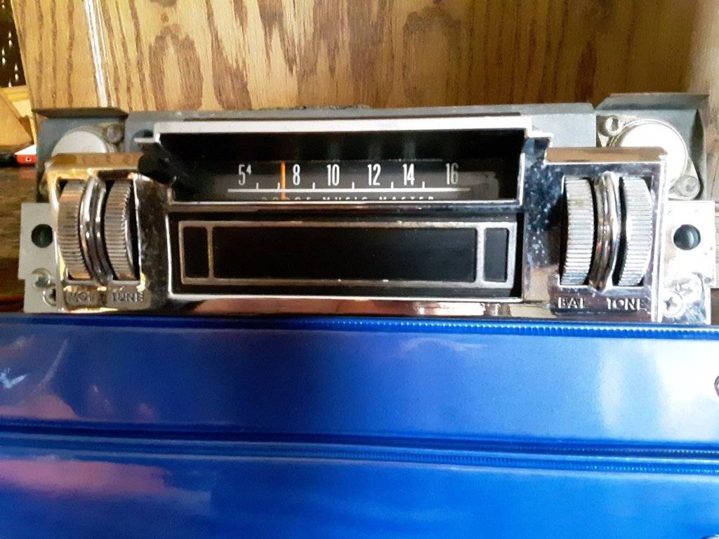

Can anyone help me/tell me how to identify this part? Pretty sure its a Mopar part. Thanks in advance.
No part number on it Ray?
Flat faceplate, not a '68 Chrysler. Thumbwheel ID in the faceplate, not a '69-'73 Chrysler, either. Process of elimination, for now, I'd suspect the best thing to do is to go through the order guides and such at www.hamtramck-historical.com and possibly some online sales brochures for '68-'69 Coronets or Belvederes.

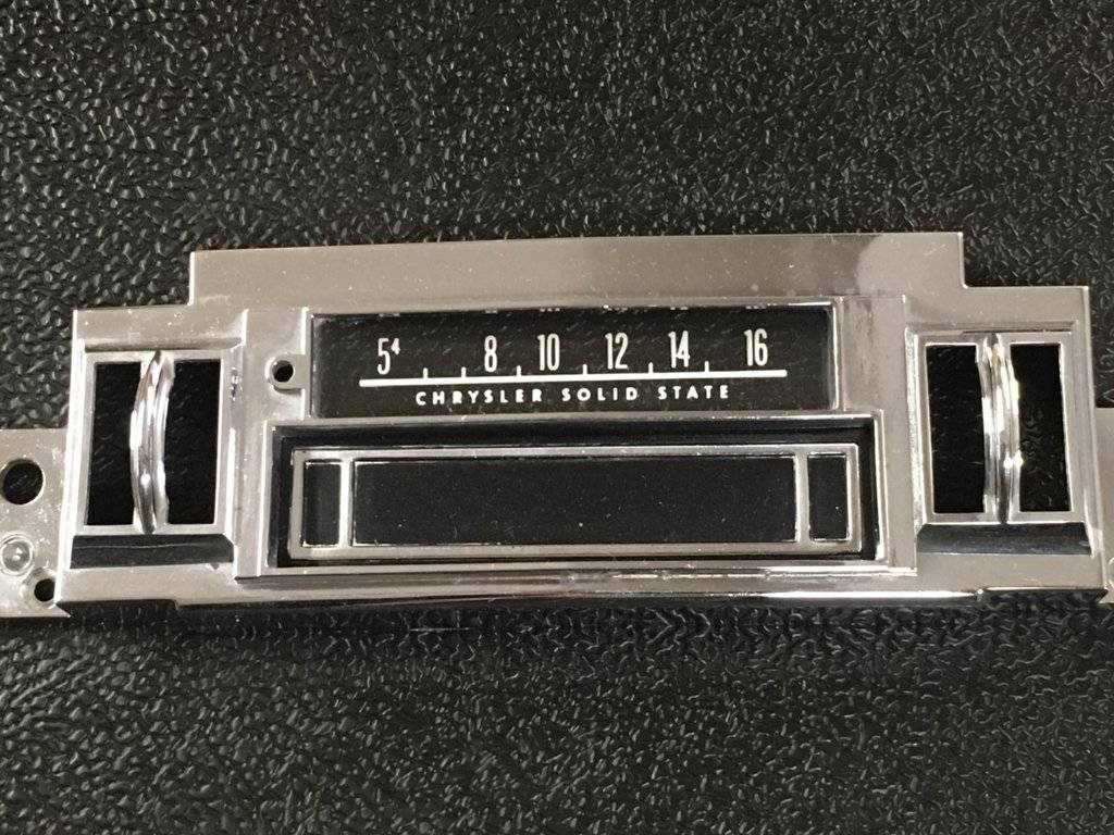

Here is an interesting site. I am working with a b-body Chrysler 8-track. Yours looks similar to the ‘68-‘69 b’s.(edit: now I know it’s not).

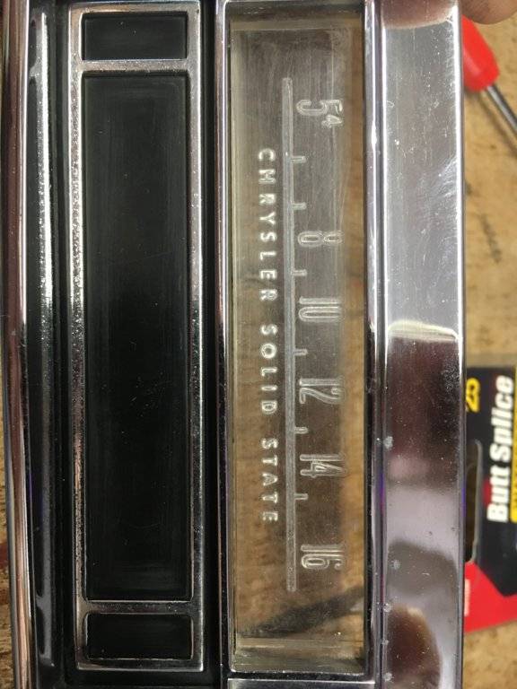

This is what I have. So far the white radio station id #’s were painted and polished, two dials were rechromed and a new belt was bought and installed. I haven’t seen any three #’s stamped part number, only paper information.
The radio in question is not a b-body radio.
The one above in post #9 is a 69-70 b-body radio. Look at the chrome faceplate, there are many differences.
Ahh, now I notice the dial labels, volume, tune, bal, tone. Also the thumbwheels are farther out. Nice looking faceplate though.
Read post #6.
Radio in question in OP post is a 68 Polara/Monaco unit. (It will fit 67 Polara/Monaco.)
One year only unit.
68 first year for 8-track and of course the Fusies came along next model year along with redesigned radio faceplates,etc.
View attachment 346313 View attachment 346312

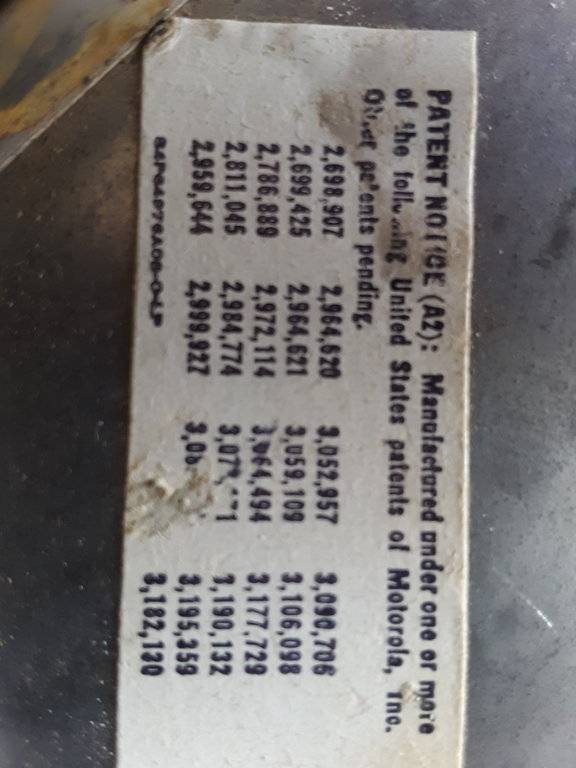

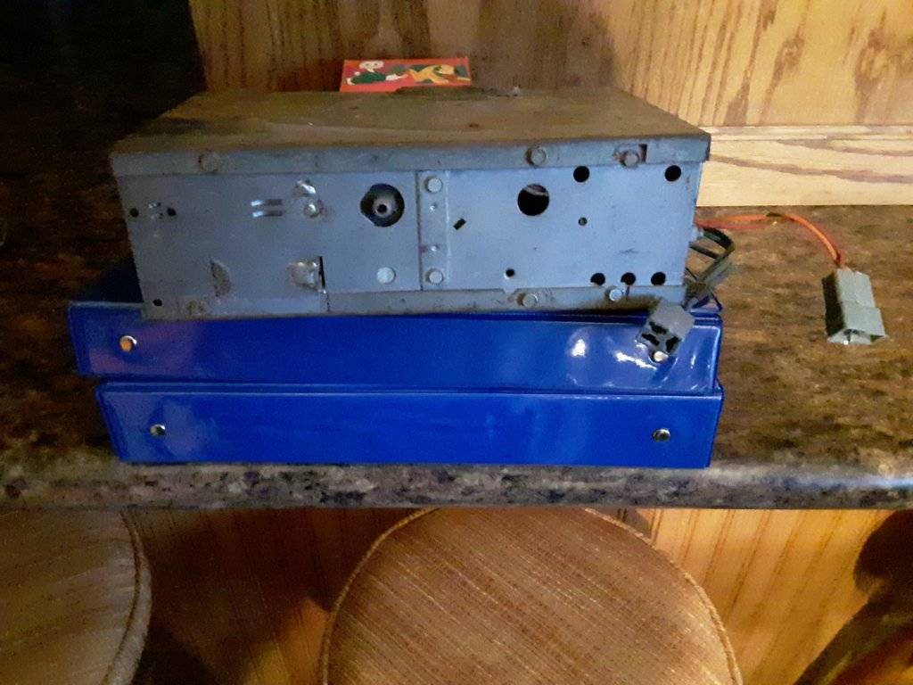

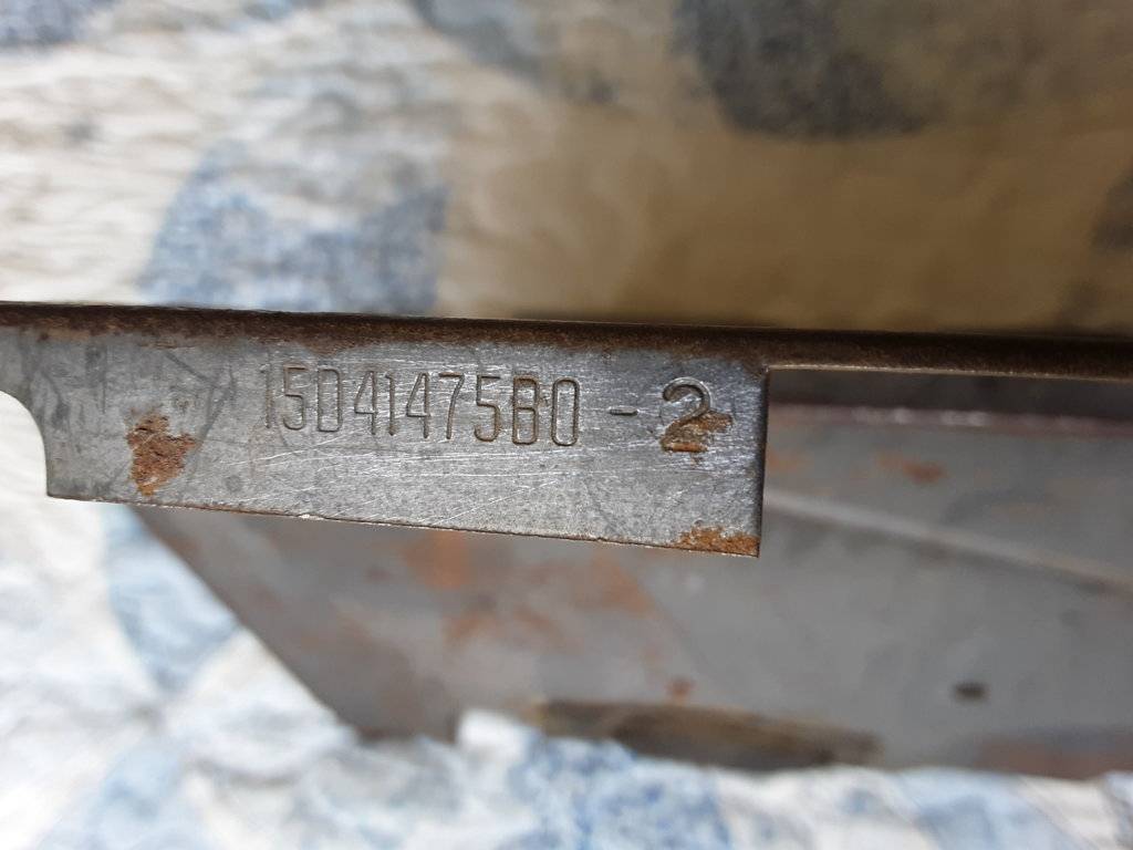

I am the owner of said radio. Ray was good enough to try to find out about it for me. I have found a stamped number on the casing, and a paper tag on the inside. Hope they help. Thanks all, Bob
