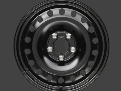

Did Mopar (or Ford, even) ever make a 16" steel wheel with a 5 X 4-1/2" bolt pattern?
Not a metric wheel but a wheel with RWD offset and back spacing.
I'll guess 80's D100 maybe?

That being said, I know places like Stockton Wheel have made 15" SBP wheels as the centers are the same size, the difference is made in the rim section.
I do not know if the 80's truck wheels share the same center standard but it might be something to look into.

Wheel Vintiques has a stock appearing steel 16" wheel with a dual 4.5"/4.75" bolt pattern but
A. It's pricey, and
B. I have heard not so good things about their wheels.
I was thinking used salvage yard type of stuff.
Ford Rangers have a 16" 5 X 4-1/2" but they are all stylized wheels and look horrible.

98 and up ford crown vic have 16" steel wheels, I don't know if they are 5 on 4 1/2 though might be metric
They are indeed 5 x 4-1/2. Their cop wheels are 7" and available with two offsets, med. and high. There is a problem though. The center hole is smaller. The wheels are too big for most lathes so you have mill them out. Four or five wheels would be too expensive to do.
