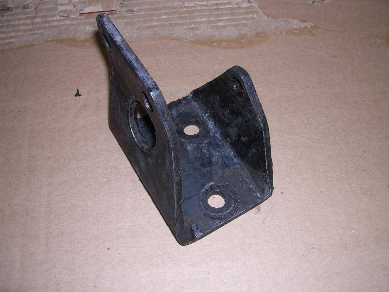

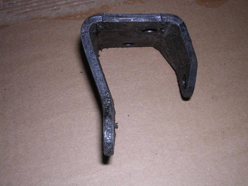

You just need a left side mounting bracket?
Rephrased - is it just the left side mounting bracket you need? If so I think I have one I won't need.

ive found the insulator for 5.99 the bracket is what i cant find
Make sure it is the correct insulator. An original left insulator has a single stud where the bracket mounts. If you've got one with twin studs, you'll have to get the Schumacher bracket as it will not work with an original bracket.
Just to be sure, you only need the driver's side bracket, right?
