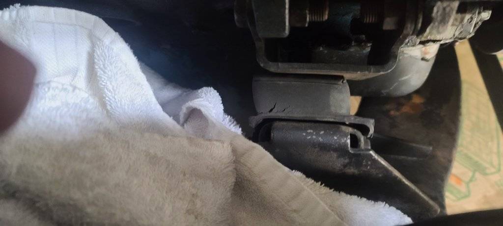

Might have found a contributing factor. Motormount dont look so well.
Had a new engine mount laying around and replaced that. Looks like that might have done the trick. Motor seems way more stable now.
