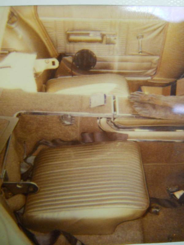

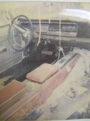

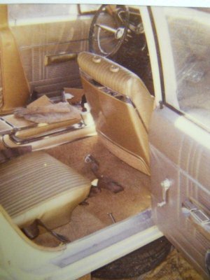

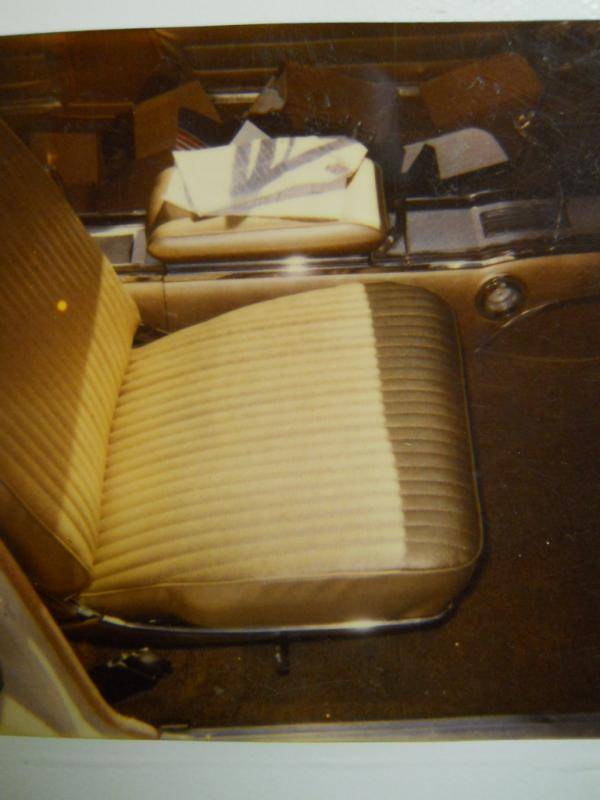

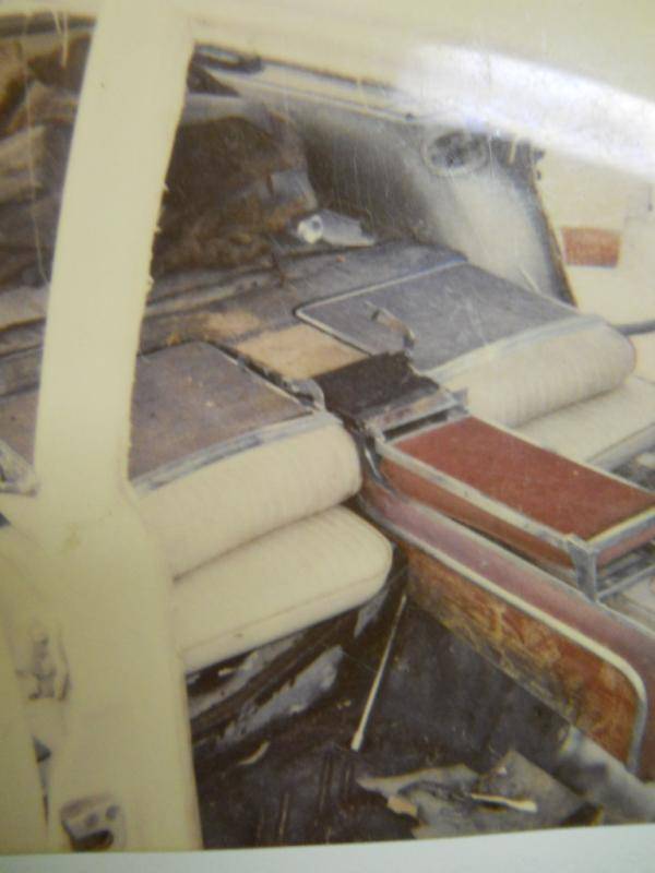

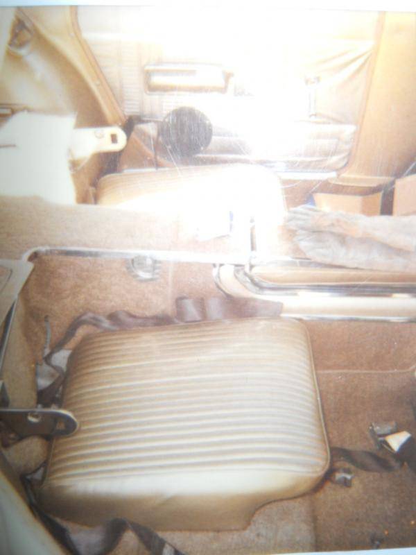

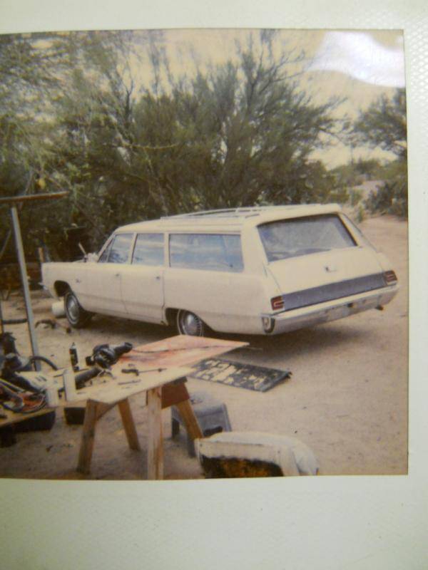

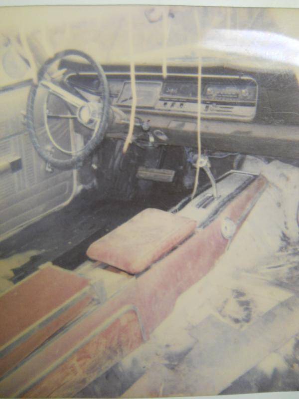

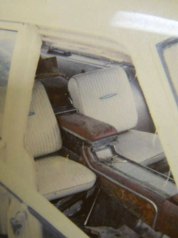

Just do what I did to my 67 fury wagon when I put a 66 charger interior in it,,full length consol and all,,I just cut off the selector part off my coluem and filled it,,then sanded and painted,,if you play with it it will still move but looks correct.

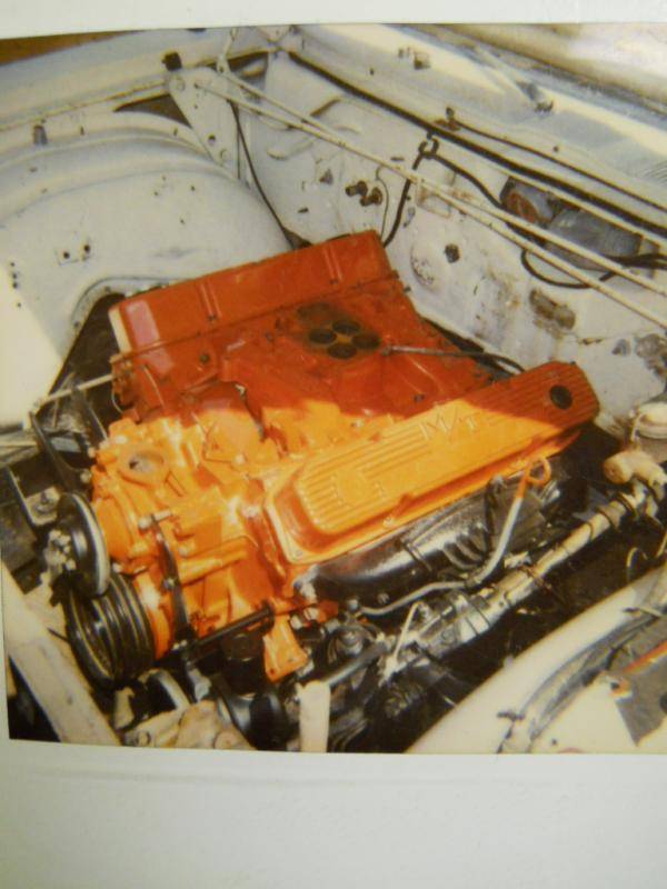

lets see if I can load any pics DSCN0009.jpgDSCN0010.jpgDSCN0011.jpgDSCN0013.jpgDSCN0014.jpgDSCN0016.jpgDSCN0017.jpgDSCN0018.jpgDSCN0022.jpgDSCN0024.jpg
The pics were taken around,,damn i'm gettin old but around10-12 yrs ago,,and were polaroid pics that my girlfriends daughter took pics of with my new modern camera and was able to load on my computer and I can find with luck,,,,I wish I had more but the old upholestry pics were mock up pics,it turned out great and I didn't realise how bright a gold interior would be but the wagon was originaly a gold/tan interior and year one didn't have anything close except a gold colord materal for 67,,,man was that bright and with a whole interior I couldn't keep the windows clean from all the gassing from the new upholestry,
I sold that wagon years ago to finish my 67 polara 500 conv and haven't seen it since,I would love to see it in a magazine when it shows up again.
