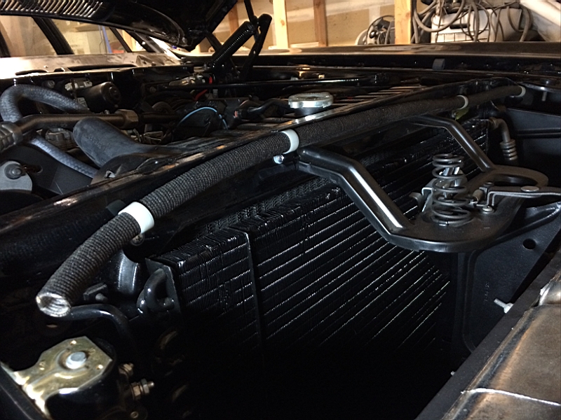

I thought I included this picture in my previous update but i guess I forgot.
The CHP use this tubing to run wire through, three different sizes were acquired and the correct size clamps. The clams were installed in the original holes drilled by the CHP. The CHP used sheet metal screws in most locations but the far clamp couldn't be put in with a sheet metal screw so a machine screw was used. This screw is seen in a vintage photo and a on the salvage harness we were lucky enough to find, oh, I had to track down a slotted round head screw, thank god for McMaster Carr.

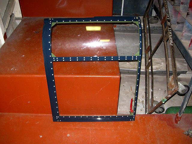

When I was doing the torpedo bomber I was lucky to find someone in Los Angeles who had all new molded canopy pieces for the plane. That is a lot of pieces when you include the machine gun turret. While in the final stages I allowed the fellow in charge of overall plane restoration, me being the TBM3E plane captain, to take the pieces to someone who could fit them into the various frames. Imagine my horror when they came back using steel phillips head screws. The originals were aluminum slots. Took me several months to go through the plane removing each and every screw to be replaced by the correct slot screw, washer and lock nut on the backside. Had to be around 1000. Thank god for the aircraft supply store opposite Oakland Airport. Same goes for the ship. I have a large supply of 6-32, 8-32 and 10-24 slotted brass screws to replace all the phillips head screws I run across due to sloppy sailors using whatever they had when they lost the original or damaged it beyond belief. It truly is the smallest details which set a restoration apart.

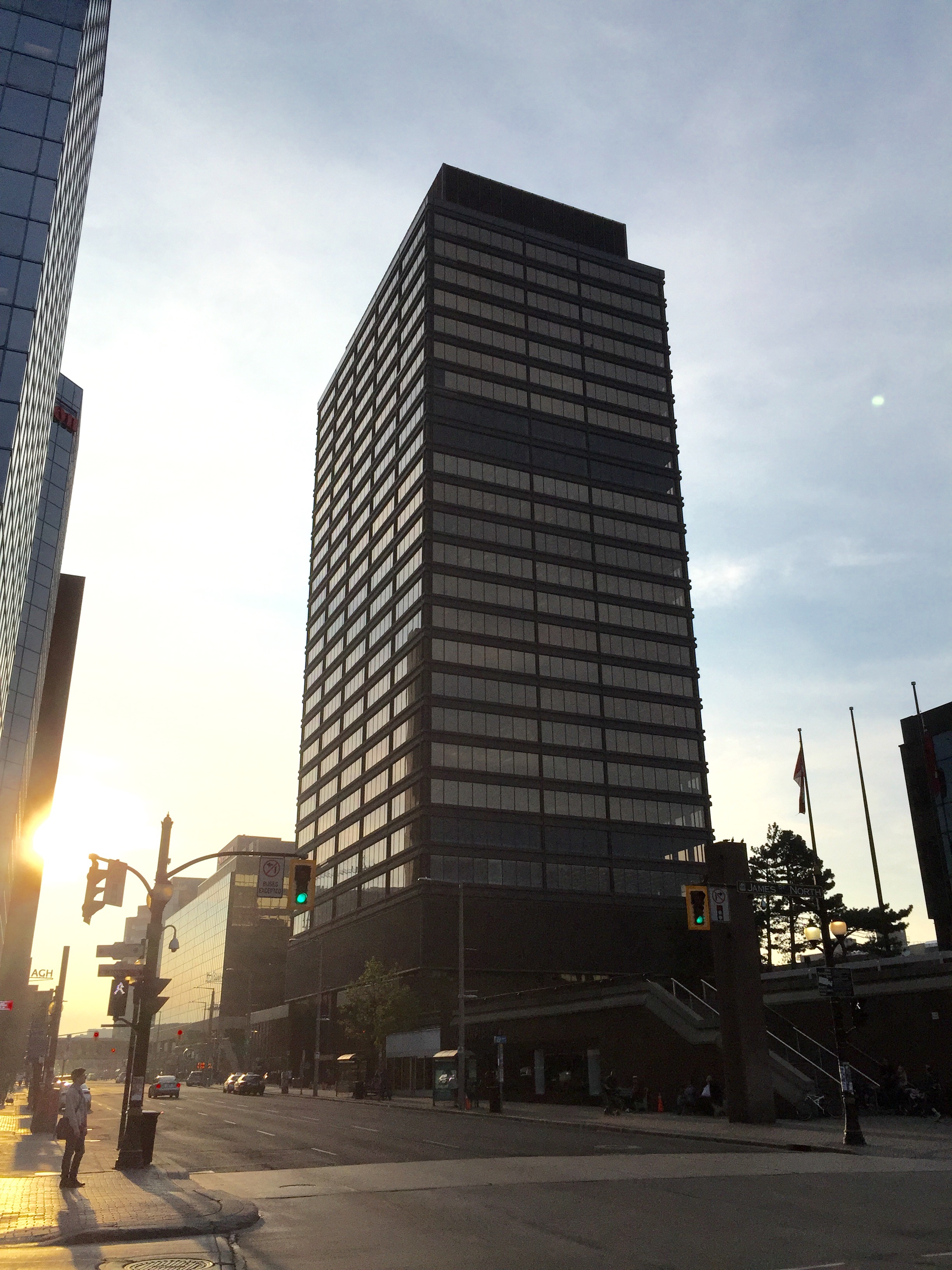

The reason I remembered about that was I was taking metallurgy in college and at the time a building using that steel was going up. Very radical for the time. The professor stole some material off the site and had us analyze it.
In fact, here is the building.

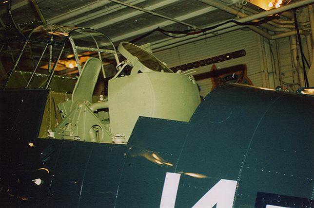

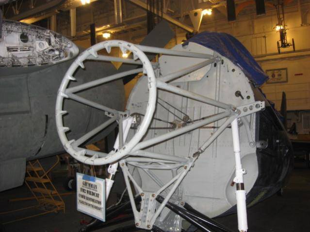

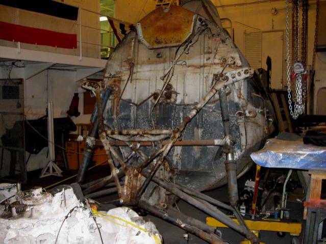

As Wolfen said steel is used in planes particularly back in WWII. Remember Navy carrier planes had to have strong landing gear for when they hit the deck and that is steel to this day. Shots below show the corroded gear on a Wildcat pulled from Lake Michigan after sitting 50+ years. The other is the gun turret in a TBF/TBM torpedo bomber which would naturally be steel. The steel screws used in my case were in the plexiglass pieces of the canopy. No issue with dissimilar metals just rust over time making it hard to remove screws and damaging the plexiglass. Since our Wildcat was in fresh water the aluminum is near perfect while the steel isn't. The engine of the plane was so bad it couldn't be saved and needed a replacement from our spares.
My employer's former head office building was also made of the stuff.
https://en.wikipedia.org/wiki/Stelco_Tower
