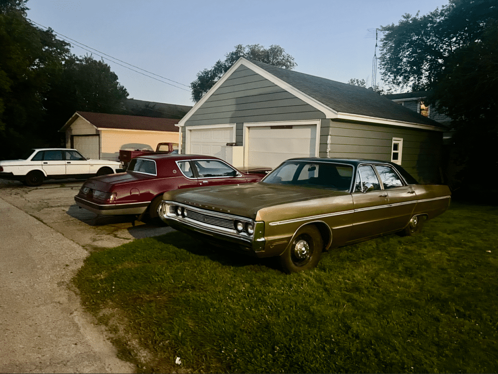

Picked up this 1970 Plymouth Fury 3 this summer. Was sort of running but not very well or for long. Cleaned up the points and it ran better but not very strong. Pulled heads and found some cracked valves and a bad cylinder.
I’ll be posting updates on the project. The plan is to keep the budget reasonable and not do a full restore. Just going to make it a driver and keep budget between $5k-$6k. I’ll post costs as well.

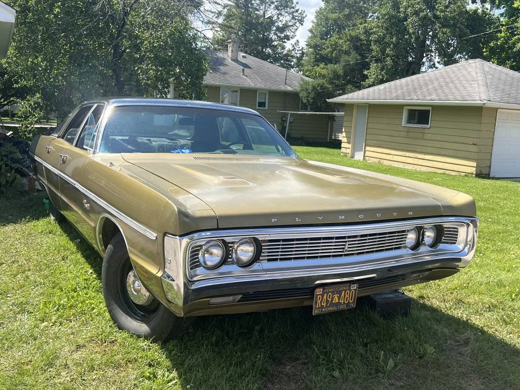

Here are some initial exterior pics.

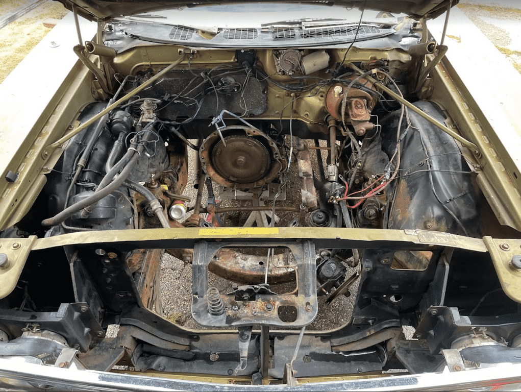

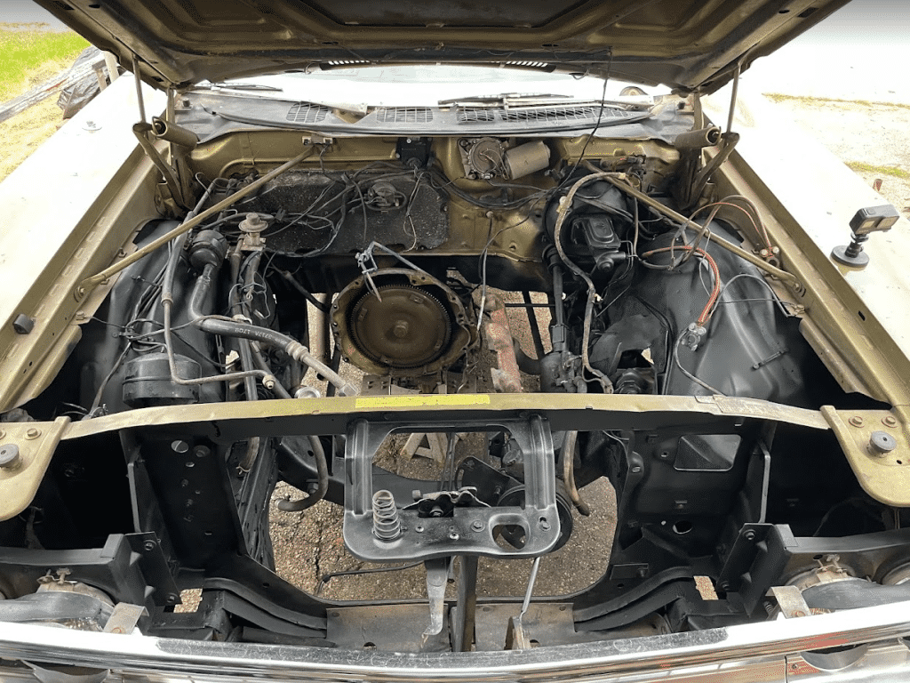

Some shots before I pulled the engine and carpet.

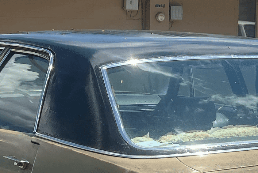

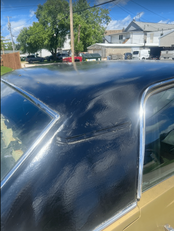

The owner before me removed the vinyl top and filled in one side of the c-pillar. I plan on sanding it back down and giving it a smoother paint job.

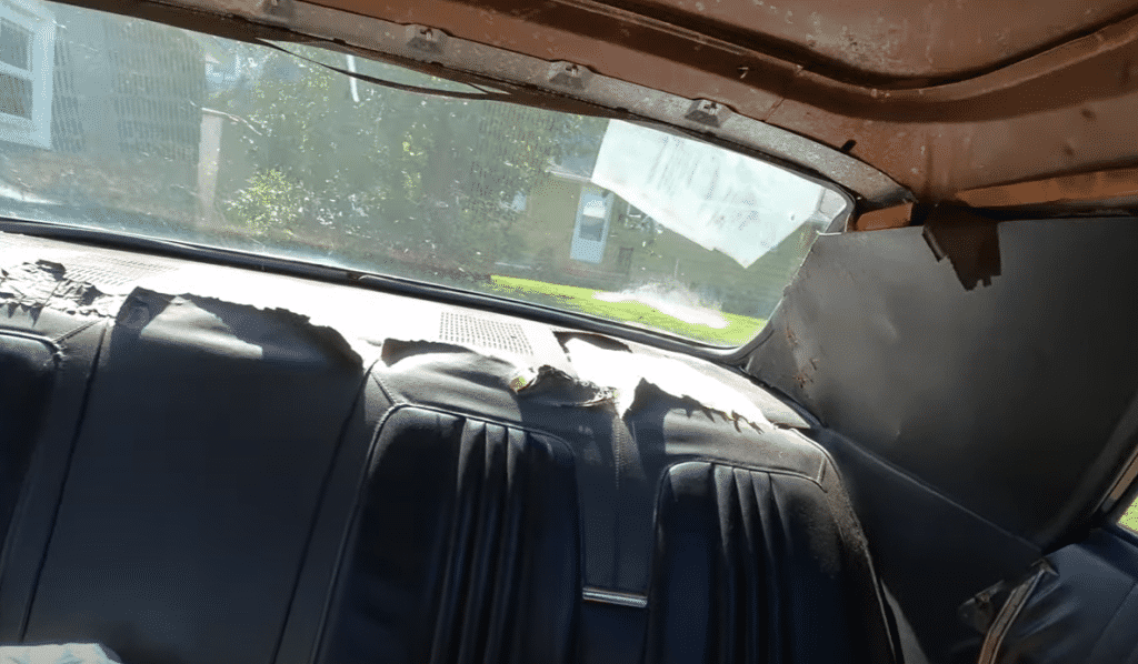

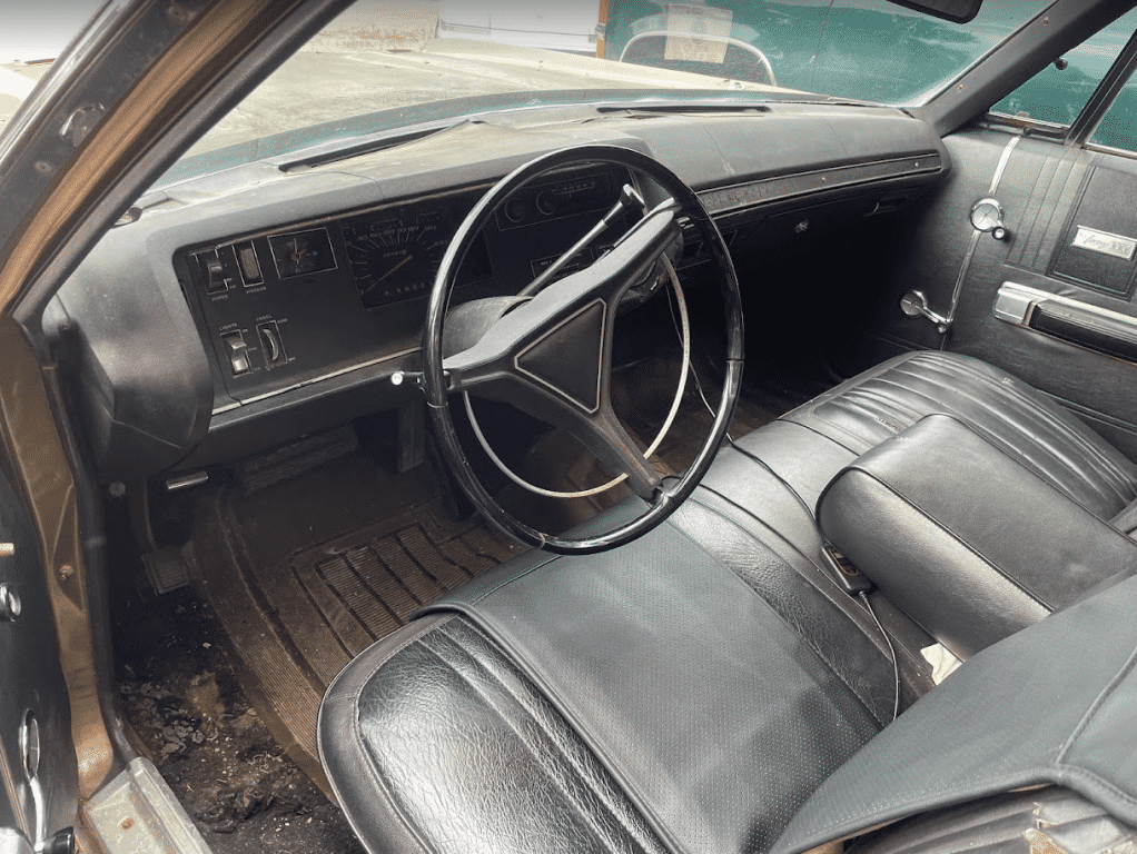

The interior is pretty roached...no headliner, cracked dash, ripped seats and nasty carpet. I did pull the carpet and the floors were pretty solid.

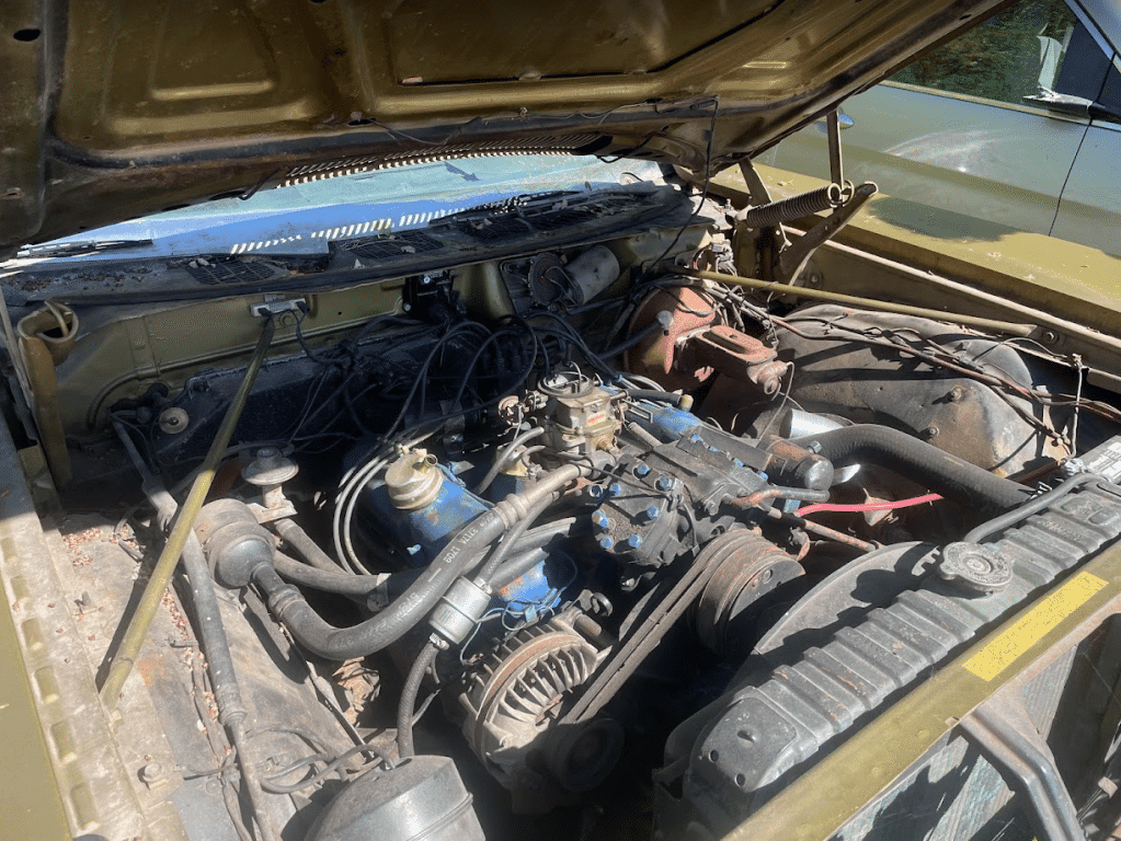

ENGINE

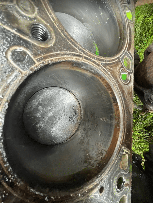

Engine was a 318 that was running but not very well. Previous owner was having issues with cyl5, I also noticed cyl1 wasn't firing either.
When we pulled the heads to replace with a good set of 318 heads I had, we noticed that the reason cyl 5 wasn't firing was because of this mess.

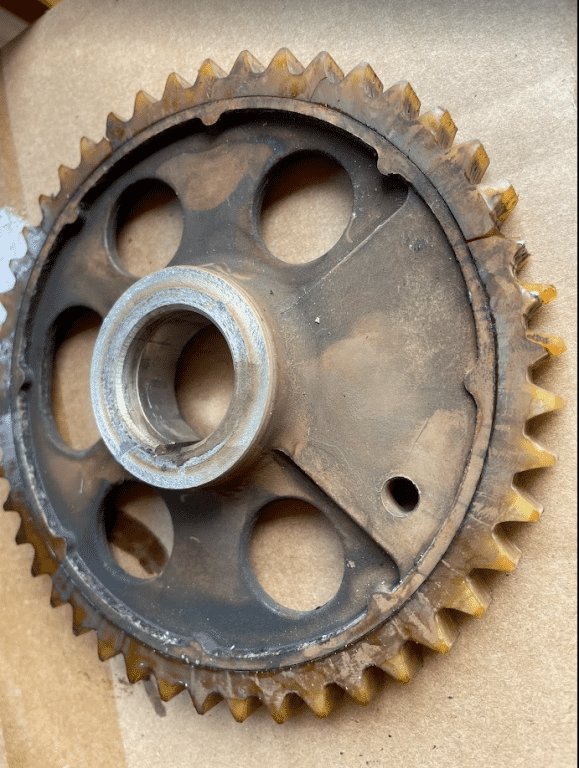

After I pulled apart the 318 (block may be good if it hasn't been bored over and the pitting isn't too bad) I checked that nylon timing gear and that was ready to go as well.

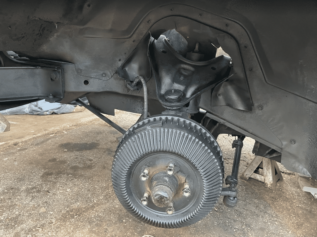

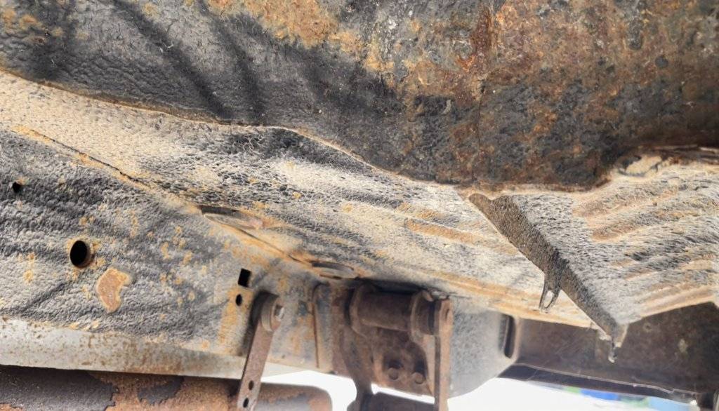

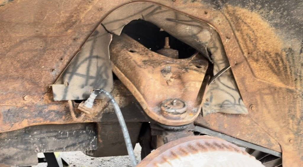

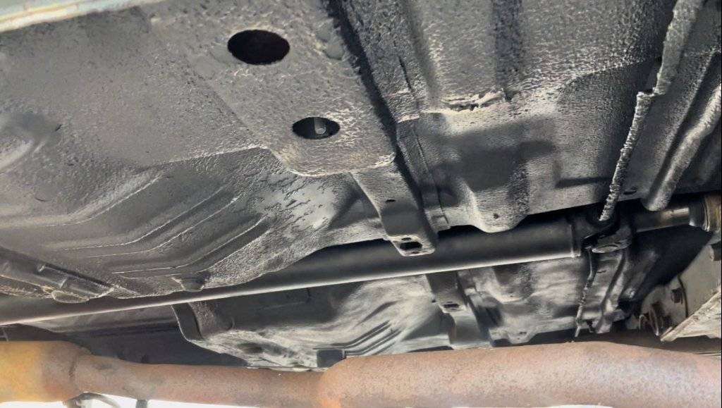

First thing I did was clean the undercarriage and engine compartment really well. Very little rust, some minor holes in floor pan under back seat and trunk and bottoms of rear quarter panels. So after lots of scrubbing, copious amount of rust-reformer and flat-black paint everything looks pretty good. I have some cavity wax on the way that I'm going to spray on as well in some of the nooks and crannys.
Some befores and afters

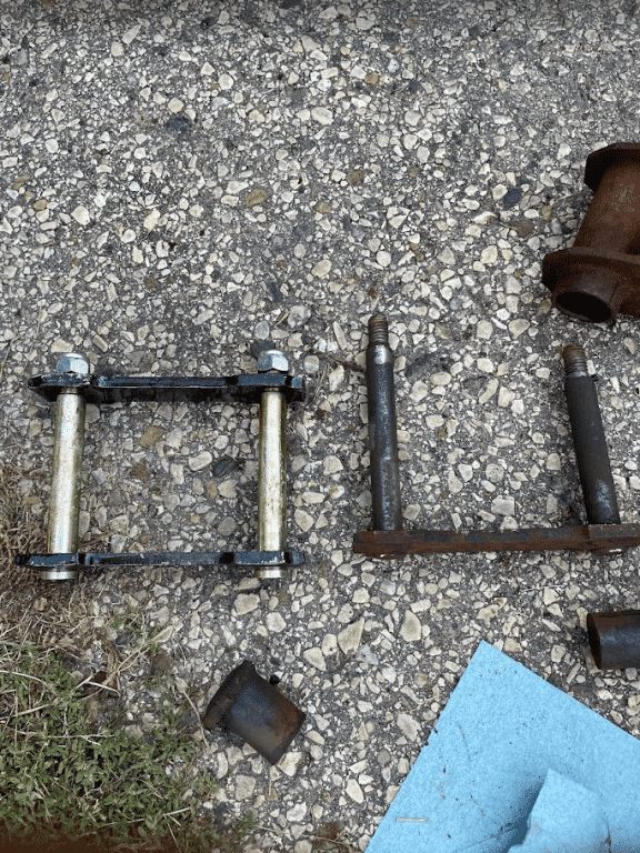

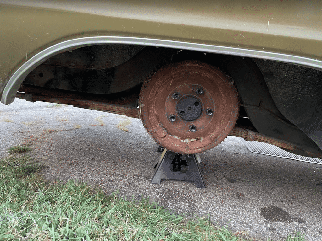

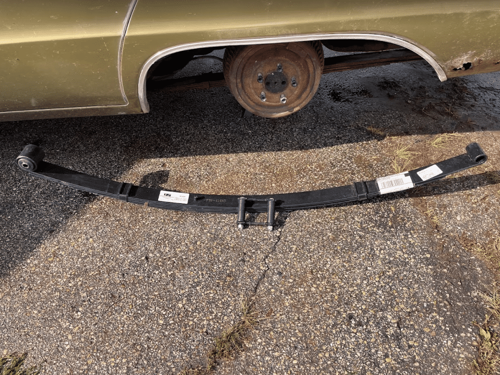

I've installed new rear springs and shocks at a cost of about $550. I did order new shackles but they aren't going to work which is fine because the bushings are actually still pretty good so I'm using those.
That passenger side spring was pretty sprung.
You can see that the one end of the shackles is longer and the new ones wouldn't fit into the mounting bracket.

BTW, I chill went down my spine when I saw that god damn vinyl gear!

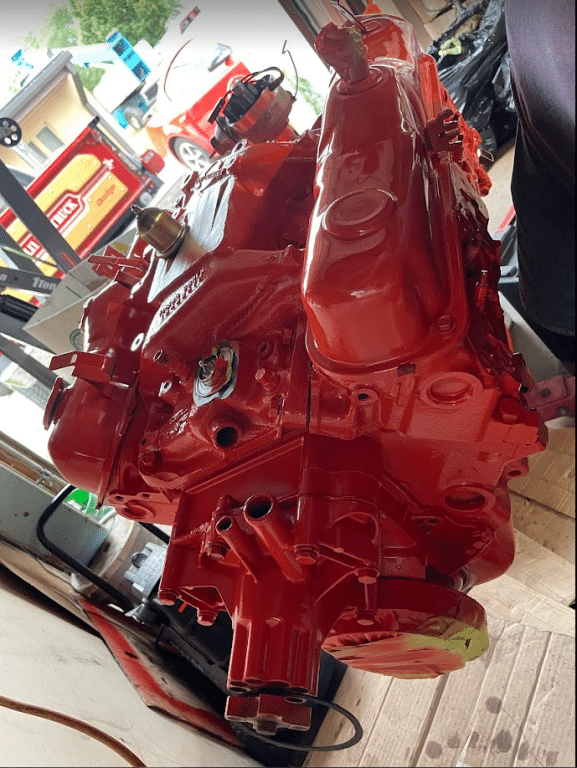

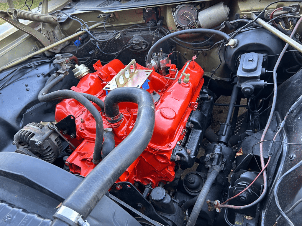

I got the 360 dropped into the nice and clean engine bay. Love the bright "hemi" orange in the mostly black bay. I have a few things to do and then hopefully by this upcoming weekend I'll get it running!
I did pull the A/C lines and plugged the ends. If I go with A/C I'll probably do an aftermarket setup.

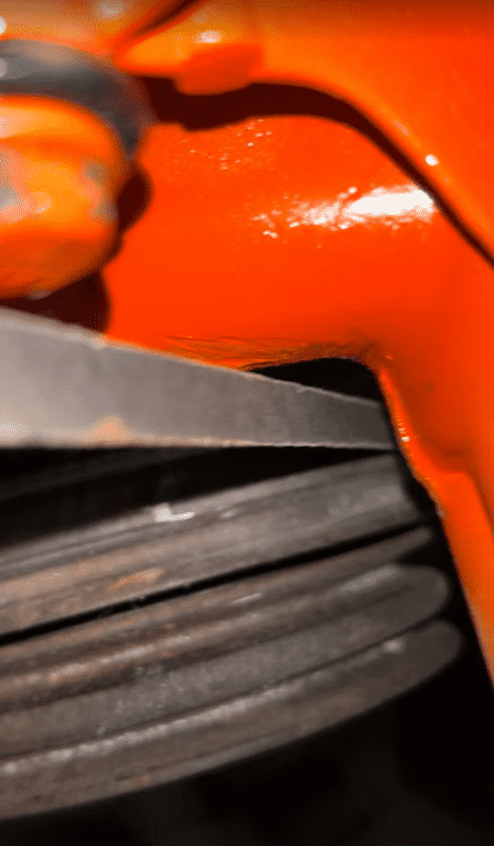

I had to modify my water pump a bit...on my D100, the alternator belt came directly from the crank pulley with no upper pulley. Well when I did that on this one, the water pump had a fin that was interfering with the belt. All the other pumps I had didn't have this fin (or at least not as large)
...so now this one doesn't either.
