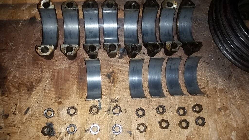

Unfortunate turn of events today. Rod knock (or some other knocking) kicked in about 2 blocks from home. Immediately stopped and checked oil- it had the right amount. Carefully creeped back home. No miracle cure for this, I think this means rebuild. I'm scared to even start the old girl again.
How many miles on the car/motor? There are different "knocks" between a rod and main bearing. OR might it be higher up in the motor, like a chunk of carbon (possibly from accumulation on the backside of an intake valve) coming to reside on the top of a piston? But, considering the space between the top of the piston and the top of the open chamber head combustion chamber, it'd have to be a sizable chunk.
Might get a roll-back wrecker to transport it to a repair shop for an oil pressure check? Perhaps they can better isolate the noise and determine where it's coming from?

It will be a while before I can do diagnosis. It is an original, stock 80,000 mile engine. It has been steadily running rougher lately and getting low vacuum readings, so it may be time to rebuild anyhow. The oil pressure light comes on when the key is turned, but has never came on while the engine was running. I recently was messing with the choke, and a small screw got lost while I had the choke out. More than likely I just set it somewhere, but I was worried it may have fallen in. I have logged about 50 or more miles since that happened.
Thanks for the information. I somewhat doubt that you've got an internal engine issue for the items mentioned. Considering that the pistons are about .100" BELOW the deck surface of the block at TDC, combined with the open chamber heads, IF anything fell through the carb throttle plates, not very many places for it "to lodge" in the cylinder(s).

Our experience with the 383s I've had (the '66 Newport first, then my '70 Monaco 383) is that at about the mileage you now have, #7 exhaust valve started to "burn". There are two things you can diagnose that with. One is with a compression tester (the screw-in type will work better than the "hold-in-the-hole" version! Just worry about the comparison with other cylinders, NOT the particular numbers obtained. The other, more "shade tree" method is to start the engine, let it run at idle, then take a shop towel and loosely place it over the end of the tail pipe. The flow should be generally smooth, BUT if there is a negative pulse, it'll suck the towel into the pipe, as you hold it around the endge of the pips, firmly, for that moment when the negative pressure pulse (from the piston with with the burnt valve moveing downward in when the exhaust valve is closed. If there is some in-out action from the normal pressure pulses anyway, when that bigger negative pressure pulse happens, it'll suck the firmly-held rag MORE than at other times. Might have to look closely, but it's there.
You can also use a vacuum gauge for this too, BUT my experiences with vacuum gauges has not been too good, other than checking levels. A burnt valve will also cause loss of power and a variable rougher idle, as you're losing power from one cylinder.

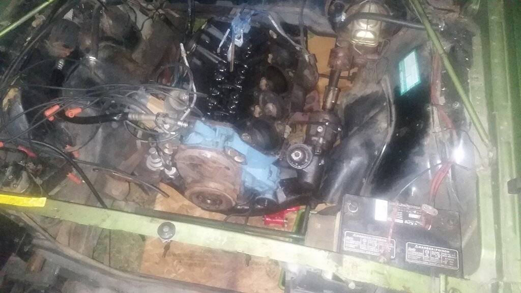

I have moved my recent post here because the subject has changed into a full rebuild. For those who have not seen my recent post:
Looking for advice on valves, lifters etc.
I am now doing a complete full rebuild per the advice of David Hill, and suggestions of a few others.
64,000 miles were put on the engine before it sat for many years. It's been driven 16,000 miles since it was woken back up in 2016. A total of 80,000 miles.
So far for the rebuild I have taken the heads to a machine shop to be completely redone to factory original. All new valves, springs, seals, hardened seats etc. I've done a lot of disassembly and definitely built a little muscle in the process. The engine has never been apart before. The gaskets all have the chrysler logo on them. The engine was built on October 7, 1971. This morning I got most of the rod bearings out. A few top halves will be removed when I get the crank out. All of them are stamped 10-71. The bearings all have scoring on them. I imagine a lot of the scoring occured when it was started after sitting. Some have worn through the top layer near the edge.

After a long time away, I am getting back into working on the car. I've had real trouble finding a machine shop that will work after covid. I kept "getting put on the list," waiting months, and getting excuses. I finally found what I hope is a competent shop, and I will be removing the block and taking it to them on Saturday. They will be hot tanking it, installing freeze plugs, boring the block, polishing the crankshaft, installing new crank, rod, and cam bearings, new pistons and rods, moly rings, and balancing. I have been told the return time depends on how hard it is for them to find bearings and pistons. Possibly up to 10 weeks for pistons. I will be sending the differential and brake booster to be rebuilt also. I had the heads rebuilt to factory new with hardened seats, and have had them back for a while. I have many parts on the way, and this will give me time to work on other things. I'll be working on brakes, and steering while I wait to get the engine back. Thank you all for your knowledge and experience. I wouldn't be able to save this car without a little help.
Update: I have bit the bullet and just decided to give this car anything it needs. However much that adds up to is just what it costs. It'll be nice getting it to a point where everything functions like it should. I am doing all the mechanical/ electrical and will get everything finished so it can be enjoyed for a while before moving onto cosmetic/body work. This week I have spent hours and hours scouring the internet for hard to find parts. Many parts have been sent out to be rebuilt/refabricated. Many NOS and brand new parts are on the way. The engine pull is on hold until pistons show up in the mail. When it comes back from the machine shop assembly will start. Until then, steering, a/c, heat, wiring harnesses, and brakes will be getting an overhaul. After the engine, by far the most expensive parts have been for heat and air conditioning. Evaporator, condenser, drier, compressor, expansion valve, and heater core should all be coming soon. Getting the heater box out from under the dash was interesting. After all the screws were out, it took an hour to separate the halves because someone used tar like gasket maker to seal the box up. Things on my list are: have the differential rebuilt, buy leaf springs, send out the brake booster, send torque converter to be rebuilt, and driveshaft balancing. I am still looking for NOS or close to front driver and passenger door seals, a fan shroud, and a factory original working am/fm radio. I'm happy progress is finally being made, and I will be on top of the world when the car can be enjoyed again.
