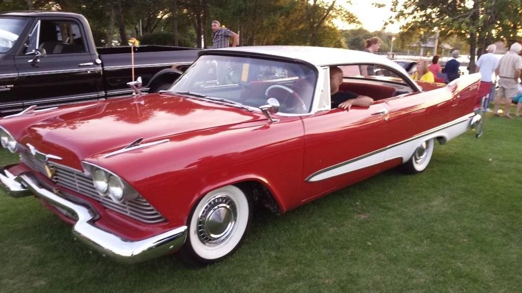

my 1958 Plymouth 440 2 fours
That car is amazing, did you build it or buy it like that?
What a beauty. it's unusual to see a savoy sport coupe let alone with the optional sport trim.

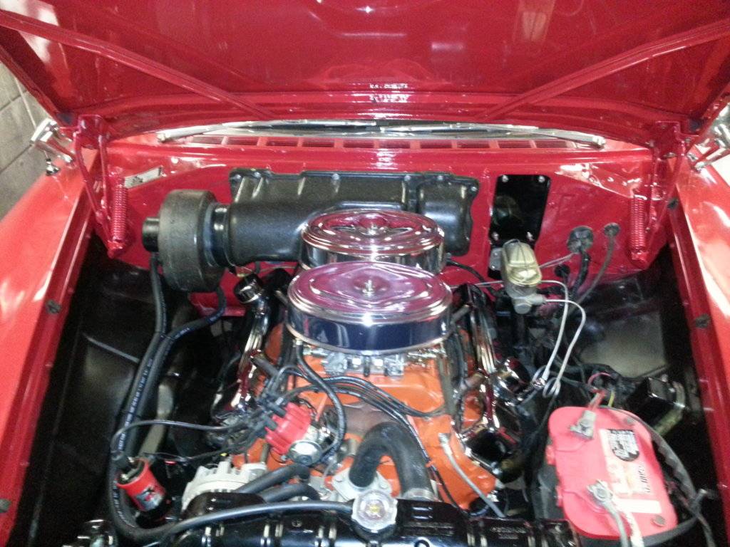

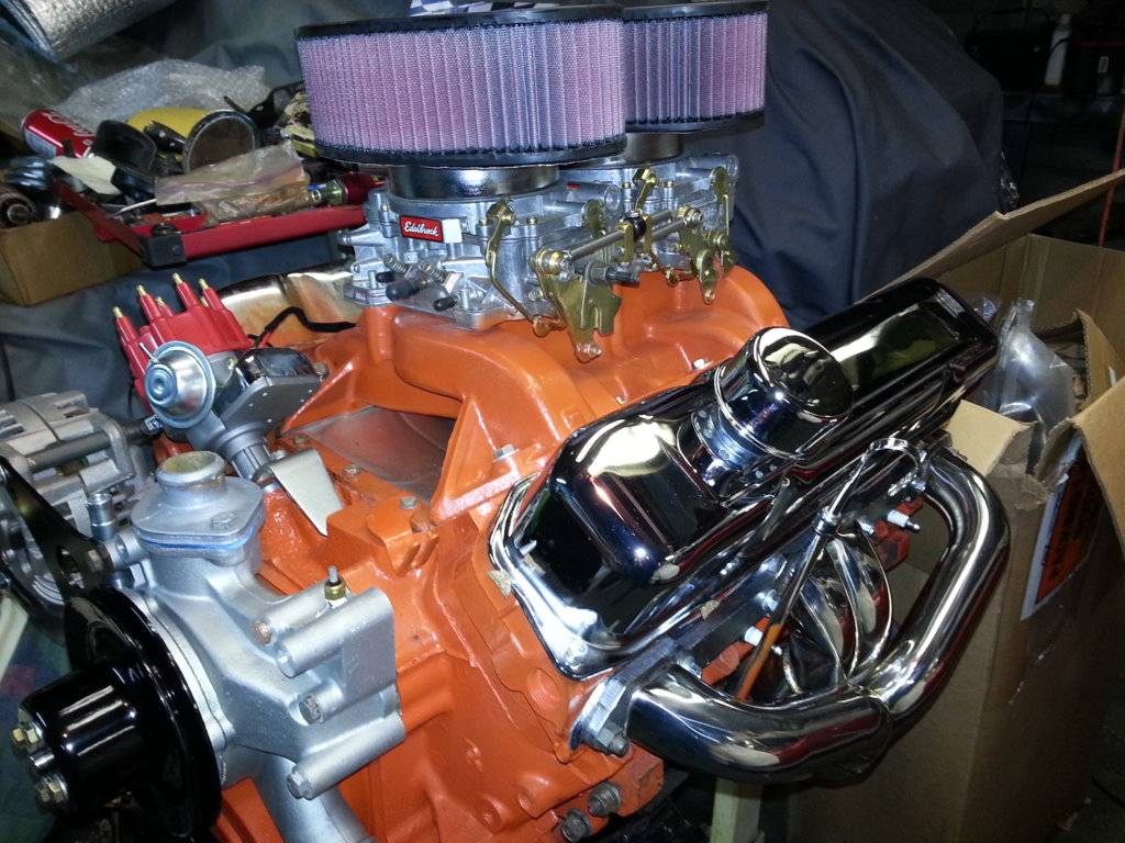

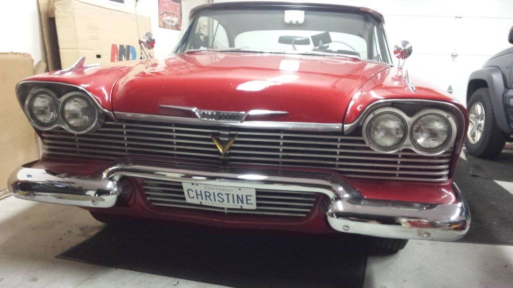

Thanks guys for the nice words..The (back story) is I bought it from a guy in Toronto 5 years ago who had it 10 years and didn't do anything with it and couldn't get it running so it sat. I bought it from him it had a flat head 6 in it. I did all the work changed it to a 69 440 40 over 915 closed chamber heads with the heads all ported and polished, Headers 3500 stall converter. I Then I took out the 2 speed 6 cly tranny and put in a 727 tranny with full manual valve body. I took out the rear end because of hard to get brakes and you needed a brake puller to get them off .So now has 69 charger 8 3/4 323 sure grip in it. changed the front drums to F body front disc brake now stops and goes grate with a awesome rumble from the 440 engine I still have the car....Sleeper car
