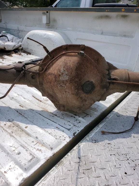

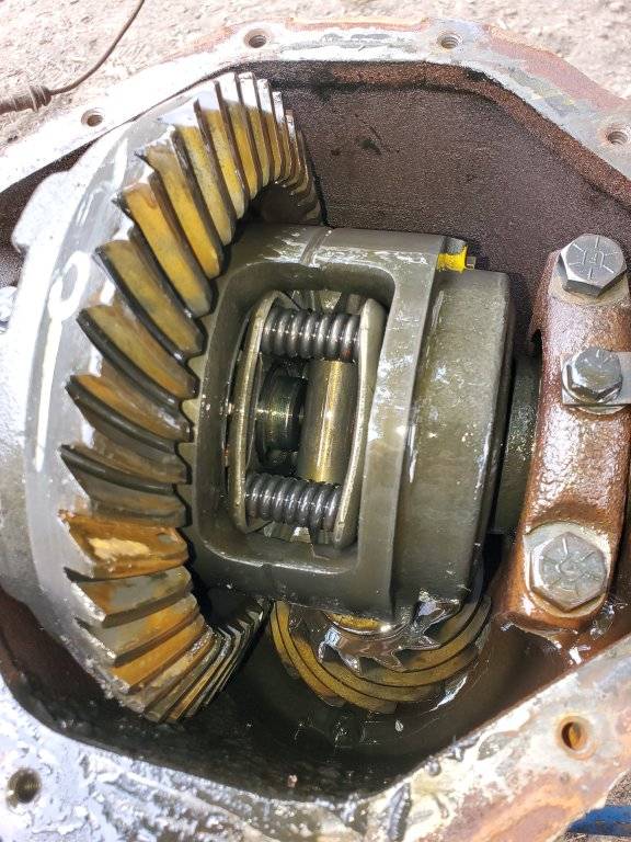

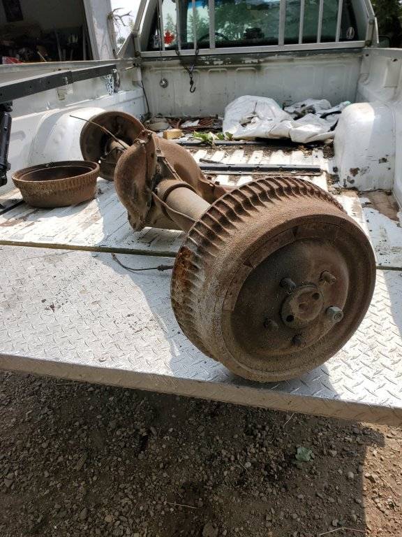

Found a diff tonight. Out of a C body. One inch wider between backing plates and half inch wider on spring plates.
3:23 geared 8 3/4 Limited Slip.
Wait, I looked at the diff.
8 3/4 don't have C clip axles and removable rear cover.
What the heck is it?
It's a perfect fit. But.....
No plans yet.

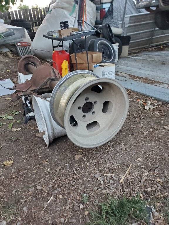

Next onto trying to figure out wheels.
I have 18" wheels and tires that the offset is wrong. I have 19" tires but no wheels and 14" wheels but no tires.
Lol
Well, diff is installed.
My 15" wheels stick out to far.
But the 18"s fit now. Need spacers for the front to clear tie rods.
