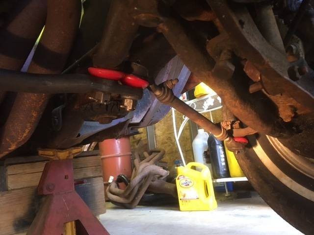

I can put a belly pan under it if I need more ET. Hey pomonamissel you ever watch those vids on YouTube of the southeast gasser associations. They have some pretty cool cars. I've seen em run a few times
