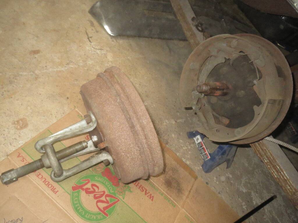

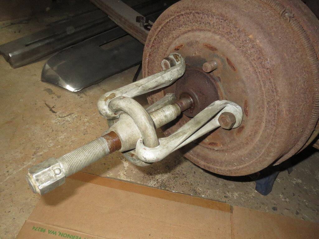

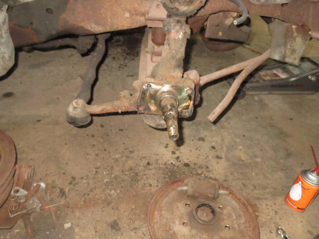

Put some Kroil on it last night, came in today, put the puller on, loaded it up with as much torque as I could give it, added more Kroil, walked away to mess with the fronts, came back a bit later to give it some gentle taps around the hub with a ball peen and they popped right off. The passenger side was a bit more stuck the driver’s side but they really came off quite easy. One thing I always practice on these old cars is patience.
