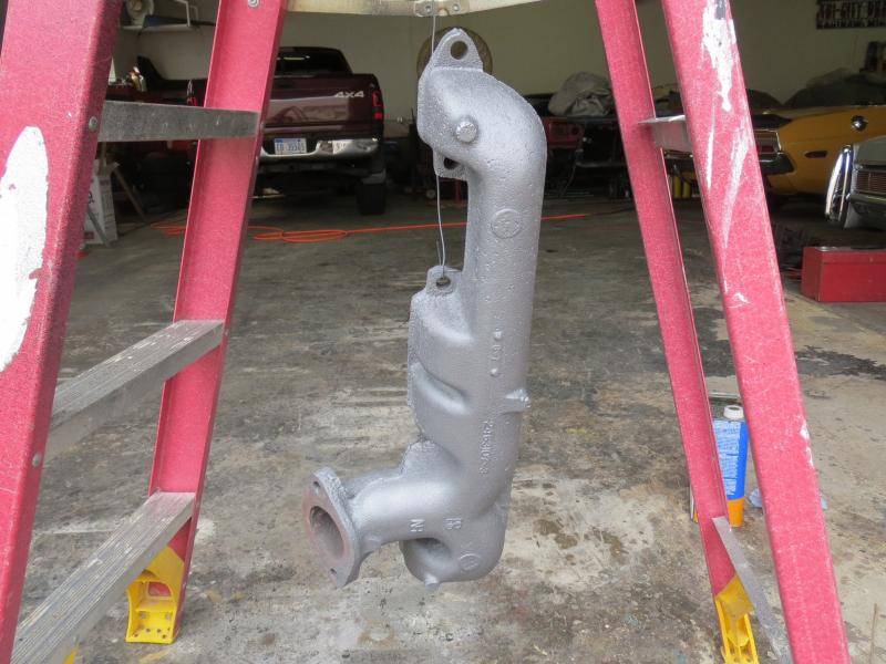

wouldnt be right putting dirty, rusty exhaust manifolds on this now would it?

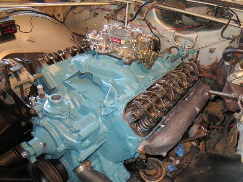

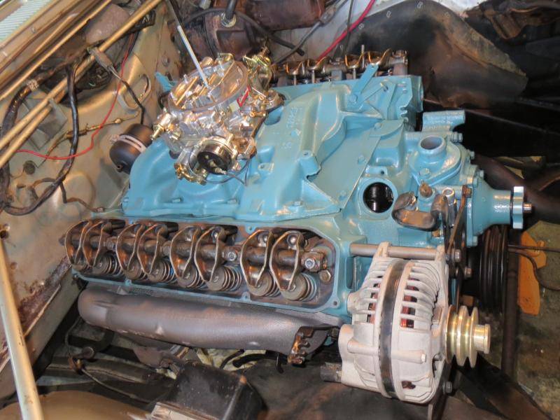

in the spirit of giving credit where credit is due(and swallowing a bit of pride) I just got a call out of the blue from Newp who has been following along and saw that I had installed my rocker assemblies. He just wanted to make sure that I had installed the shafts properly so that they were directing oil like they should. I was careful to be sure that the oil passages for the rockers were facing down but didn't take the time to check the fsm to make sure that that they were oriented properly as far as being 15 degrees off centerline of the shaft bolts. I had in fact installed at least one of them improperly which would have caused me some problems down the road. I am now going to go pull the other side back off and check them as well. He also informed me that these one year only pushrods may not work with the new tappets and that I may need to replace these as well.
All I have to say is thanks Mike! You potentially saved me some time, money and aggravation that I would have likely experienced sometime after I got back from Carlisle.
Acquired the correct pushrods, got exhaust manifolds back on and hooked up, fuel pump on, hung the alternator and got the vacuum canister behind the carb back on. Been restoring all the parts as I go.
