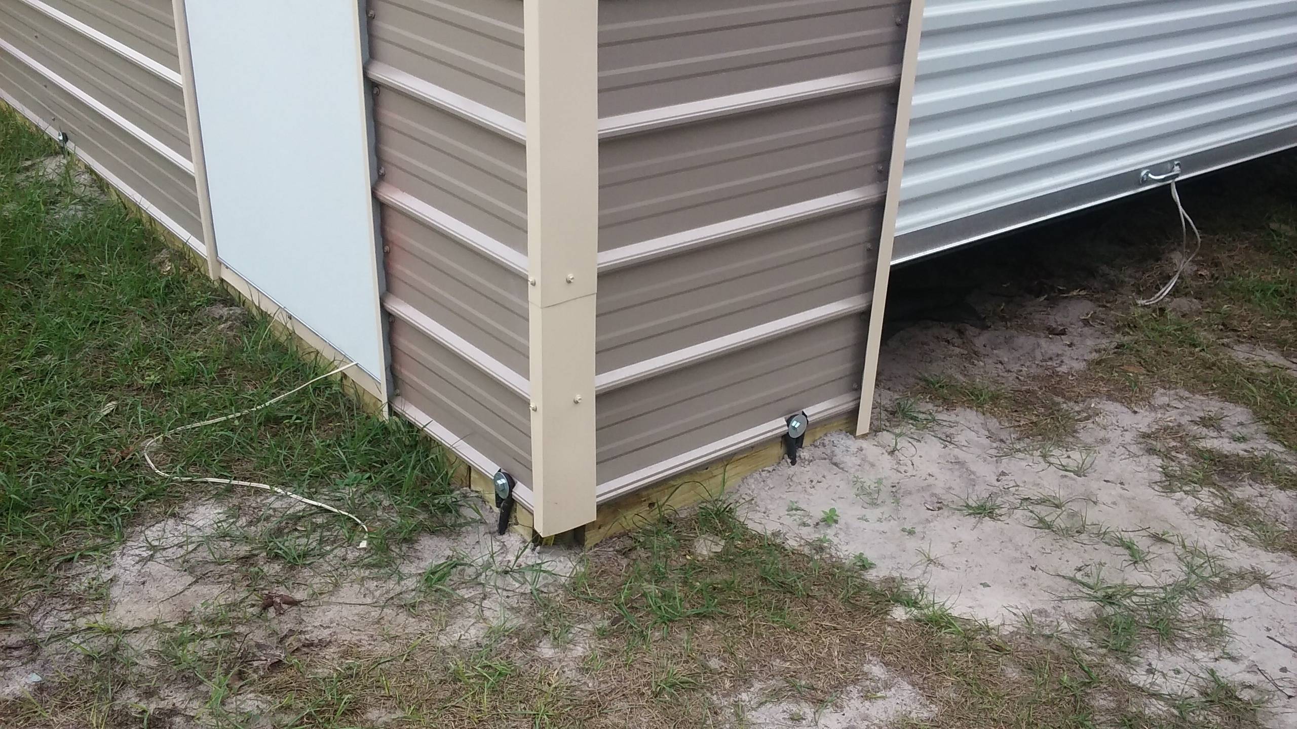

Here is a pic of the soil anchors installed. They are what's used to hold down mobile homes. They are driven in with a 1/2" right angle drill.
The company I bought the building from would only give me a $500.00 discount to just buy the materials. Up north, you can buy pole barn or garage kits at any lumber store, not in sunny backwards *** FL.
As it turns out, best $500 ever spent. 3 guys showed up at 7am with a Dodge dually and a 40ish foot 5th wheel. They literally RAN back and forth unloading and flipping up arches.
I had the ground prepped and the 4x4s laid out.
It took 8 hours to put up the garage start to finish.
I tipped the job leader a couple bills before he started, and told him I'm picky, and wanted everything square, level and right. He was the only one who could speak english.
