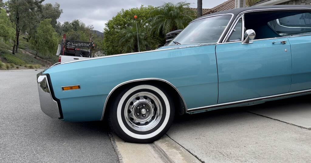

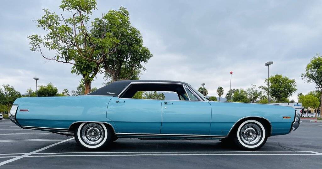

I like these, I know there not original but mine are American classic 235/75/15 1.6’ WW
With mopar Rallye wheels. :D
How much did each American Classic tire cost - my impression is that they are very expensive............................??
There not cheap, around $200 per tire. Wish they cost less but I don’t mind paying alittle more for a quality tire.

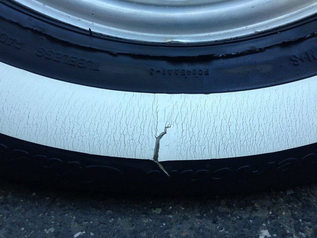

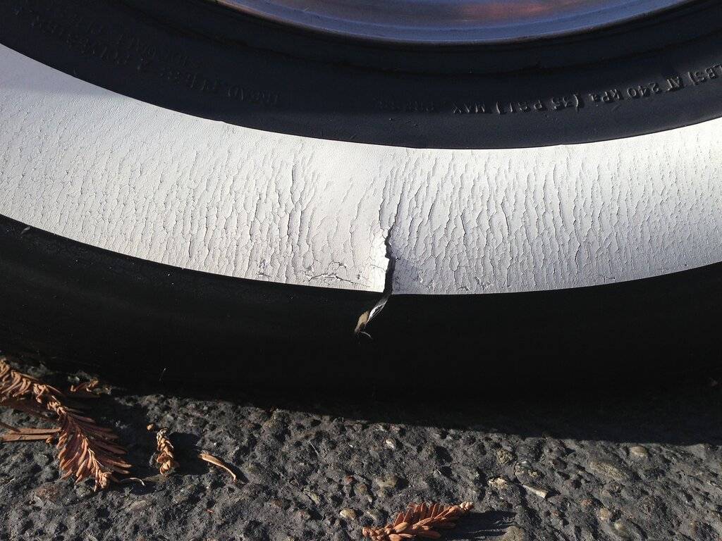

Heads up though, I had deep sidewall cracking in the white rubber after about a year. I got Lucas tire (the dealer) to replace a couple but then they quit doing it and blamed me for the cracks. Use very gentle cleaning methods and keep them out of the sun. No tire foam or Armour-all....only 303 or anything without the bad stuff.

The tires above were under daily driver conditions, for the record. They cracked after about a year and 10k miles. Non-garaged.
I had similar whitewalls on an '85 Eldorado but in the P215 size and they were fine, from what I recall (15 years ago).
Regardless, these tires rode fine and handled well. I think the cracking was a material failure. It always started in the white rubber, which was about 1/4" thick at the exposed WW section, but then the crack eventually crept into the black rubber below. The sidewalls flexed a lot in this application.
What is the load rating of the American Classic tires? Maybe a combination of low quality materials and low load rating for an Imperials weight.

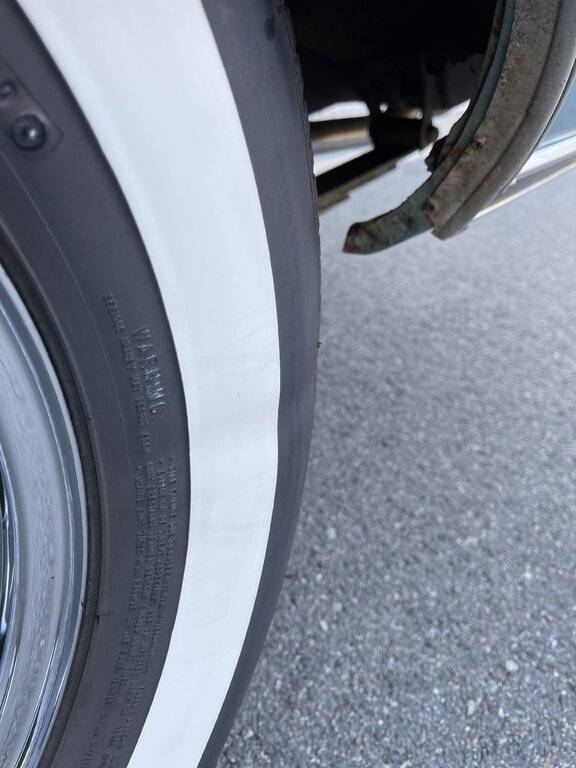

I’ve been using American classics for years, good so far. (cross my fingers) Only thing if I had to crit is that this particular set on my Newport show some tire dents or what they call tire undulations, they say it’s normal coming from radial tire construction but I don’t like how it. From my understanding if they dent
inward it does not affect performance, but if it’s a protrusion like a spiny looking bump or bubble then that tire needs replaced
