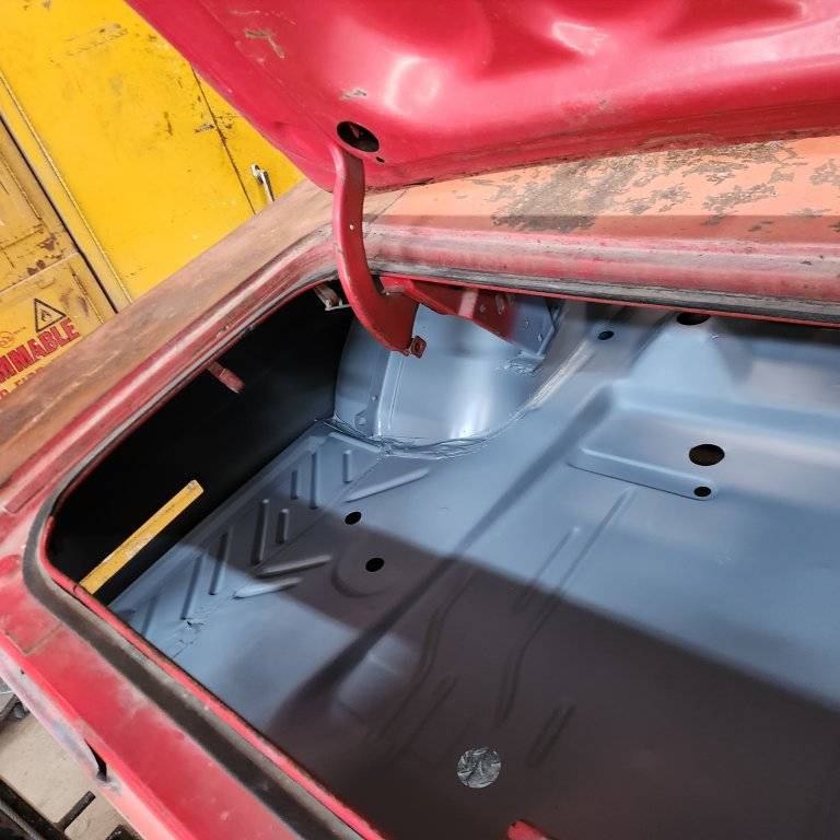

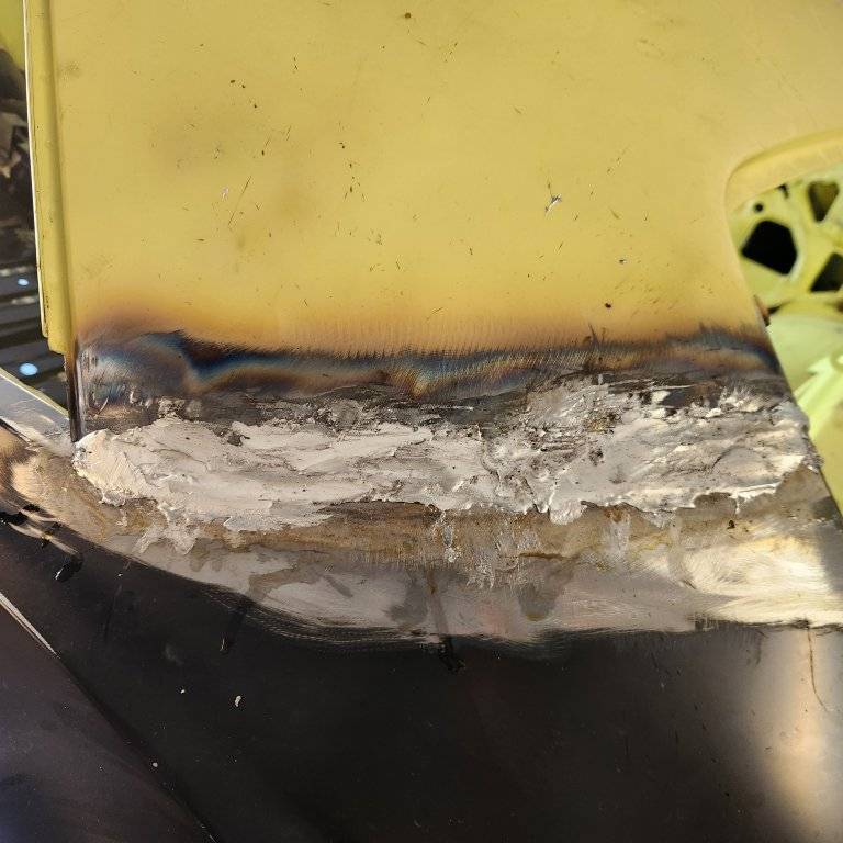

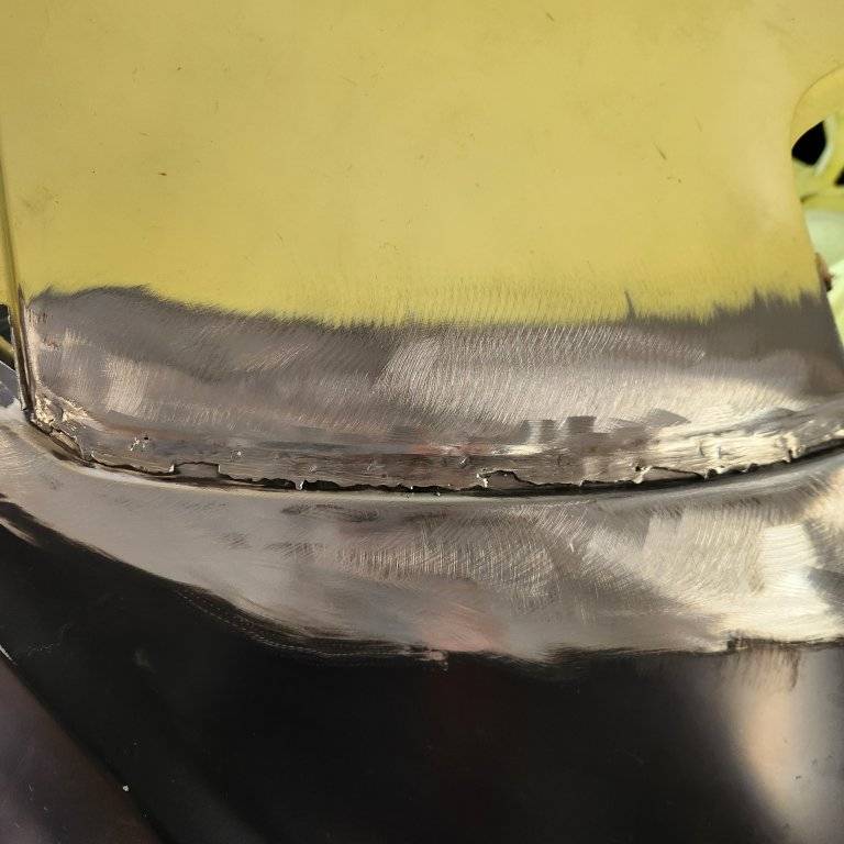

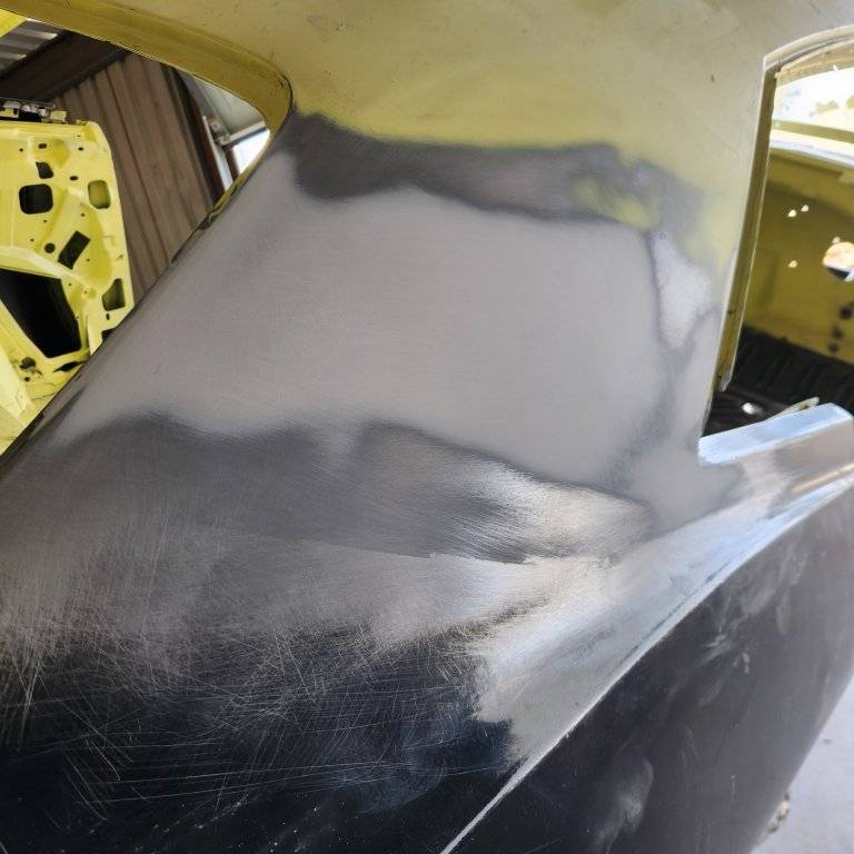

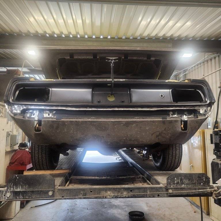

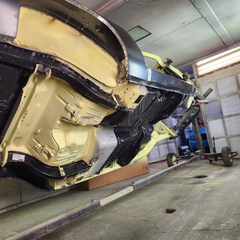

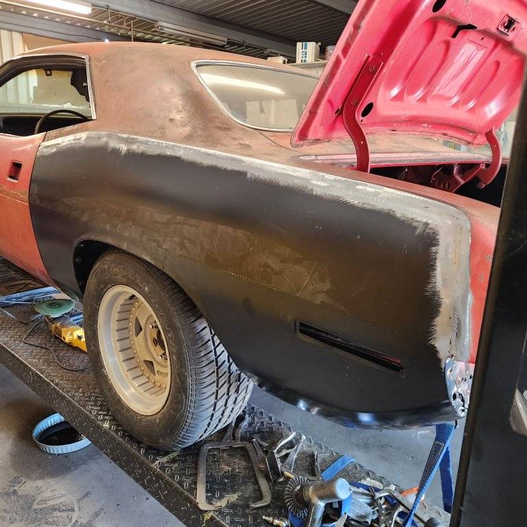

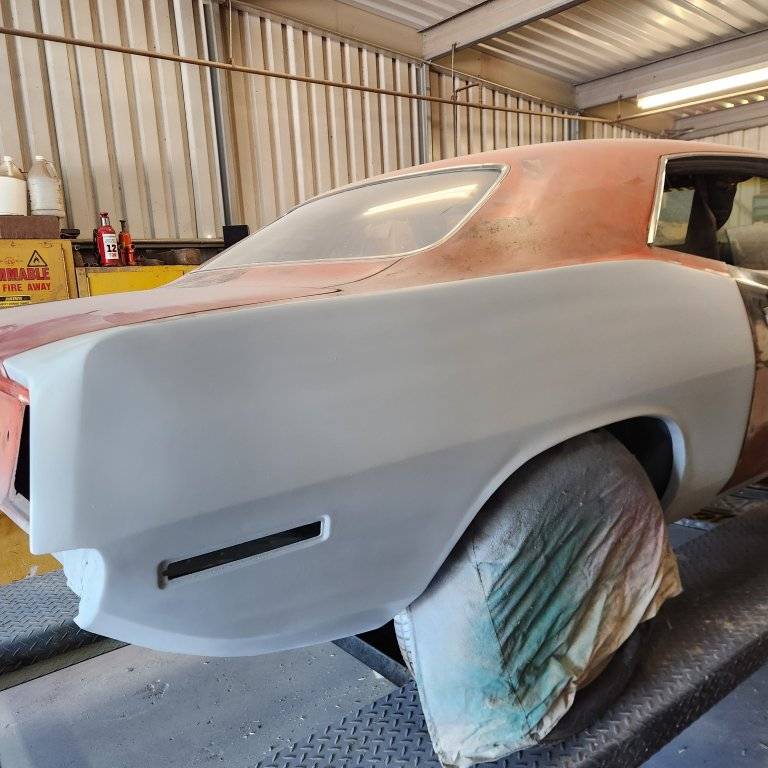

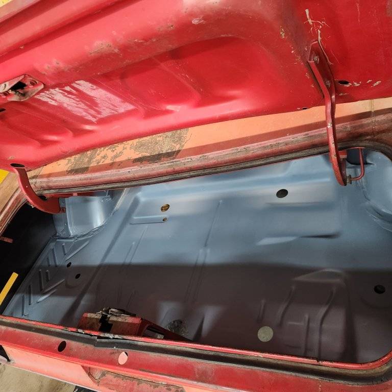

Haven't updated in awhile so here goes. All the rear end sheet metal done. Inside trunk compartment primed and caulked. Next step is moving to springs inward to allow for wider tires. He got me a kit from US Cartool for it. I'll post pictures when I get started on that.

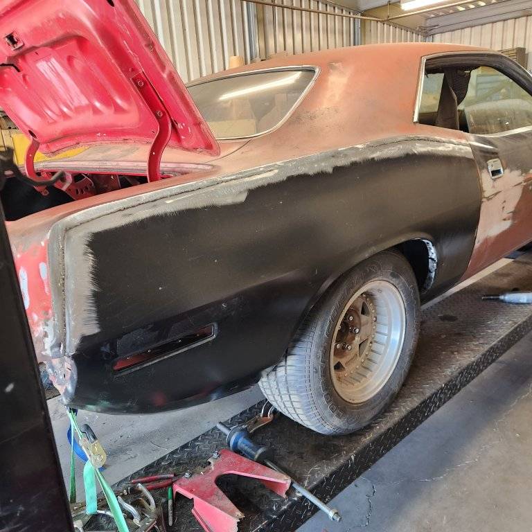

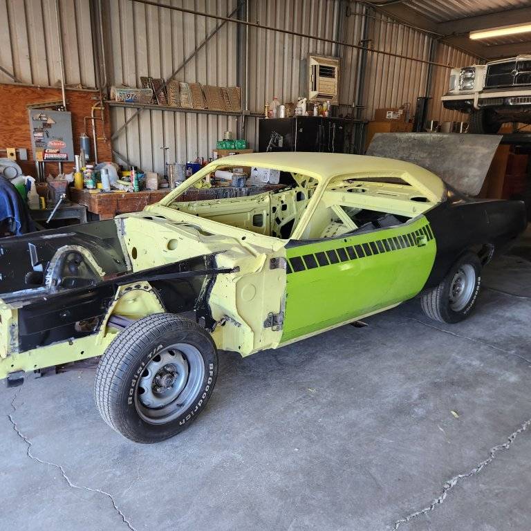

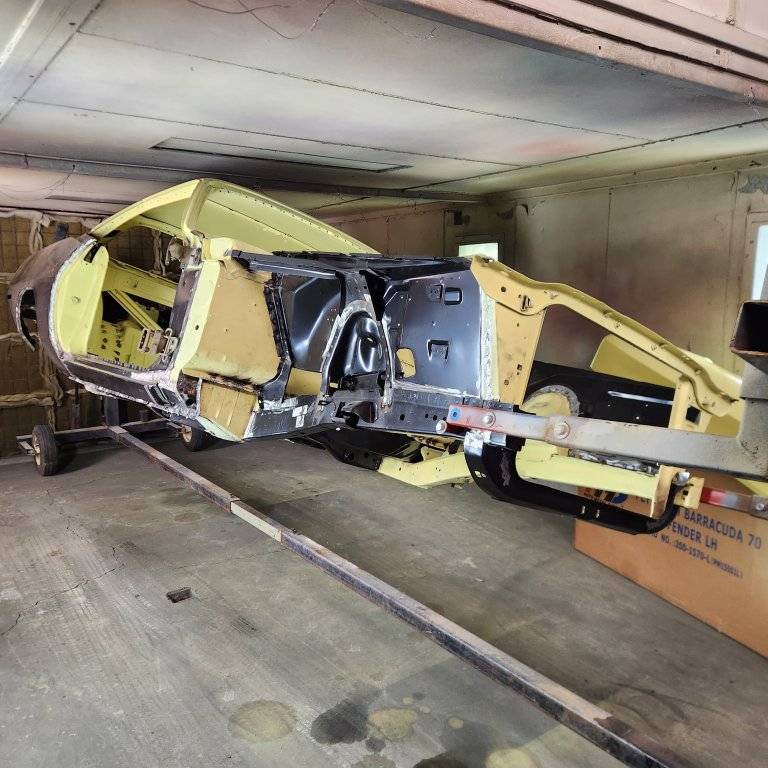

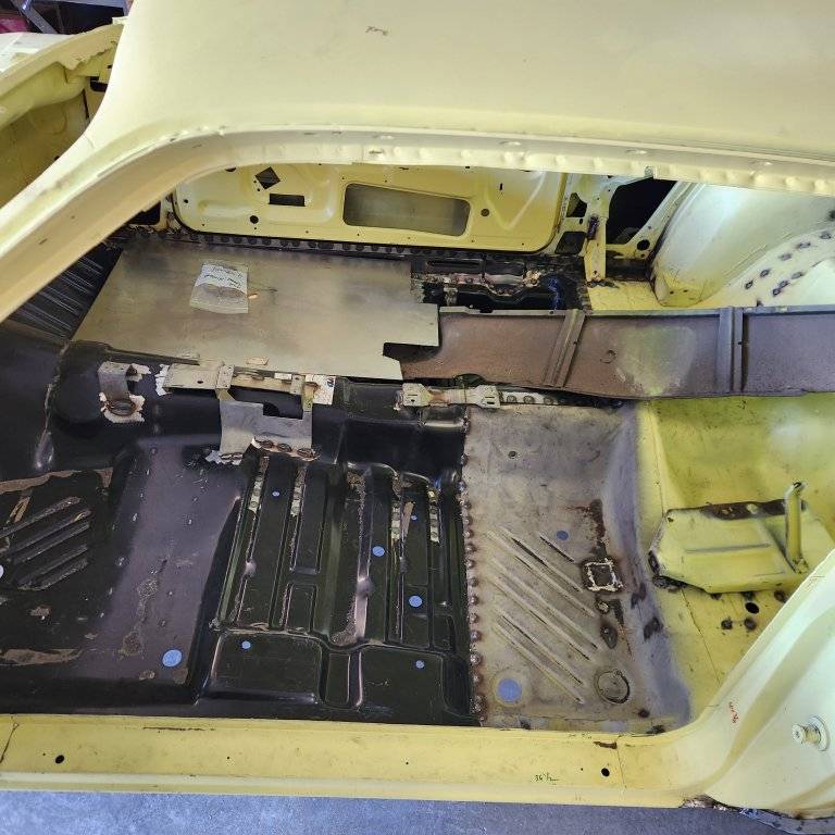

Almost done with Medina so here's my next one. Another E body. 70 AAR cuda. Had extensive sheet metal replacement at a local frame and unibody shop. Car was T-boned back in the 80's and not repaired well at all. Going back to the original Sublime color.

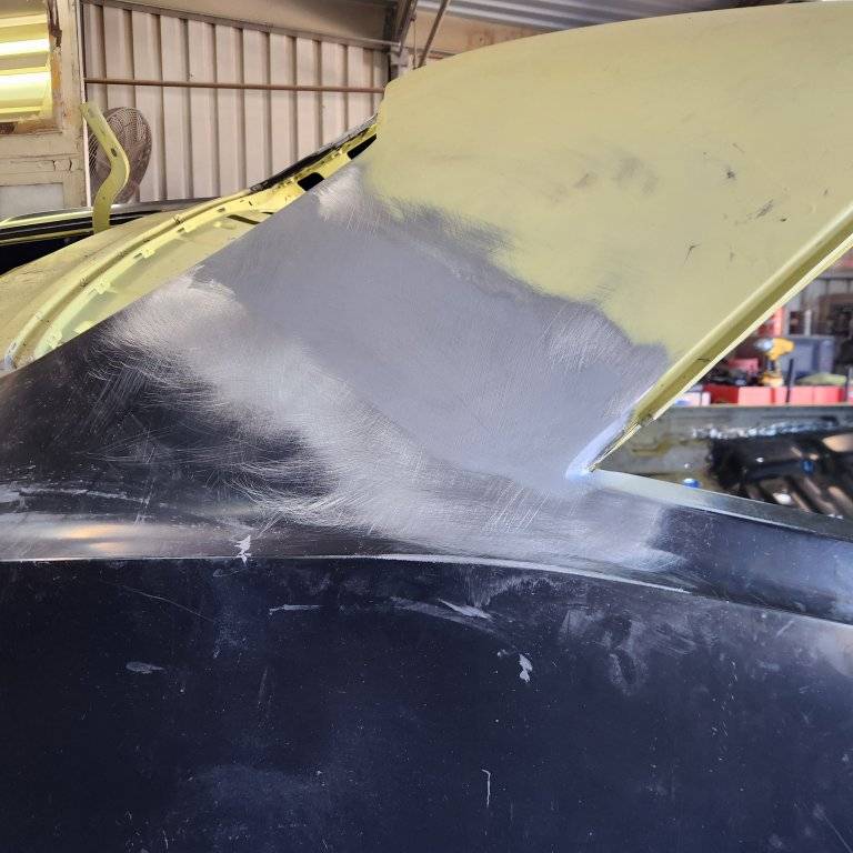

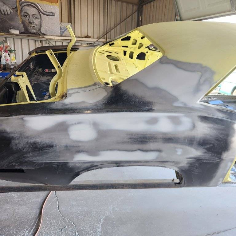

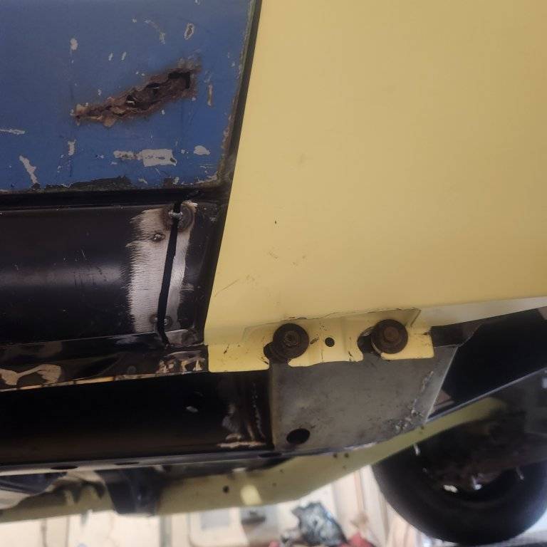

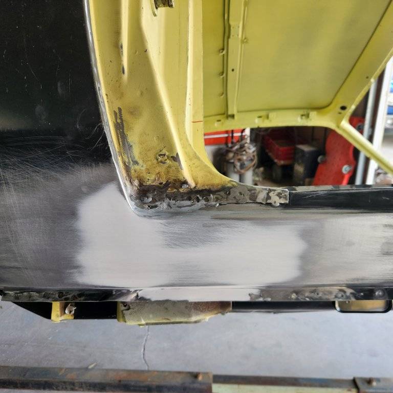

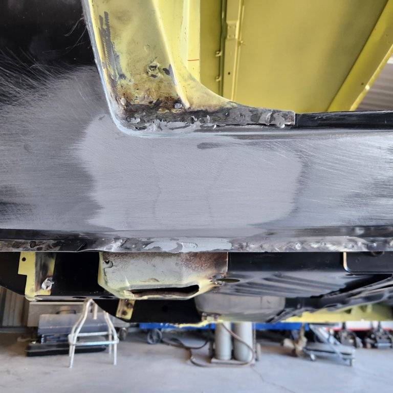

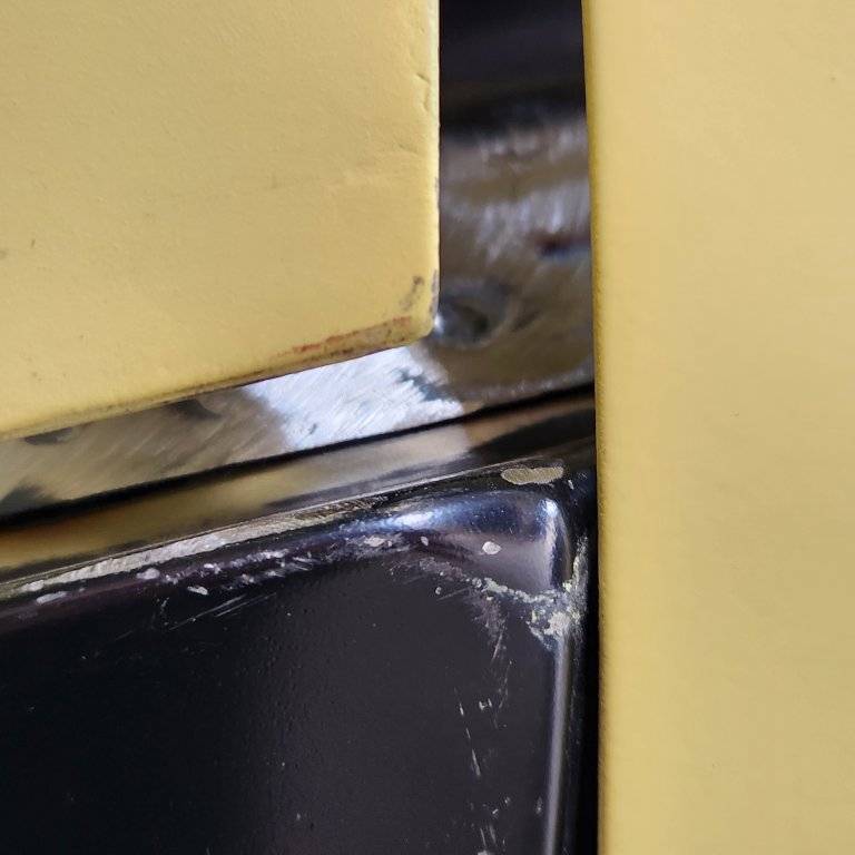

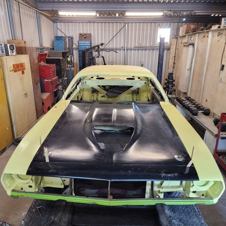

Test fitting all the sheet metal since so much was replaced. Glad I did because I found a serious problem with the right side rocker panel. Seem to be a quarter inch too far forward which messes up the lower door to fender gap. Since I'll have to cut and reweld the rocker I'm glad to find it now instead of after it's painted.

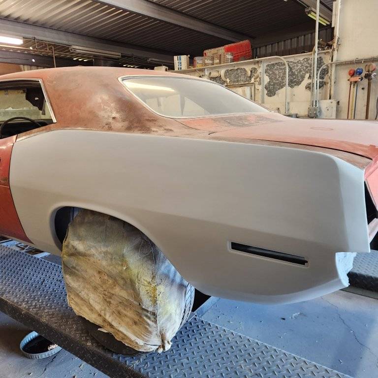

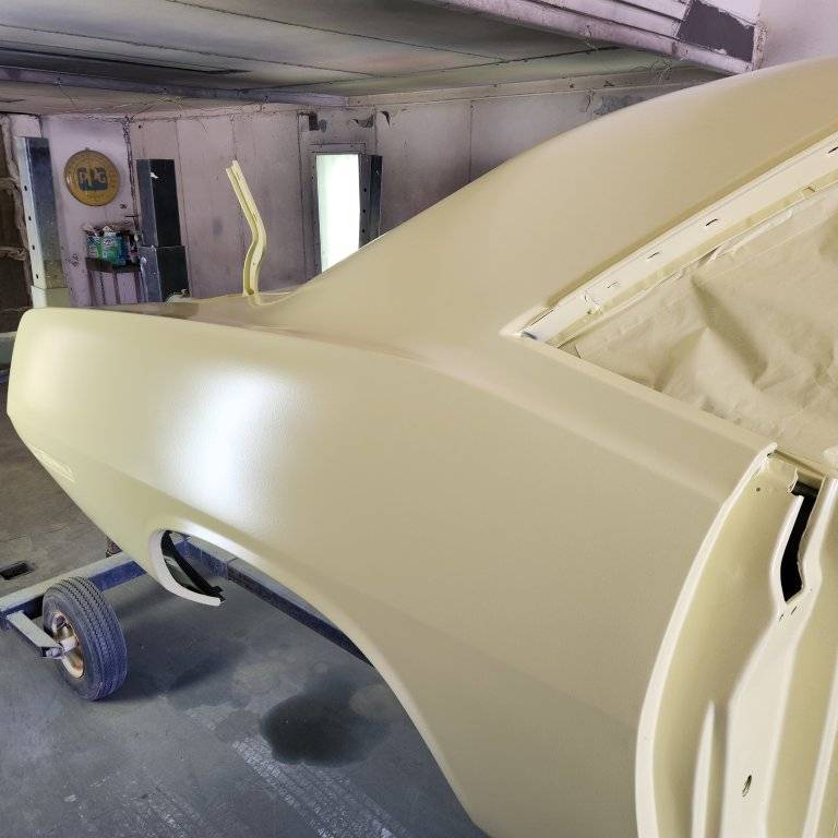

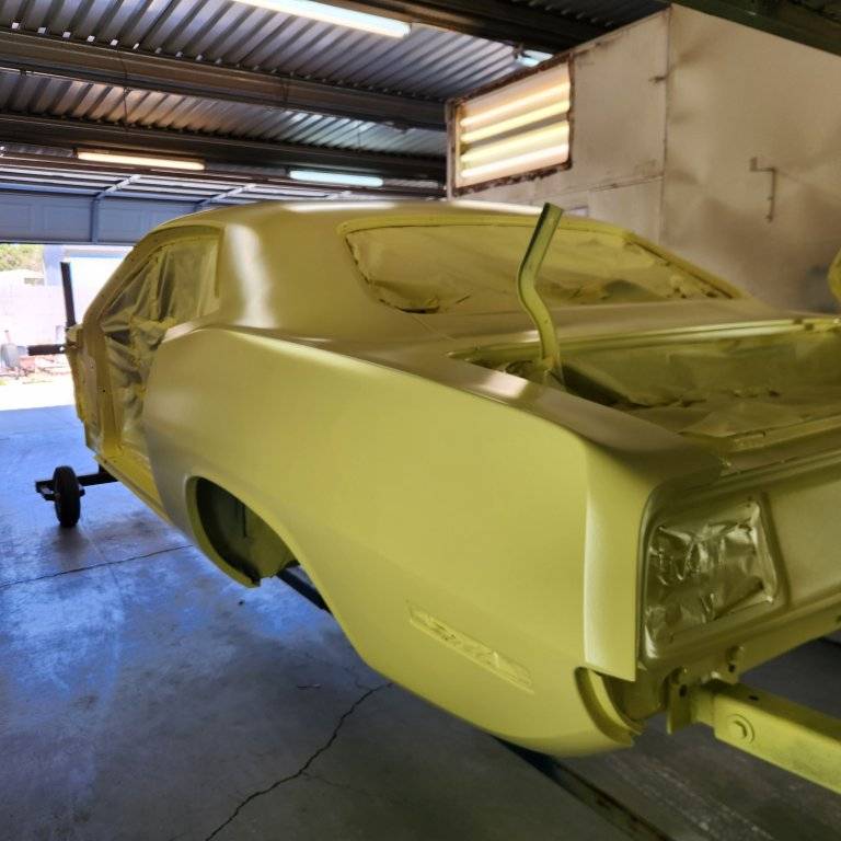

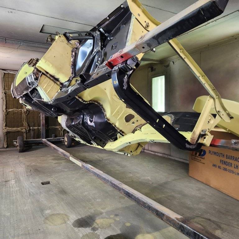

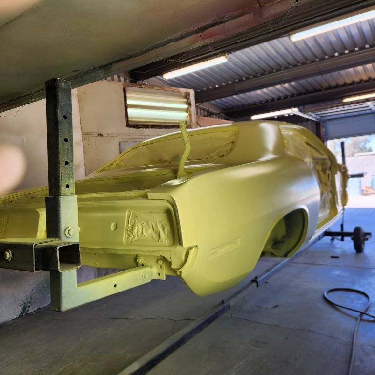

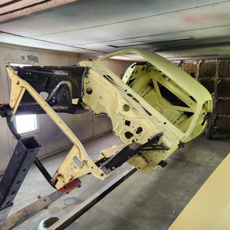

Yellow primer...

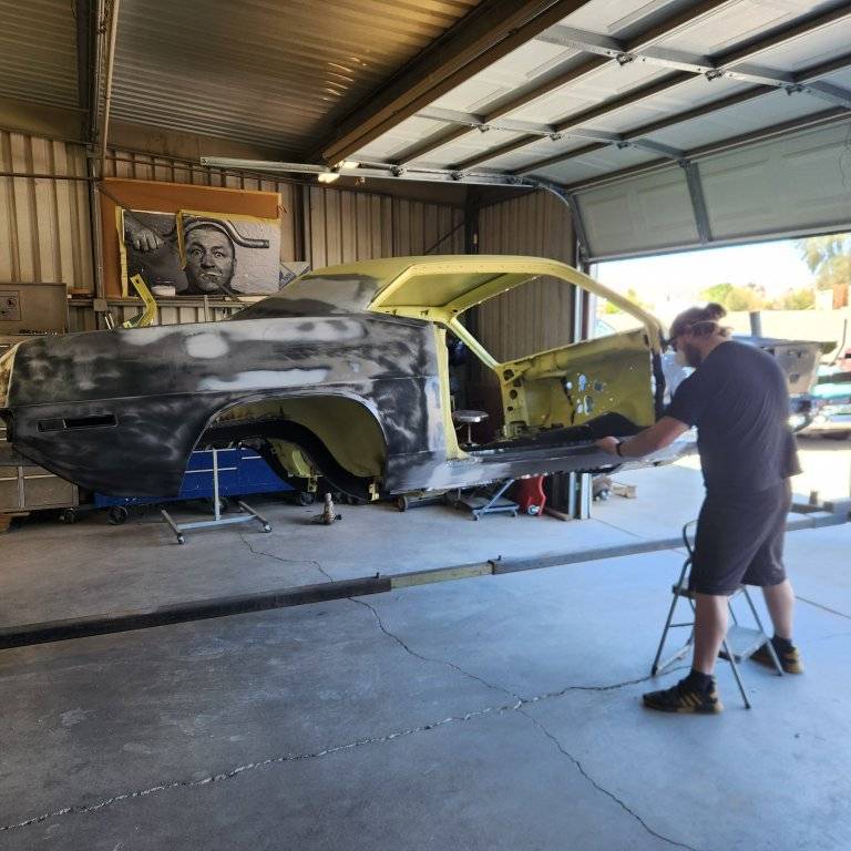

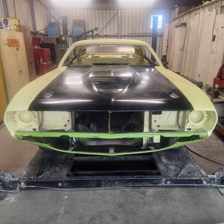

That doesn't look like you in the first picture.

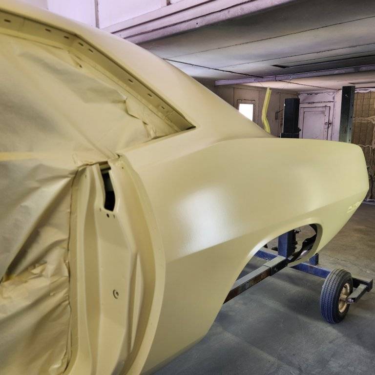

Yes the yellow primer is Squeeges epoxy primer. Great stuff. Direct to metal, very high build with no shrinkage. Also reduced can be used as a sealer. And yes the first picture is my oldest Grandson. He's helping me on his days off and late start days. His being here is really helping too! The second picture is me though.
