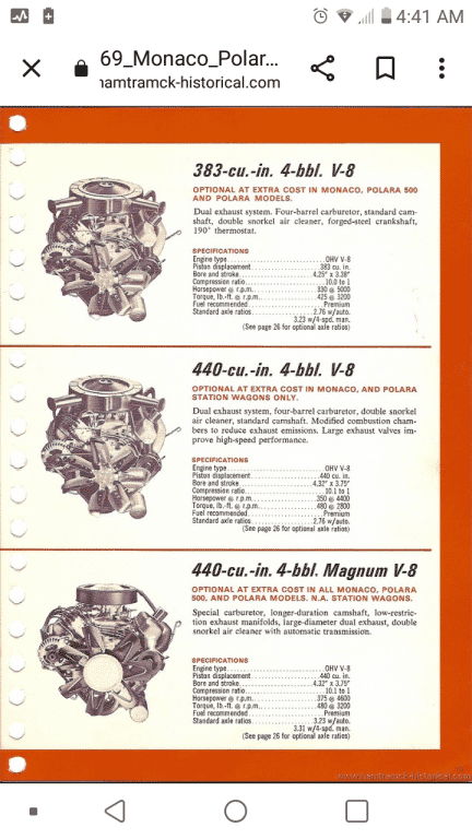

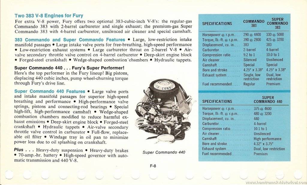

I noticed the brochure shows the unsilenced air cleaner, while the text stated a double snorkel unit.
Same picture used as the Charger brochure.
Also shown, but listed, in the '69 Plymouth fury brochure.
Interesting, the Dodge one as well, looks like on the Dodge it has Dual Snorkels with automatic transmissions. 440 in a 69 C-body could only have an automatic. Stock pictures.
Again, Canadian may be different.
Alan
The 69 golden sport fury with the orig 440 super commando from a member here does have a unsilence aircleaner iiac.......?!
So maybe it,s a plymouth thing...

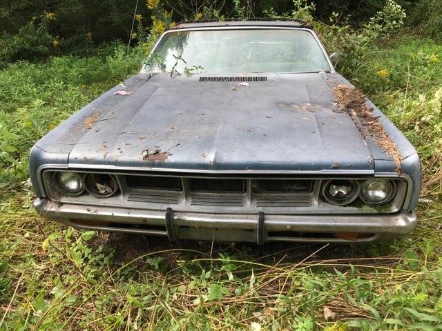

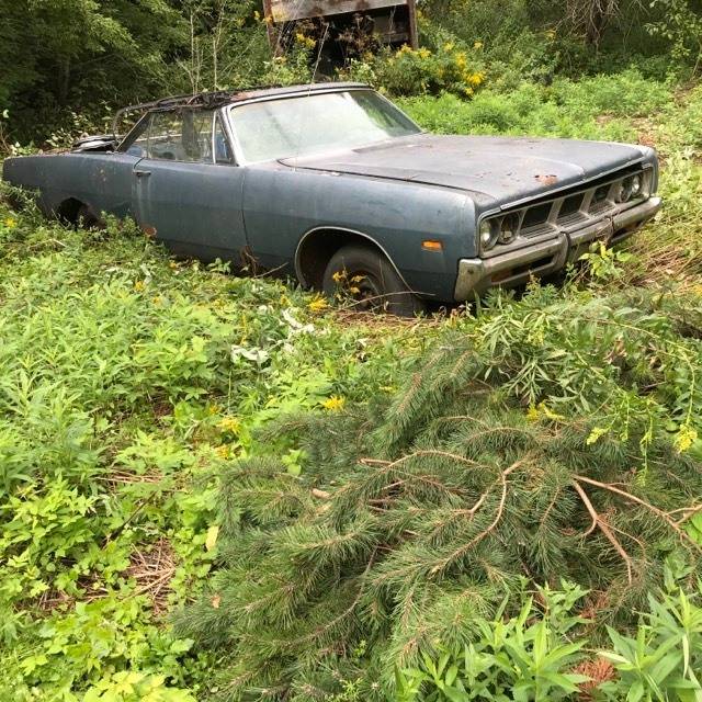

I went to check out this Monaco today!! 318 car. Oh my what a mess but does have some decent parts, especially convertible trim, bumpers, hood, grille, etc, etc. Has blue interior buckets console. Shocked that the windsheild is not cracked at all. I can buy the whole car for cheap so I probably will and strip what I can. You can see in the 1st pic what I was up against. I had to trample everything around the car to see it. LOL!
