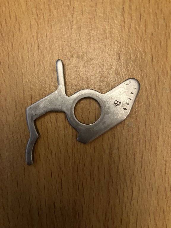

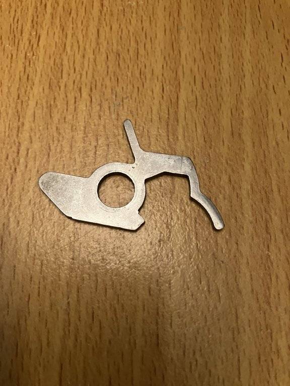

Hello everyone,
My 1971 New Yorker has had its 4966S Carter removed due to age and some mechanical repairs being done on other areas also.
I took the linkages and air horn off the carb for inspection and cleaning. With the help of pictures from a rebuild kit, internet info etc I have been able to reassemble 95% of the unit, however the piece in the picture has me stumped. I can’t see it in any pictures of similar Carter/Edelbrock units, despite looking at about 30 different pics and angles. Any ideas where it goes. The hole matches up well with a similar sized one below the choke lever/shaft point, and looks like it has an identification of 3A439, but some wear has occurred so this may only be a guide. As always, all input is very much appreciated.

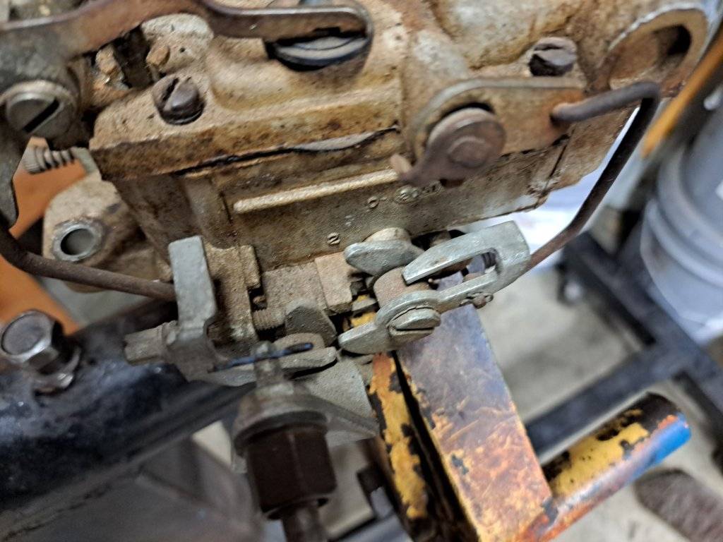

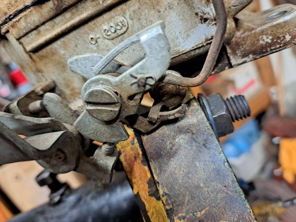

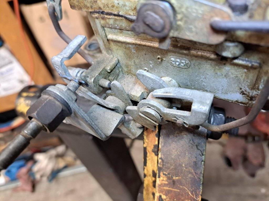

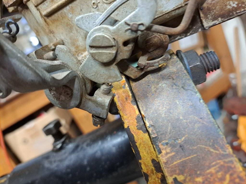

That part locks out the secondary carb linkage w/ the choke activated. Its located behind the fast idle cam.
A very big THANK YOU to Vaanth and David Hill for their replies and pictures. That has immediately solved my carby rebuild angst.
