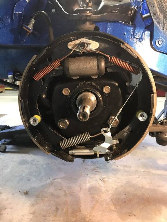

My right front brake grabs periodically when not even braking, I pulled off the front wheel and the front shoe would not retract all the way ? I replaced the wheel cylinder and it’s better but still does it ? My spring looks ok but maybe it’s not strong enough ? Any advice is appreciated.

Start by replacing both front brake hoses. The inner lining sometimes separates and blocks the brake fluid from returning. This will cause the wheel cylinder to stick in the deployed position. Some other causes could be grooves worn in the brake backing plate, this can cause the brake shoe to hang up if the wear groove is deep enough. If you have replaced the master cylinder, be sure that the travel rod is properly adjusted. A travel rod that is set too long prevents the piston in the master cylinder from retracting properly, this will cause a blockage that prevents fluid from returning. The test for this condition is to crack the bleeder screw on the affected wheel cylinder, if it retracts, the travel rod is probably set too ling. Check the front wheel bearing adjustment, if it is set too loose the brake drum will wobble and also cause braking issues. Finally, where the brake shoes contact the backing plates should have a small amount of white grease applied to the mount tabs. The tabs are small bumps that protrude from the backing plate and contact the side of the shoes. A little grease keeps the shoes from hanging up, especially if the tabs are rusted. If you have not already done so, down load the factory FSM at www.mymopar.com it is free and covers various adjustments to the braking system.

are the bumps on the backing plates that the shoes slide on smooth and lubed?
I'm not used to seeing back-up auto adjusters on the front. My 11x3 inch fronts only have a spring across the adjuster firmly holding the shoes together and then manually adjust
Also, kinda remember different color top springs (one being green), ?different tension to pull in the piston?
Self-adjusting brakes came out between 1962-1964. Every vehicle I personally have owned or worked on that was from that vintage and newer, came equipped with self-adjusting brakes. And I agree with the previous comments about the rubber brake hoses. If they are original to the car, replace them.
True enough, but typically 3-inch brakes (up until 1968 or so) did not use automatic adjusters - or so I've been told... but the odd time one will find some 3" brake systems were equipped... like mine.
What I can't find is an option code on a fender tag for adjusters on 3 inch brake systems...
A total guess here. Are the shoes on correctly? one has more surface area than the other. They could be swapped. I don't remember if the larger shoe goes in front or not. I swapped to disk brakes years ago so my memory is rusty.
This is just a guess but something doesn't look right with the lower spring. Isn't it supposed to hook on the peg that sticks out from the shoe just above the adjuster tip on the RHS..?
