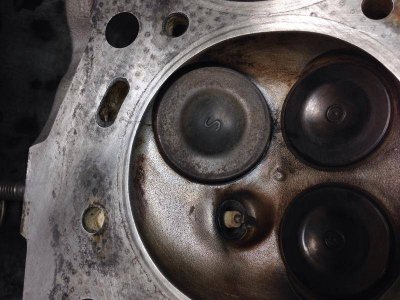

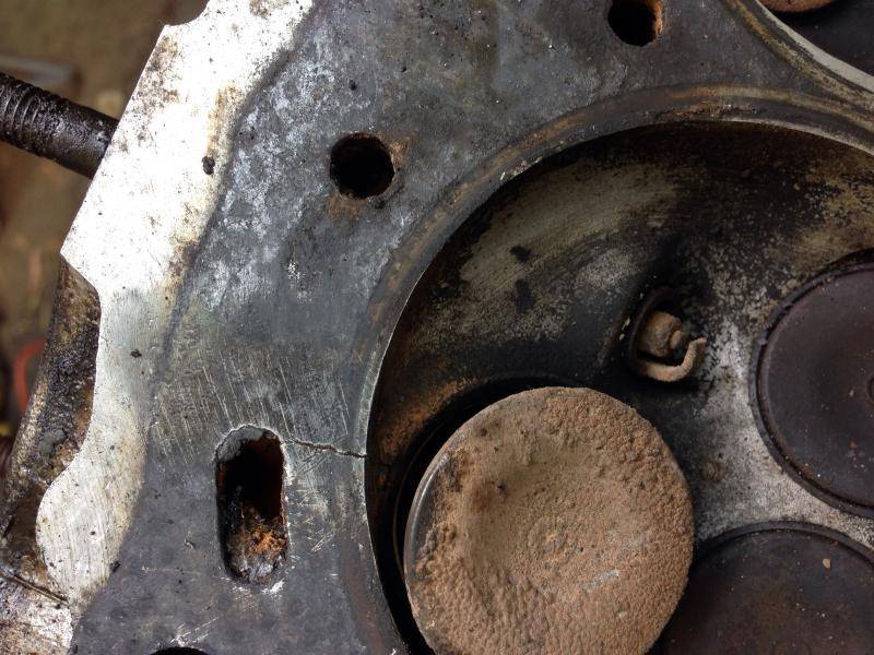

Working on my son's Honda Prelude (again!). He overheated and warped and cracked the head. The crack is pretty severe it runs through from the exhaust valve to the water jacket. image.jpg I went out and found a used one. It's not warped, but after a thorough cleaning I noticed a small crack in the same spot, although it does not appear to go through to the water jacket.
Do I just go ahead and install anyway, or is this doomed for failure? I only need another year out of this car, but I'm thinking now it's headed for the scrap yard with a new clutch, flywheel, axels, brakes and radiator....
I'd get a good used head from picknpull or your local equivalent. I would not mess with reinstalling, or trying to repair it. There's a good chance it's warped now also.
Yeah, this was the "good used" one. This one was $100, the reconditioned ones go for about $350. The radio is worth more than the car at this point. Indeed, everyone who loves thier Hondas only keep them until the lease expires. I keep telling him, no more rubber band powered cars!

Like it or not, Honda builds some of the best cars ever built. I bought a Pilot in 2005. Over 200k miles with only general service. Most reliable vehicle I have ever owned. I would buy a decent head & go with it. Resale wise, you'll get your money back vs just a pile of parts/scrap. The head you have will let go 10 minutes after you put it back together.

X2. I'll be there's a lot more cracks you can't see. If you've got that much into new parts on the car, get a reconditioned used head and get some value outta the car before you scrap it for good.

Have your head welded and rebuilt if a shop says they can't do it, hang up call the next one, if you were local here I know exactly where to send you. The good shops are out there you just have to find them, a properly welded aluminum head will never crack in that spot again.

Thnaks Dave, that's what I've been reading. I'm brining it in for an estimate to the same place Gary (Nport70) brought his heads for rebuild, the Engine Shop in Collingsdale PA. A reconditioned head would run $350, probably should have just spent the cash for one up front!
I have learned from these big trucks always rebuild your stuff buying used and reman swapout parts always comes back to haunt me at least I know what my junk has been through while I have had it. The guy locally here that I was referred to told me sure he could weld it and it will never crack again as I handed the head over that 2 years previous had come from a rebuilder. I thought he was just patting himself on the back, whatever. 6 mo. later my sister overheats the damn van warps the head, back off expecting to see same cracks..... Nope had it pressure tested to make sure, cut it flat back on again for a 4 year stint till the final drive came though the case, my dad finally had enough of that minivan.
Just got back from The Engine Shop, cool place they have there! $425 to repair and recondition the head. I got to thinking, we cooked that motor several times trying to resolve the overheating issue, I don't really know if there are internal issues that haven't been revealed yet. I've still got to talk to my son, but I think we are going to cut the losses and part/scrap this thing out.
