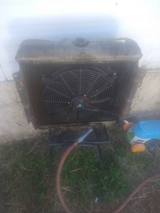

Ah hah! Radiator is mostly PLUGGED! Will try hosing the **** out of it. Motor running GREAT for a few minutes before getting hot. Let's try restoring COOLANT FLOW!

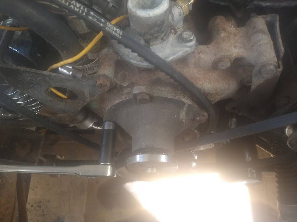

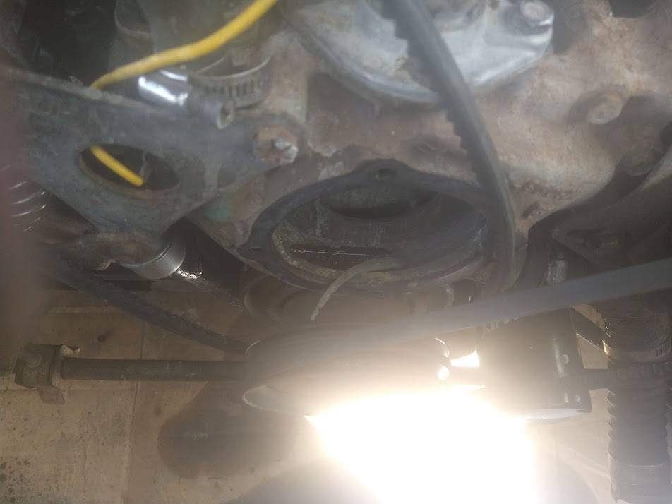

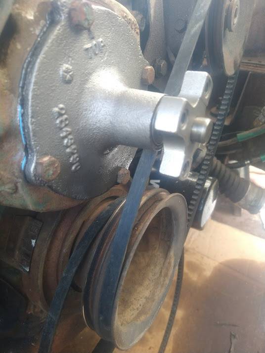

I cleaned out the radiator this afternoon, and replaced the water pump with one appropriate to this motor. Pix follow:
As mentioned, the radiator got a good enema. When it took over 1 minute to fill it, I called it DONE.

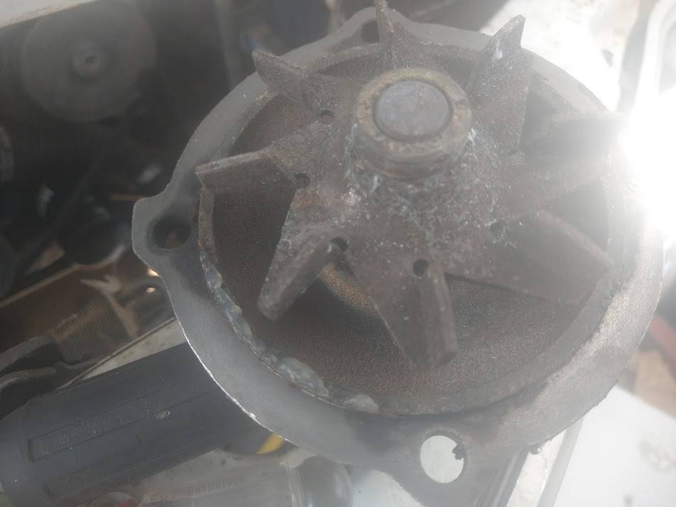

This is the coolant pump that came with the car. No-Name, AC motor type pump. It works, somewhat.View attachment 495440
Near Agua Prieta, quality automotive parts and supplies become a bit scarce, especially when brains are also. Note the generic window seal-
ant found loose in the bottom of this housing. I doubt if this enhanced flow. More of this window silicon remained on the pump body itself.
To give due credit here; there were NO LEAKS from this pump, even with a very aged paper gasket still on the housing. I scrubbed that with my fine steel wire brush in short order.
The replacement pump came from Carter, rebuilt during the early 1970s. Its the right sort for no AC.
I discovered this new RTV, shown below. A 90 minute CURE TIME sure makes things possible when you need them!

I am so glad for you... my contributions were few, and as to sanity... well, be careful slinging that word around here.It works. We can use the car tomorrow morning.

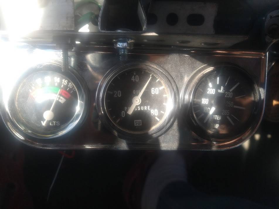

It WORKS! I ran her 14 minutes in the driveway, with temperature rising to but 208 F at the fast idle I stupidly had STUCK from the choke earlier. But it cooled itself with most of that little radiator now back in functional order!
IT WORKS!!! GRATIAS A SANCTUS IOSEPH, PATRONUS MECANICA!!!!!
I drove in a nice brass plug where I had used the rubber bung while rooting out and flushing the block. I like brass plugs with a tad of Indianhead Shellac on the rim. Stuff dries slow, but its OH SO TOUGH once it cures! Any plug I drive in gets Indianhead!
We'll have a Mass offered for you Jeff. We need you alive and sane when we buy old C-bodies! This makes your SECOND Morris Family Existential Crisis, which you provided the Key Solution to. The first was an oil pump pressure regulator, 5 years, seven months previous.
