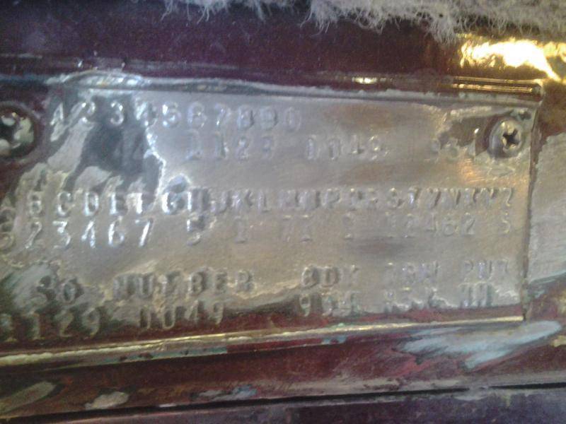

Without getting into the individual options shown under the A-Z second line, it says it is a '64 LeBaron, the 49th car made on Nov. 29, 1963. Interior black leather, exterior is Madison Gray (silver) if the letters under "PNT" are MM. If those are N, then it is Charcoal Gray. It is certainly NOT Silver Turquoise, which would be K. Either silver or gray with black leather and black vinyl top would be great combinations which are surprisingly uncommon in surviving 1964 Imperials. Having owned a '64 Imperial LeBaron for 36 years and wanting one for 50, I have only seen one in Madison gray and two in Charcoal Gray.
Wow, that's crazy! It must have been painted a few times then cause that turqouise is definately there, I just assumed it was the original color. Pnt is for sure mm, I'll for sure go with that then. Also, I'll retake that pic. Thanks for the info.
You know, I actually like that gray...allot. I mean its original, and the original color.
So letme ask you guys this, you said 49th built... is that 49 of 2949, or, just the 49th built that day?
Remember, the 300 letter cars and the Imperial were built on the same line, so I'm pretty sure that is the 49th car built that day, if that is indeed what that number represents.
Yes, by that time Imperial production was combined back with Chrysler at Jefferson Avenue, so that number shows nothing do do with the model of the car. (Imperial was given its own exclusive plant in Dearborn on Warren Ave for the 1959-1961 model years.) It was the 49th car off the line that day.
