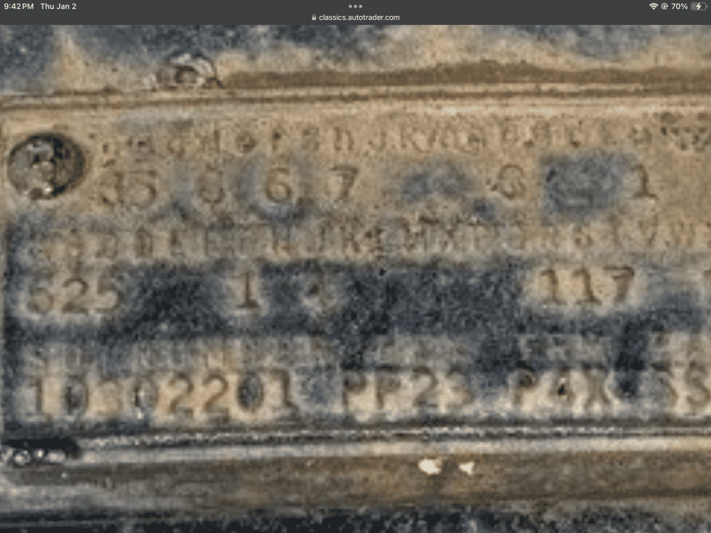

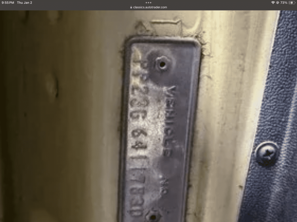

These numbers don’t match anything that I have been searching online for. The PP as the leading numbers is throwing me off, and even if you don’t start with PP the numbers don’t make sense. I didn’t try the fender tag because its hard for me to read and i have never decoded one. This is supposed to be a 67 Plymouth Sport Fury.
Vehicle ID PP23G64117830

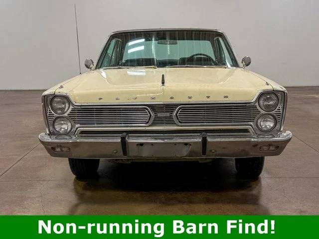

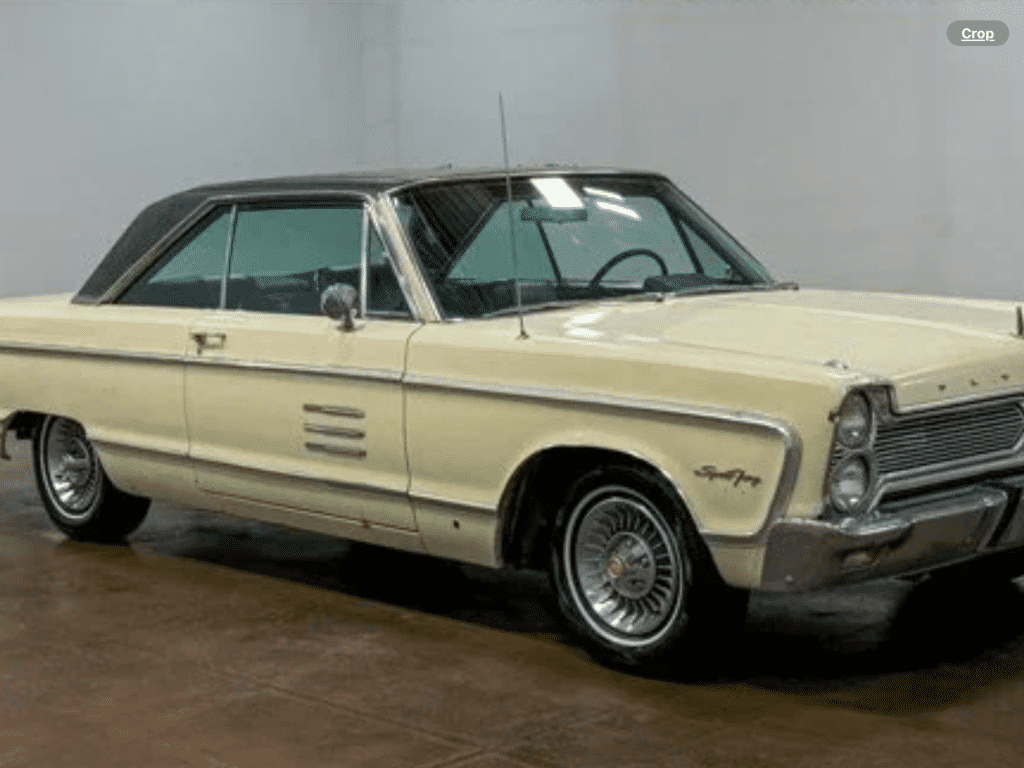

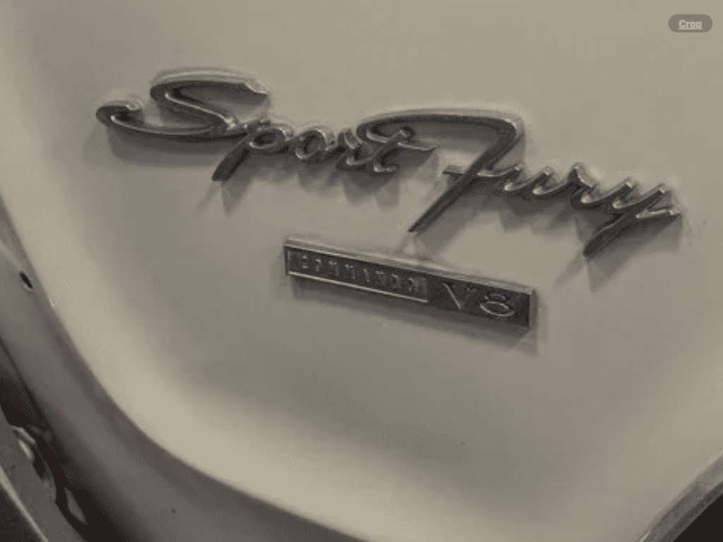

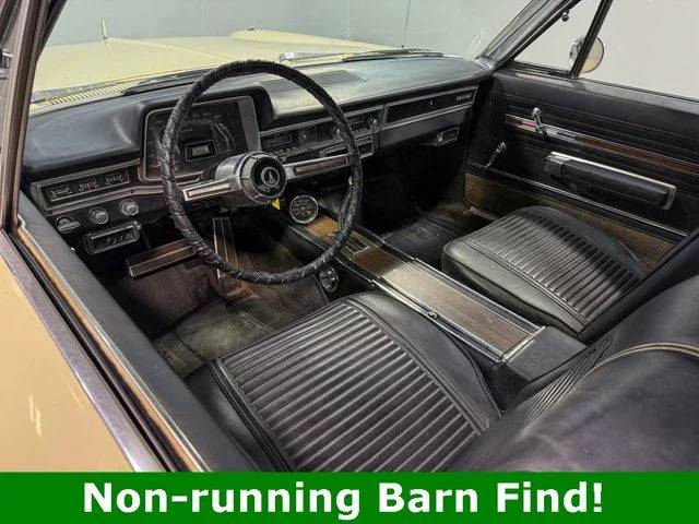

That car is NOT a ‘67, it is a ‘66. Normally “PP” is Plymouth Premium, and that would be a VIP model. The engine code “G” would be a 383 2 barrel. That tilt-tele steering is VERY rare too by the way. There are way more knowledgeable people on here that may correct me and ad their wisdom such as @fury fan or @FURYGT but this is what I know.

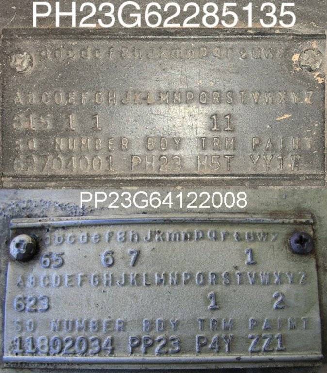

Definitely a 66 Sport Fury 2 door hardtop! Actually I believe the "625" on the left hand side of the second row of the tag indicates it's a 4 bbl. 62 is 4 bbl and 61 is 2 bbl. And the 5 is Torqueflite Automatic.
Model year 66 is a bit wonky when it comes to 383 coding. It's different than '67 and later coding. The letter G only tells us it's a 383. You have to look at the application and other factors to determine what carb it has.
In a C body, you have to look at things like the fender tag. 66 C bodies code G in the VIN for both the 61 (2bbl) and 62 (4bbl) assemblies. This car codes 62 so it was a 4bbl.
That is a nice looking car that cleaned-up nicely, on the outside and inside. What does it look like underneath? Agree, a 1966 for sure.

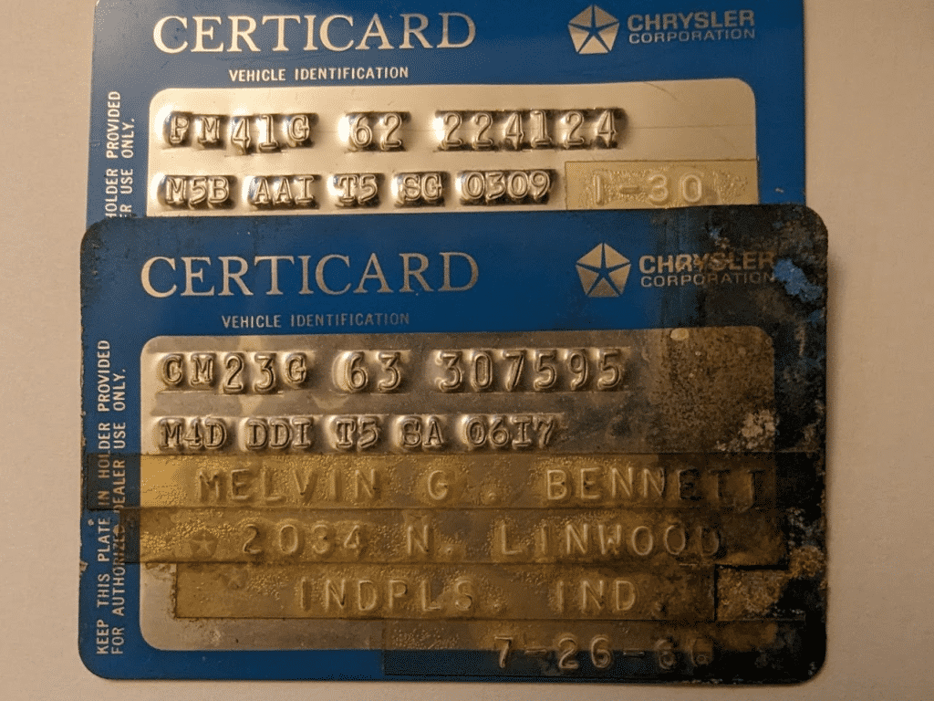

I just looked at the Certicard of the family car from my childhood, which was a '66 Fury II 4 dr sedan with 383-4, and it has G and 62.
And a 2nd card with G and 63. @69CoronetRT - what does 63 mean with a G in a chrysler? Is it the engine I mention below?

In that context, it means the year and plant at which the car was built. So 62 means 1966 model year (6) and Hamtramck plant (2). 63 = 1966 model year (6) and Jefferson plant (3).
To determine which engine the car received, we still have to look at other factors besides the G in the VIN.
So 62 is an engine code on teh window sticker, but 62 on the Certicard means something else.
