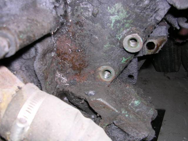

If your new block has the mounting bosses for the 65 style left motor mount you can just drill/tap them and it'll go right in. The pic shows the bosses on the front of the block just above the oil pump and you can see the standard 'ears' just behind.
MikeView attachment 49591
Thanks I had a buddy take the motor mount brackets off the motor and me being stupid didn't look at how they where bolted on and my buddy can take things apart and put something's together as long as you tell him what you want , anyway when I went to put the driver's side back on I thought that it bolted to the 3 ears on the side of the block and when I asked my buddy to show me how it was bolted on he couldn't remember ( didn't have a clue) LOL and that's ok cause it was my fault for not looking at it and getting ahead of my self .
I never thought that it bolted to the 2 bosses in the front of the block cause the motor that's going in has the bosses but there not drilled and the motor that came out of the car I already sold and the new owner already picked it up , what chaos LOL I thought the world was ending HAHA and the you guy's came to the rescue buy posting some link's and picture's.
Now all I have to do is drill and tap the hole's and the motor is ready to go in , Thank you very much guy's.

Please don't try it holding a hand drill....
I have no choice , I will let you no how it goes , I am pretty good with a hand drill I have had to drill lots over the years lol I was a welder/fitter for 35 years so I think this will be pretty easy nock on wood .
All done worked out great , cast iron is so easy to drill .
I'll take some pix tomorrow and post them and I will do a step by step write up for anyone else that has to do this , don't be afraid to do it it's very easy to do.
Yeah, it's really quite simple to do, hand drill or no. I do remember the first time I did it, my Dad was all kinds of worried I'd drill into the water jacket or an oil passage so I was extremely relieved when it worked just fine. Glad it worked out for you.
That a new one for me always wondered wtf those were for.
