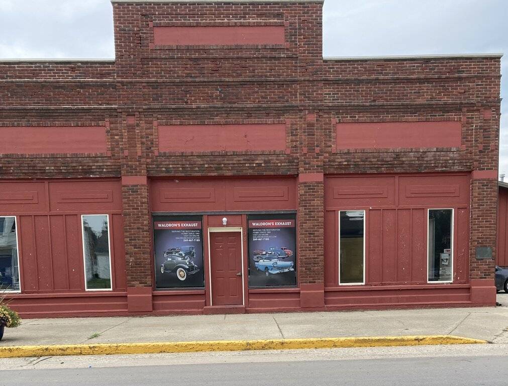

Where did you get all this? Was it a full kit?
Picked up my exhaust system myself. Made for a nice day trip this spring through farm country to this little town in southwest Michigan. Yeah, they are busy and only do factory exhaust systems. I.E. if your car came with single exhaust thats what they will make. If your manifolds are different for singles as opposed to duals they don’t custom fab.
