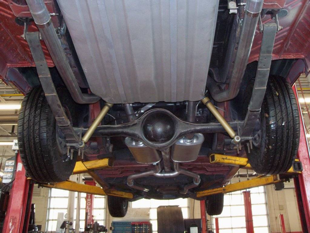

Personally, I don’t think the tti looks very good if cbarge’s red car is indicative of how their system fits. IMO, the tailpipes are too low, they shouldn’t be visible from the side. Carguy300’s system looks perfect.

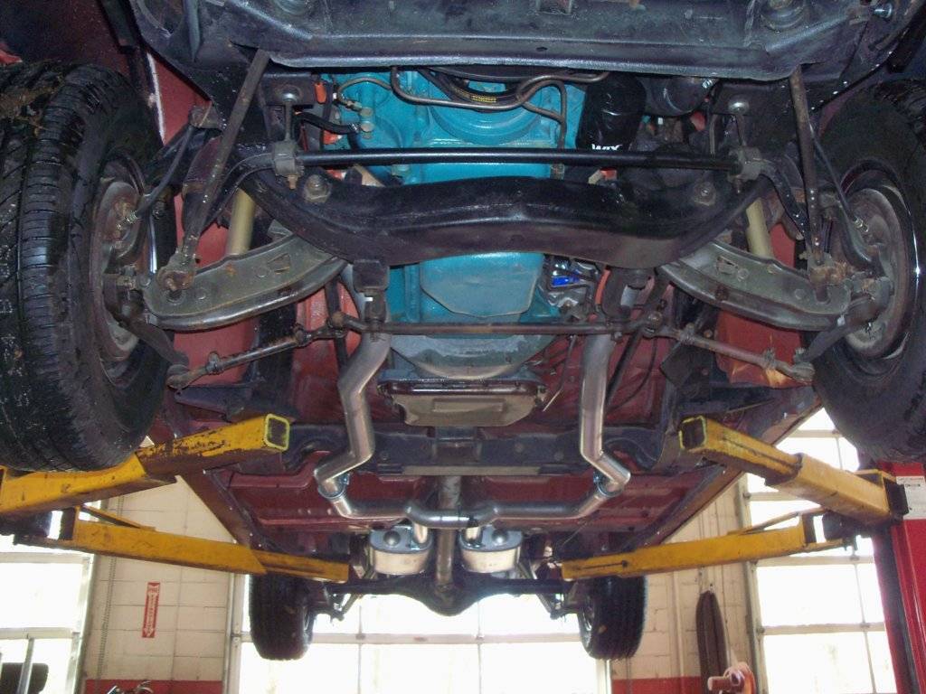

The tti pipes hang directly under the rear frame rail, I've never had any issues myself. The rest of the system fits up under the car nicely.
Depends on what angle you take a picture, yes they are more visible than O.E. because they do run with the frame rail and are larger in diameter than O.E. .
Still a good system that deals with the gas tank offset to one side.
Underneath, everything fits very nicely.

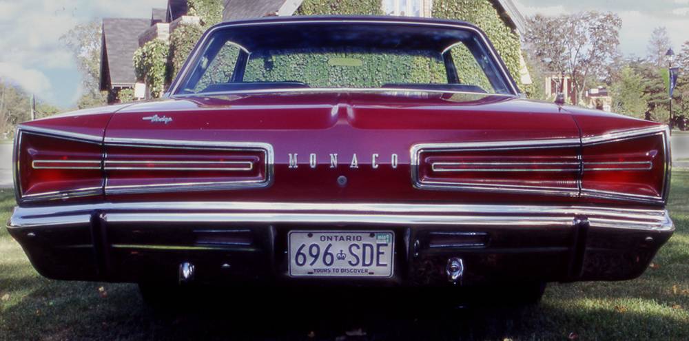

Even the exhaust on my red Monaco had the offset, although the turndowns were cut off so aftermarket tips could be installed. Hard to see the actual tips in this photo, but they're reflected in the bumper itself.

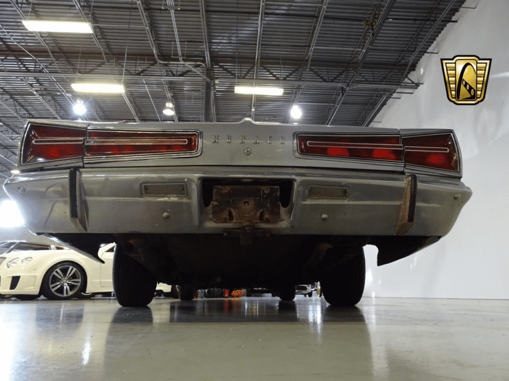

Perfect example how the factree bent the end of tailpipes and how they are routed/ hung on the car

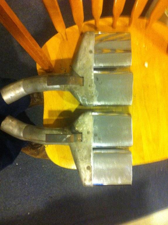

The only C' that had tips--correct me if I am wrong-- 70 SFGT and 70 300Hurst.
Upsweep and baloney sliced turndowns otherwise.
Grace is still wearing her factory tailpipes.
Note they do not extend past the bumper unlike the TTI system.

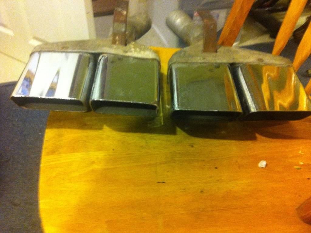

Correct and they both used the same tips. Modified Challenger tips.. I had an NOS years ago but sold them. kinda wish I held on to them now!
Sorry, but I have to disagree with you on the 300 Hurst having those tips.
As I understand it, the prototype Hurst 300 had those tips, but none of the production. This has been discussed on here ad nauseum. Honestly, I thought they had the tips until reading more about them.

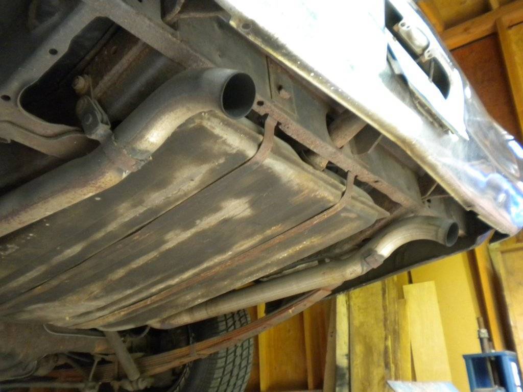

If I remember correct this picture was taken from a survivor 68 Chrysler 300
Those look pretty close to original but I have some doubts. I had 2 '68 Newports with original duals that I replaced the exhausts on. This was quite a few years ago, if I recall I used NAPA pipes which were still stocked back then. The pipes on my cars were a lot rustier than those shown and the Newports I had were very rust free with super clean underbodies. More recently my '67 Fury also had original tailpipes which I had duplicated by a shop as accurately as possible, they were also rustier than shown and it had a flawless rust-free underbody, better than the 300 shown. Second, those do not appear to be original hangers. They look to be tack welded to the pipes and bolted to the bumper brackets which I've never seen. Mine had special left and right hangers that bolt further up on the frame. I even sourced NOS hangers when I did this years ago, they're likely unobtainable now. If anyone's interested I can take a pic.
Here's some good info on page 7 of this thread. 300-H HURST nerd stuff...
Now there are a lot of the Hurst 300 cars out there that have had the tips added, and they do look like they belong there... @Trace 300 Hurst and @Fury Pursuit are pretty knowledgeable guys and might be able to expand on that more.
Maybe you are right as more often than not any or all 300H's I have seen do not have them, but I do remember seeing an Original owner 300H survivor years ago at either Carlisle or Moparfest and it had the tips on it and they looked the part. I have a picture of it somewhere.
I really believe that some were added at the dealerships. The theory is that some new owners, seeing pics of the prototype car with the tips, wanted them too. From what I've read, the prototype had cut outs in the rear pan for the tips.
IMHO they do look at home on the car and if I had a 300 Hurst, I would seriously think about adding them.
