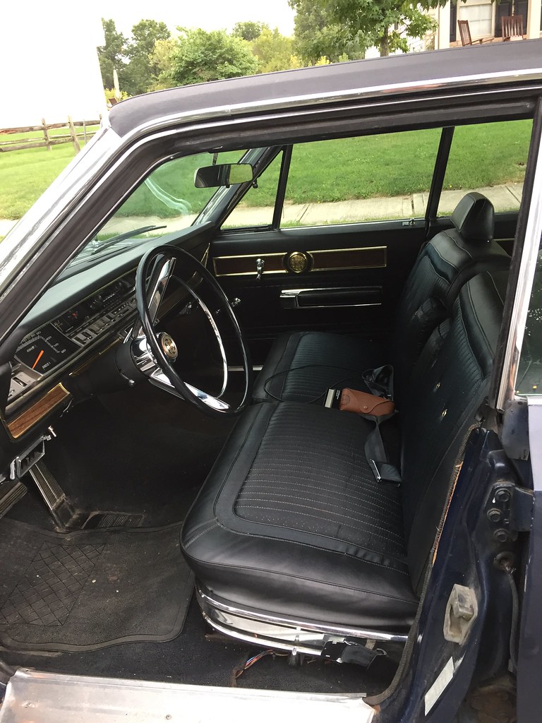

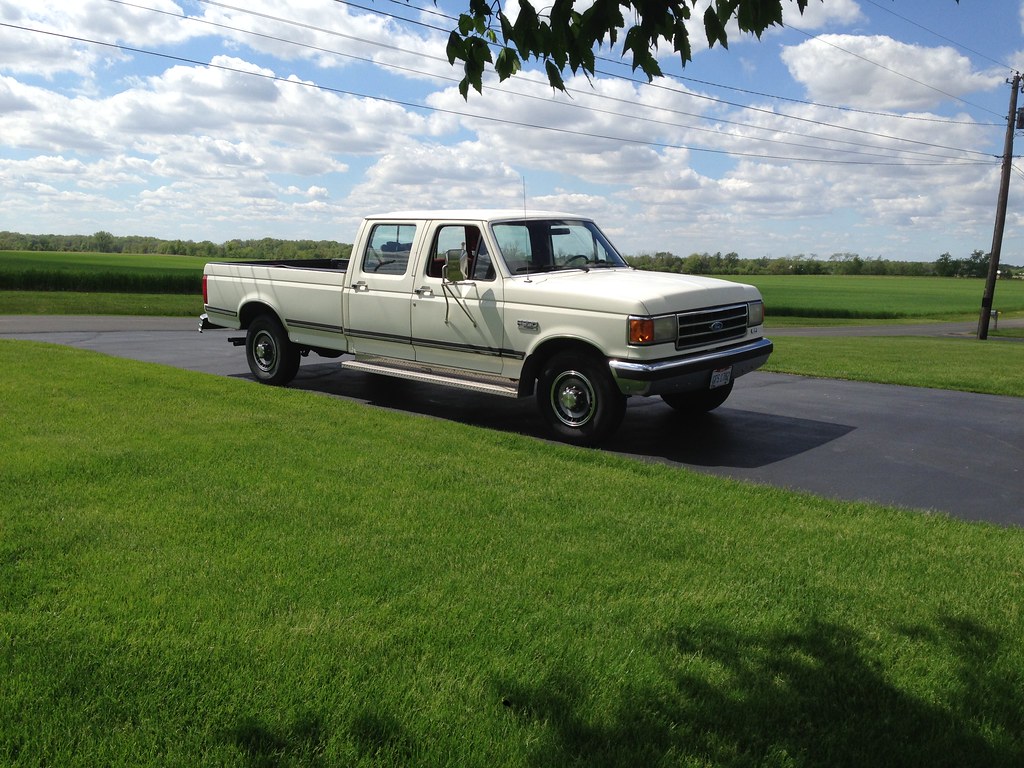

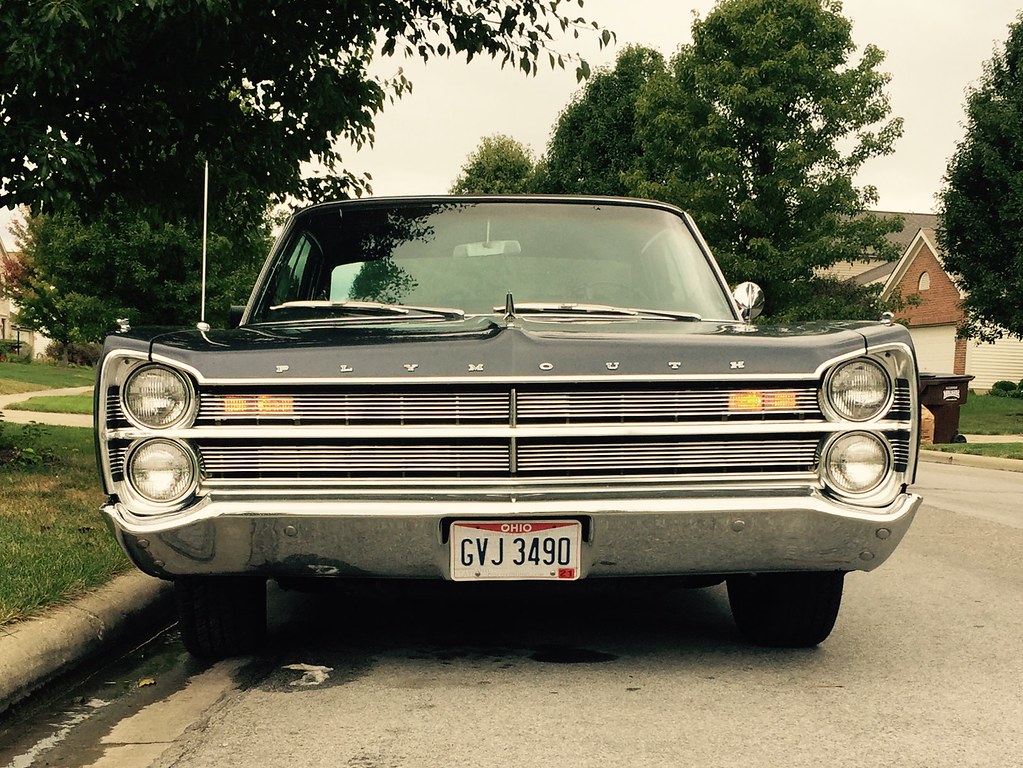

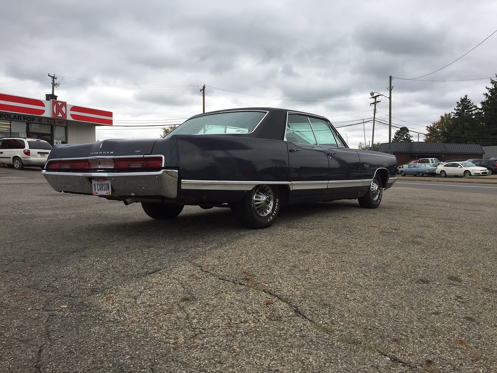

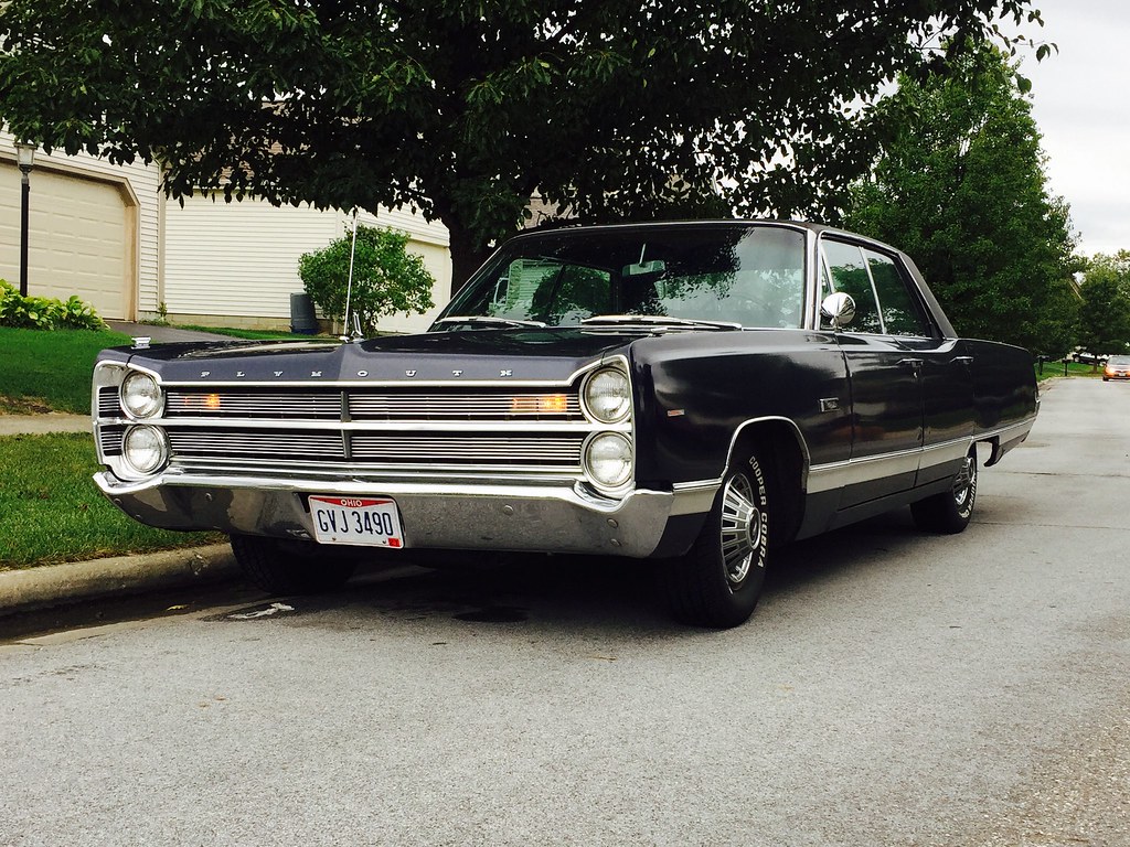

Hey guys, just swapped an old truck I had for a nice driver quality 67 Fury VIP. It's a 383 2bbl car, 727 trans. The 49k on the odo appears to be original and not rolled over. Interior is pristine, exterior is very nice with the exception of some surface spots on the rear quarters and a small hole in the passenger lower fender. Trunk floor is a bit rusty too, but structurally sound. Recent brakes, tuneup, and transmission work. Pretty much everything works although the rear air has been removed and there's a part missing from the original A/C system. I might just remove the rest of it to lessen the parasitic loss. None of my stuff has A/C anyways, lol.

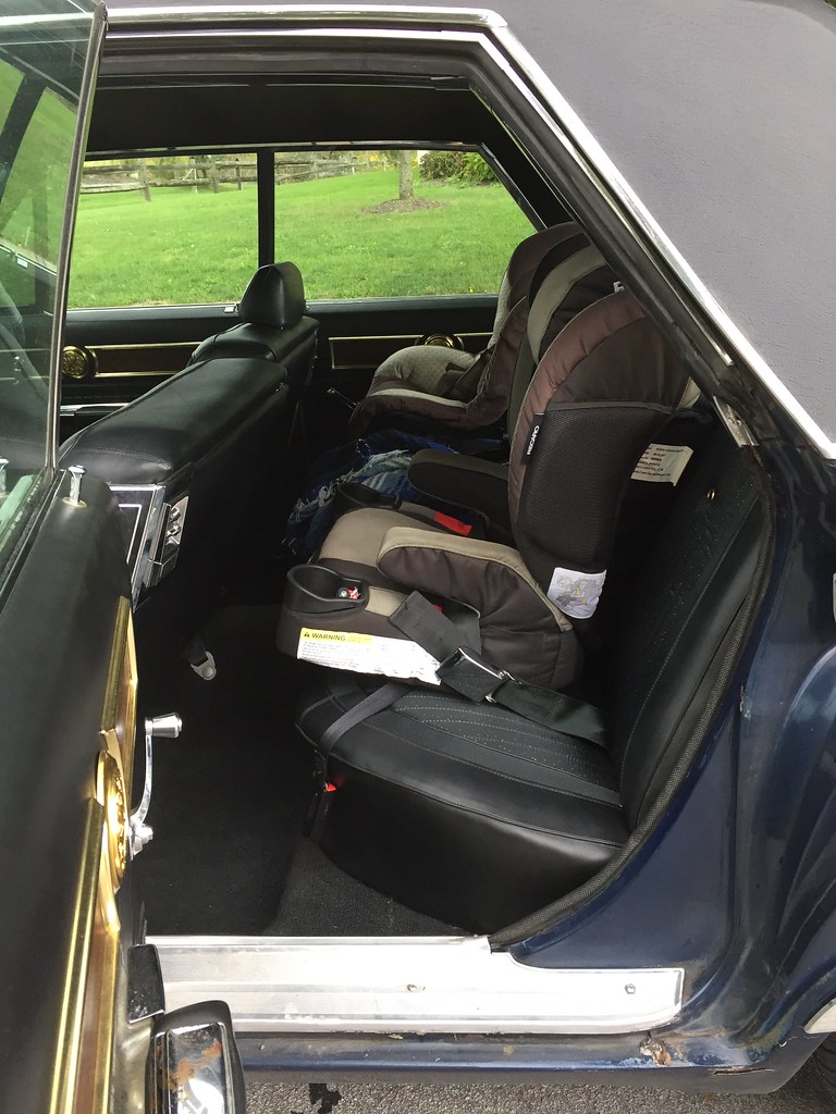

This car is my driver as I work close to home and can throw my two car seats in the back. So far I'm absolutely loving this car. I'm looking to learn as much as I can about my car, as it's the first classic Mopar I've ever owned. I've wanted a B-engine big block car from this era for quite sometime, so I'm really excited to have one. I picked up a factory service manual on eBay so I can wrench on this old girl.

I always thought the VIP models encroached hard on the Chrysler line up for luxury uncommon for a Plymouth. Nice interiors with woodgrain trim and even a headrest option. In your case, it looks like the original owner must have specified one for the passenger but not for the driver. Kind of weird.

Welcome neighbor. Love the car and plenty of room in the rear for the child seats.

Engine stuff is easily changed. A sound body and clean interior is the place to start. And black on black ... very nice VIP.
