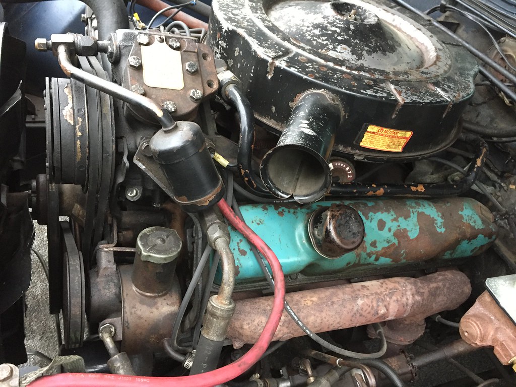

Any other distinguishing features I could look for? Here's some better pics of the front of the engine:
Rest of the engine looks like this pic from Hemmings website:
Mine:
Sure enough on the 400. Looks like they slid the new 400 in under the old valve covers.

Don't sell the 400 short. One of the most easily-built engines, is the 'square' 400. Bore and stroke exactly match, doesn't take high-dollar aftermarket bits to make it go. Also has the advantage of more heat dissipation from the water jackets, since it doesn't have the bore of the 440. If it's what you have, go fer it. Make it your own. i've done several, and outside of total-numbers-matching originality, it looks right and if done properly actually has more potential than a 383.
That's good to know. I was reading up on it and it has strengthening ribs by the freeze plugs that seem to be desirable too. I wouldn't mind throwing a cam, intake, 4bbl, and headers/exhaust on it eventually just to wake it up.
Hell, just a mild factory purple-stick cam, 4-bbl intake and 2-1/2" dual exhaust will get you into 383 range. Wouldn't be a bad idea to freshen the heads, replace the valve seals head gaskets etc. while you're at it, and then you don't have to pull the whole thing apart.
