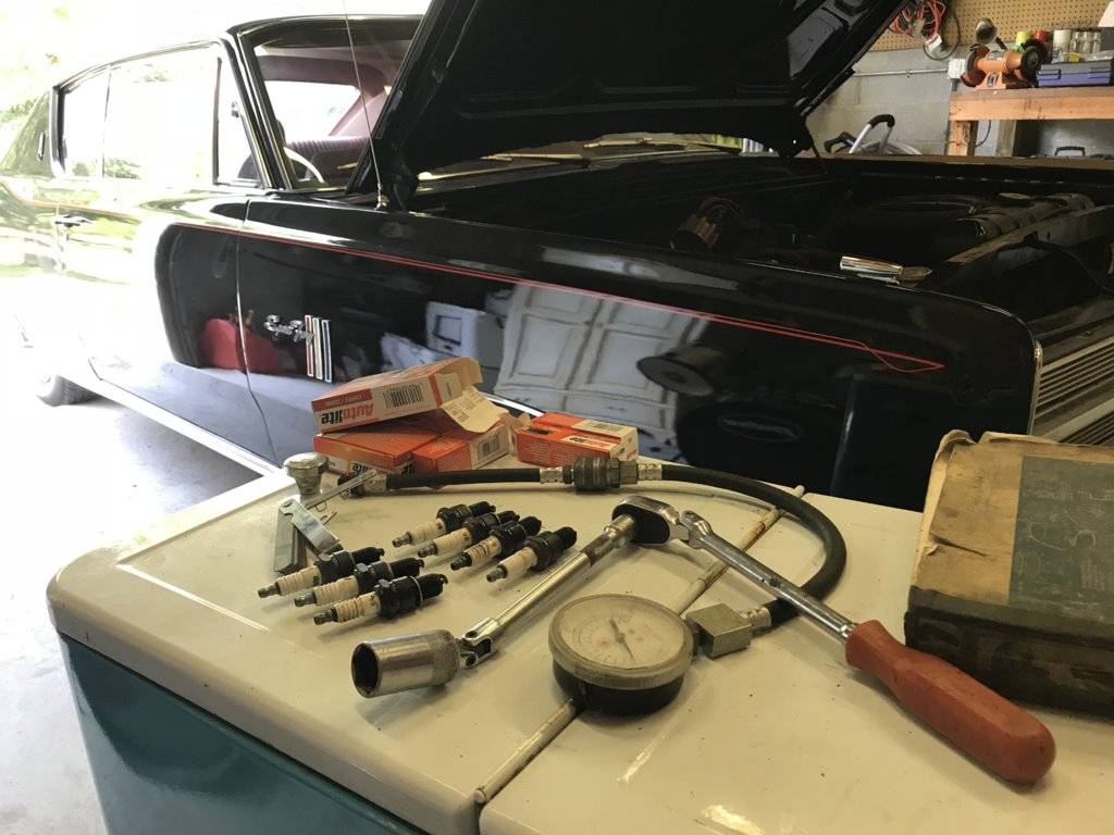

So far since Wed, June 20th (at 7:15 pm...lol), when I received the car off the hauler, this what hs been done.
New plugs, wires, cap, rotor, points installed. This cleared up a lot of the “been sitting hiccups”. Still had a stumble, sometimes it felt like fuel, sometimes spark. So then I cleaned carb and adjusted.
The fuel gauge doesn’t work (for now) so I ran her to he gas station, figured some new fuel would probably help. I also figured it might knock some chucks of varnish out and I’d be calling AAA! Lol. Well, turns out she was 90 percent full of fuel anyway. So I’ll be adding new fuel to the old, then I’ll pull the tank replace sending unit and all rubber back there.
Back to the hiccup: was getting a random stumble. More electrical it felt. So came home. I rechecked the point gap/dwell. Was low, readjust. Oh yeah, when I put the points in it went from running ok to not running. I was like “WTF”?! For whatever reason I just couldn’t seem to get it right. It had been since 2004 ish since I’d messed with points. After some patience I got it. Lol
Anyway, adjusted dwell, and re-replaced the car. It had some tracking on the new one it looked like. I ran her for a bit and still had a stumble. Under cruising and load, once good and heat soaked. Came back, tested the coil. They don’t go bad often, not really, but hey I was running low on crap to test. Lol. Could OHMS were out of spec, and fluctuated when cool was shook. So, MSD coil went in.
OK. MSD coil with points needs a ballast. and not just to 1. Ohms that’s on the car factory. Nope. It needs a .8 ohm added. Well, go ahead and go buy one...I couldn’t! MSD makes one, but local had to order it. And I had a car show to attend Sunday (or so I thought). It was 11 am Saturday. Could off, all wiring ran for additional ballast so it looked factory...no ballast available.
So, I stopped and thought “Napa sells a 1.83 ohm ballast. No reason I can just swap factory ballast for 1.8 one! So I did.
Couldn’t find out if there was any reason not to, anywhere. As if I was the first to think it...ha! Well, you can. So there is a tip!

So anyway, those things, and of course setting and playing with timing, and she’s running good.
Checked all suspension, joints, steering and brakes. All new brakes are there already but probably replace anyway. Maybe go disk eventually.
Trans shifts great. Clean. Adjust ed torsion bars/ride height. I was 1/2 inch off on the front?! So I brought it down to 25in at top of the front wheel well. Might need bars replaced.
