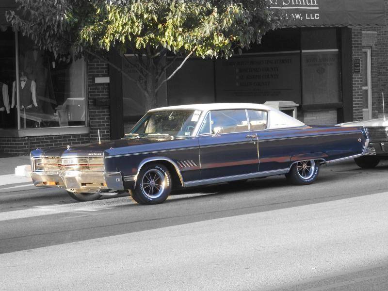

Thought I would post a pic of my car with the new Hurst Dazzler wheels
pic is from James Dean Fest last year.

I got these 15x7 wheels from tirerack with 235/70r15 tires. I also tried a 17x8 wheel w/ a 235/55r17 which fit nicely but the depth of the front lip was deeper on the 15.
Very nice wheels, they look great on that car.
Thanks to everyone for your compliments. Now it's off to the exhaust shop.

whats the back spacing on the rear wheels?
All four wheels are 15x7" with a zero offset and 4" back spacing.
When I tried the 17x8" they were also zero offset but 4.5" backspacing and worked equally well. I have a pic of the 17 I'll try to post later.
